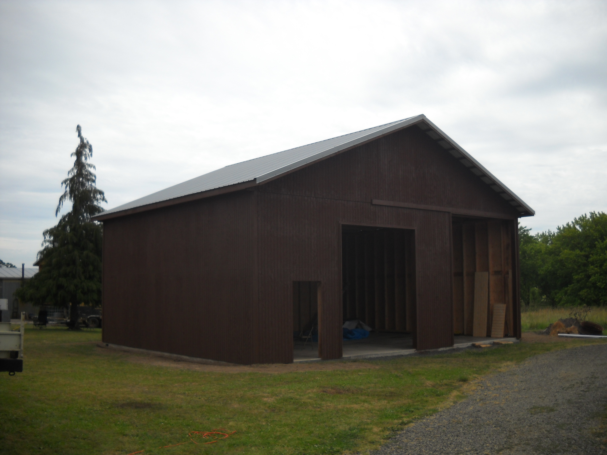

We finished the shop today. Put on the metal which was delayed and got it all up within 4 hours. :thumbsup: Looks sweet now, we even painted it. :thumbsup:

The shop looks great JD! You guys win. :D

Patience young grasshopper!;)
Although Johndeere3720's is looking pretty good. The holes you have in the ground are by far pretty nice.:thumbsup:
The doors look like they're for daddy bear, mama bear, and baby bear.
