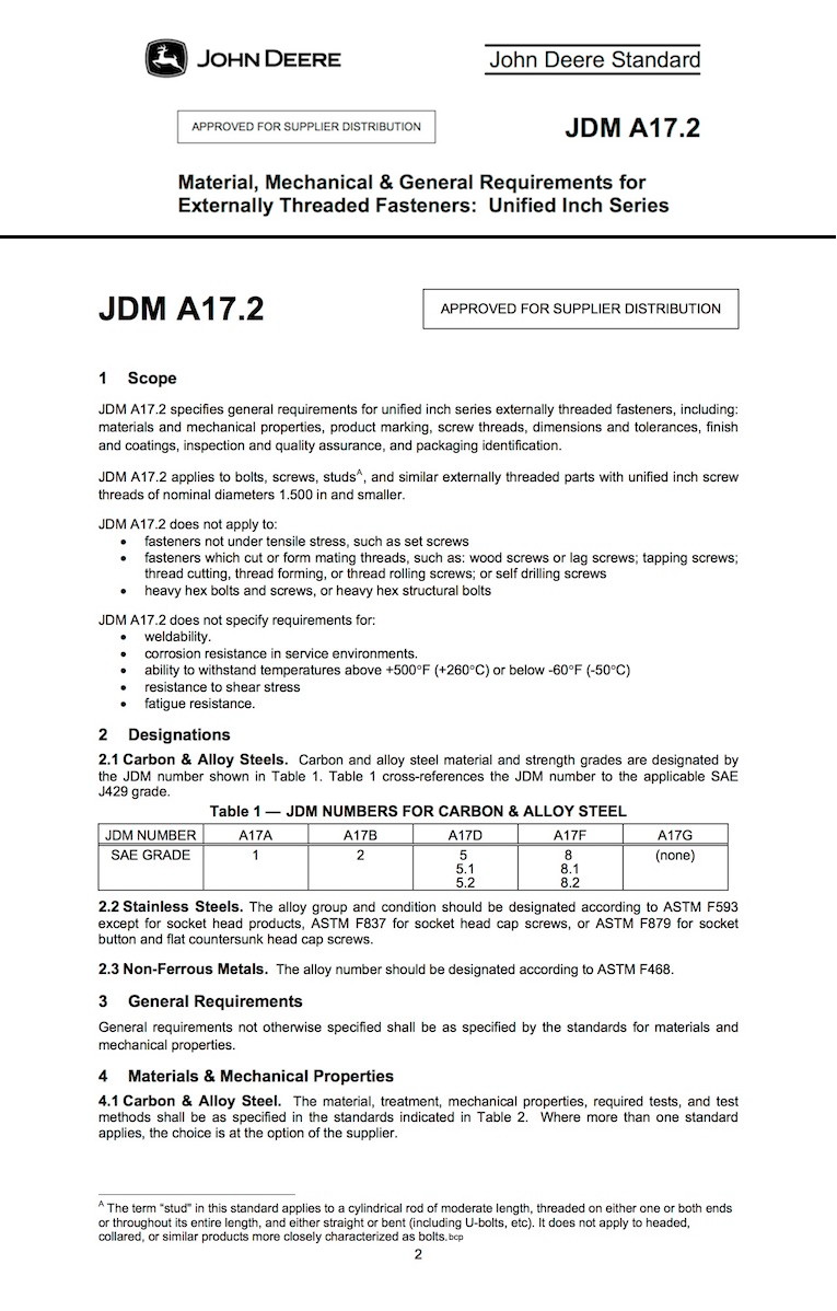

Deere bolt specs :
Bruce
PS: added heading
   / New problem tighten bolts
#19
What does JDM stand for? and, ASTM?
I always thought SAE was the standard.
   / New problem tighten bolts #20
JDM is a John Deere standard.
Bruce
