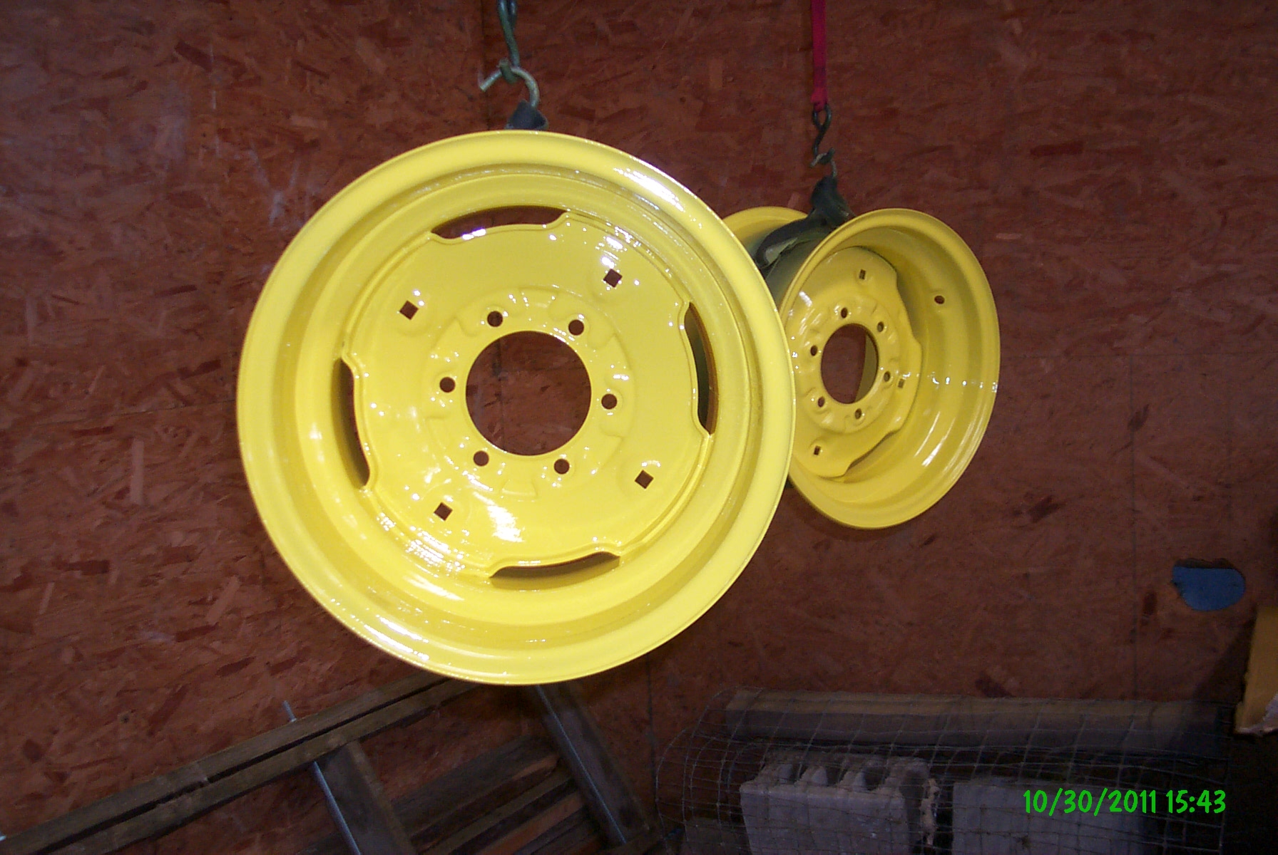

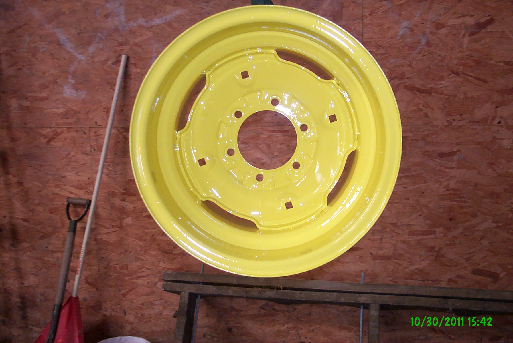

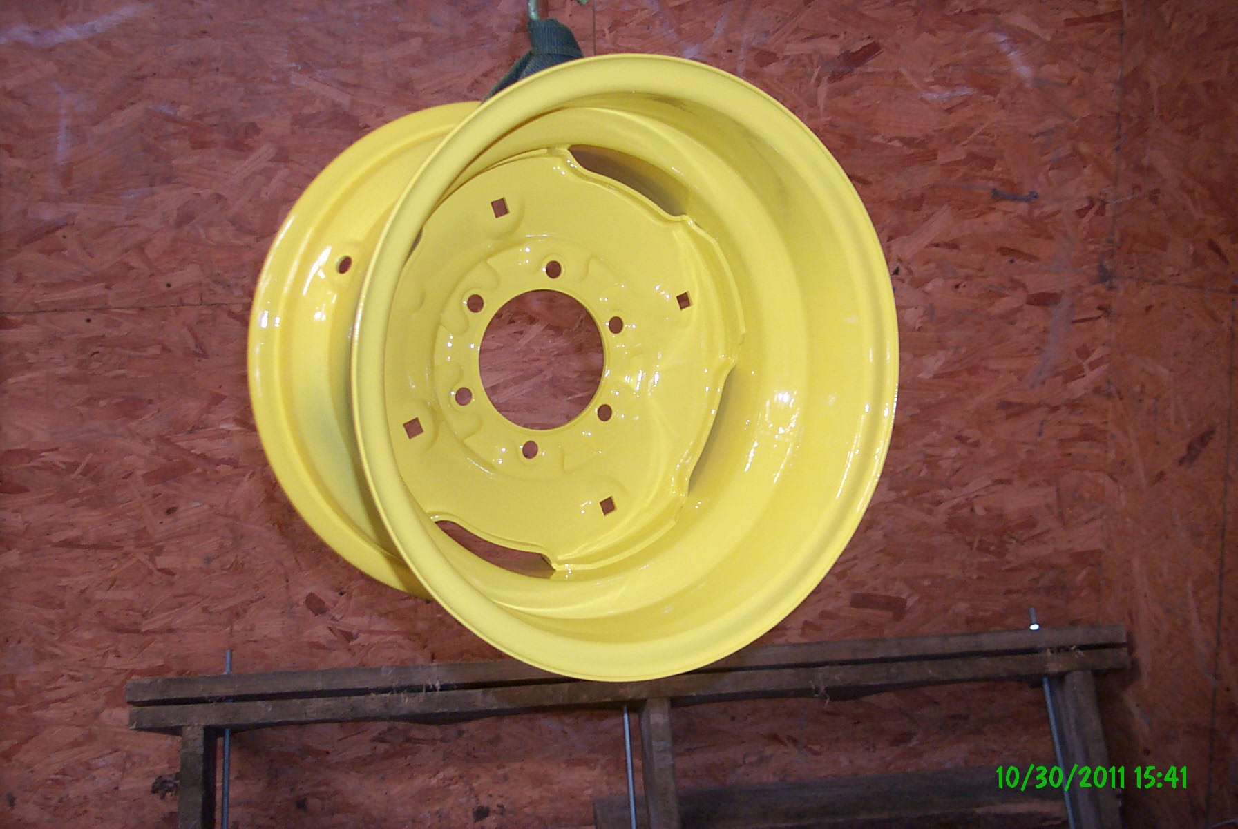

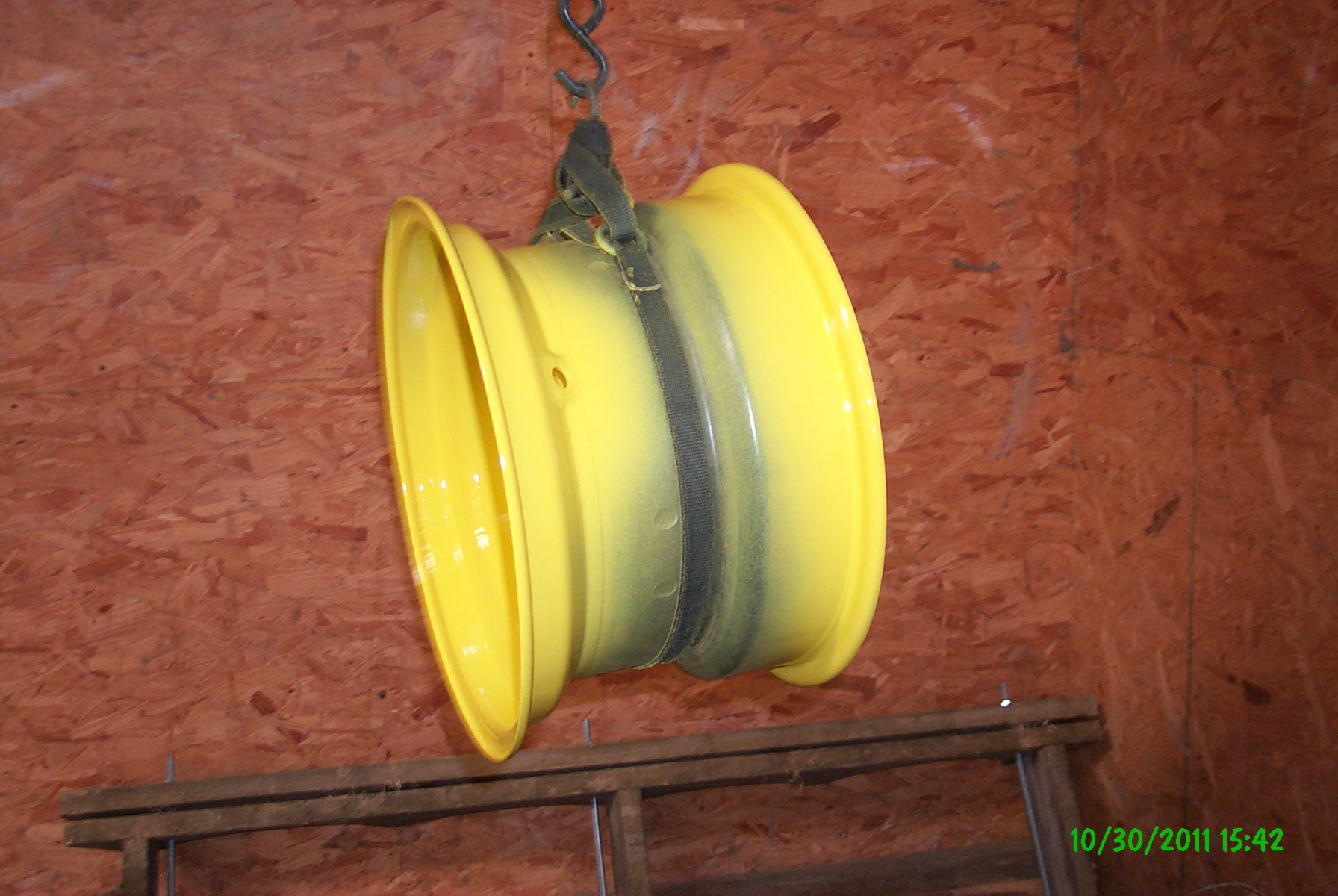

Wheels are painted. I was very happy with the Van Sickle paint... very easy to shoot. I just followed the directions... Mix in the hardner (8:1 ratio of paint to hardner) and let it sweat in for 15 minutes. Then reduce with VM&P naptha (8:1 ratio of paint to reducer). Pour it in the paint cup on the spray gun and spray away. It sprayed very easily and covered very well.
I will say that wheels are not the easiest thing to spray... with the deep dish and all the little nooks and crannies, it was a bit of a challenge. I decided to hang the wheels so I could paint both sides at the same time.
EDIT: I just went out and checked on the wheels. They are dry to the touch in just 3 hours after spraying. That surprised me since it's kind of chilly here... about 60° for a high today... and usually, paint takes a while longer to dry at those temps. This is my first time spraying enamel with hardner. Did a little more reading and found out that the catalyst/hardner is actually a urathane additive. I guess that would make it a urathane-enamel paint.
Since it is kind of cool, I think I will give the paint a couple of days to thoroughly cure before I take the wheels in to have the tires mounted.
