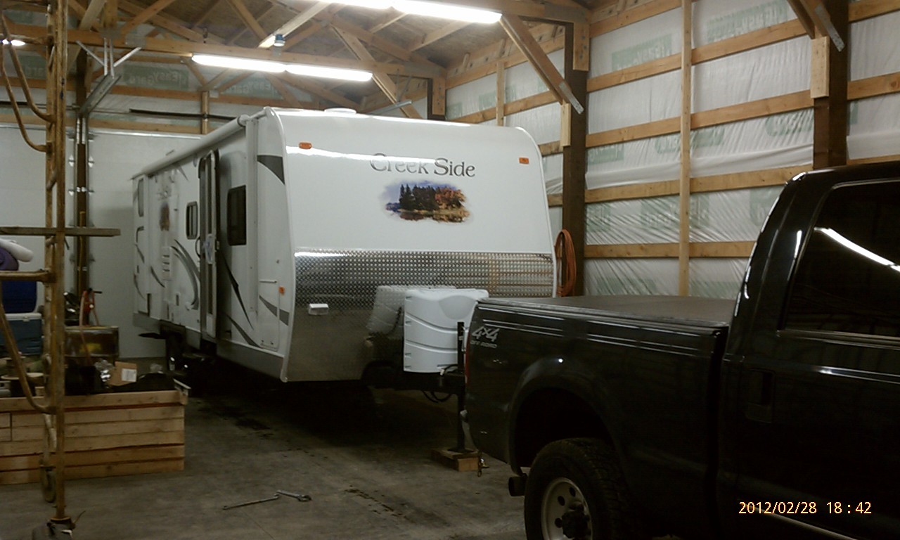

So I haul RV trailers and my PJ 10k rated equipment trailer but not at the same time. In the past the ball height was very similar for both of these trailers and I used the same WDH setup on them. I replaced the RV with a modern one which is much much taller. The ball height is way at the top of the grave digger drop shank. This is unacceptable for my equipment trailer and I am now looking at buying a seperate WDH setup for 300$ for the equipment trailer. I will NOT be raising and lowering the ball height on my current WDH setup each time I want to tow.
Even on a big honking diesel F350 the factory receiver is not rated to tow the equipment trailer without a WDH system. I believe the weight carrying hitch max was only 500# tongue weight.
So I discovered that it is actually cheaper to replace the Ford receiver with a class 4 or 5 receiver rated for a 1000 lb tongue and 10,000 lb trailer without a WDH and then buy a hitch and ball that can also be found rated for 10,000#. This will mean that my receiver is more substantial for RV duties, and also it will be easier to hitch up the equipment trailer.
What is the boards opinion on upgrading the factory receiver instead of buying a second WDH setup?
Something ODD about that picture.
To need the ball that high on that shank kinda suggests to me that the truck SQUATS a LOT - - either because it is weak and wimpy in the rear springs, or because you load it.
Is that your "big honking diesel" ?
If so - they're not, at least the SRW ones aren't.
Anyway, if truck squat is your REAL problem the solution may be to get your Springs repaired, or add air springs, which soften the ride considerably even when running empty.
They also help compensate for loaded/not-loaded headlight aim.

New trailers, especially this one, are tall. The trailer is sitting in my shop all leveled and if I walk into the ball mount it will hit me in the groin. They are really really tall. Getting out of the trailer takes a three step folding staircase and then a fourth full step before you hit the ground. This is a brand new 2012 Outdoor RV trailer made in Oregon by the same company that makes Artic Fox trailers and Nash. My last trailer was a nash and was much lower. Overall height is still under 12' but ground clearance is excellent.
The F350 has been lowered to F250 height by changing the blocks under the leaf springs. All springs and overloads are still F350 OEM. This dropped the hitch just over 2". The trailer's full tongue weight drops the rear bumper 3" and then when I set the WDH the bumper regains one of those inches for a total drop of 2" and just barely touching the overloads. It actually rides very nicely and level as set up. That crazy shank was 100$!
So the problem, Reg, is that the trailer ball mount is tall. Truck is fine. Trailer has max GVWR of 8200 so we're not talking a huge trailer. In fact, many folks report towing this size of trailer with half ton trucks.

Perhaps a picture will help.
