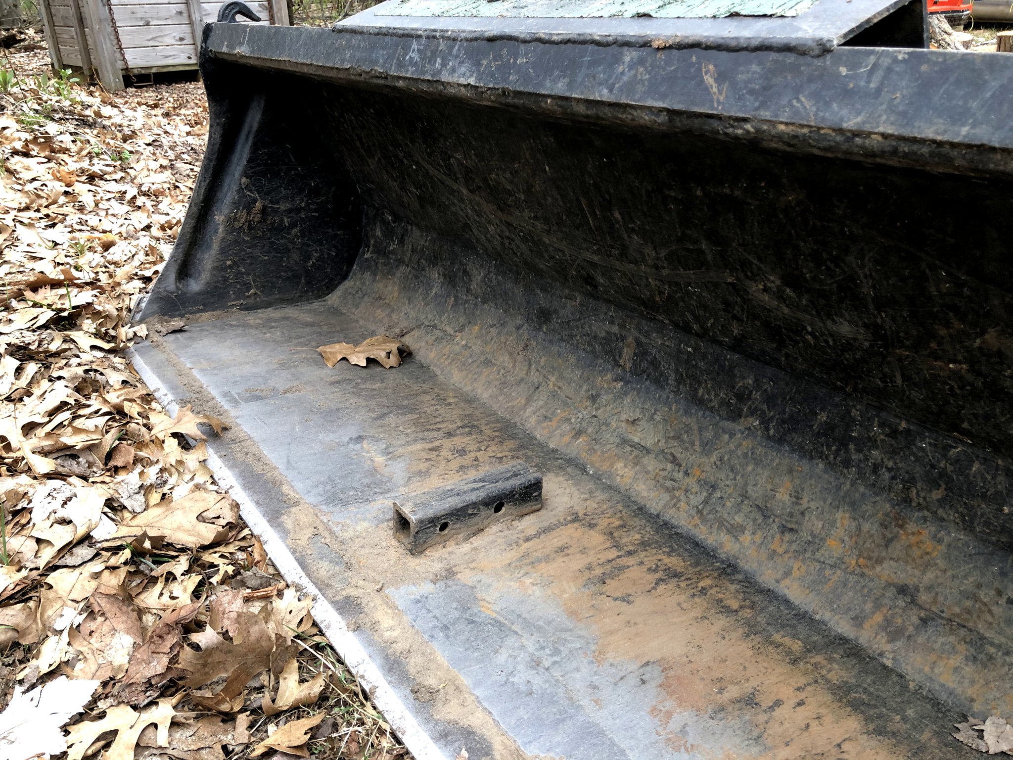

Welded a 2 inch receiver into the bucket so I could retrieve my trailer that has been languishing in a muddy spot off my tractor trail. I could reach it with the bucket with the tractor mostly on the dryish trail.

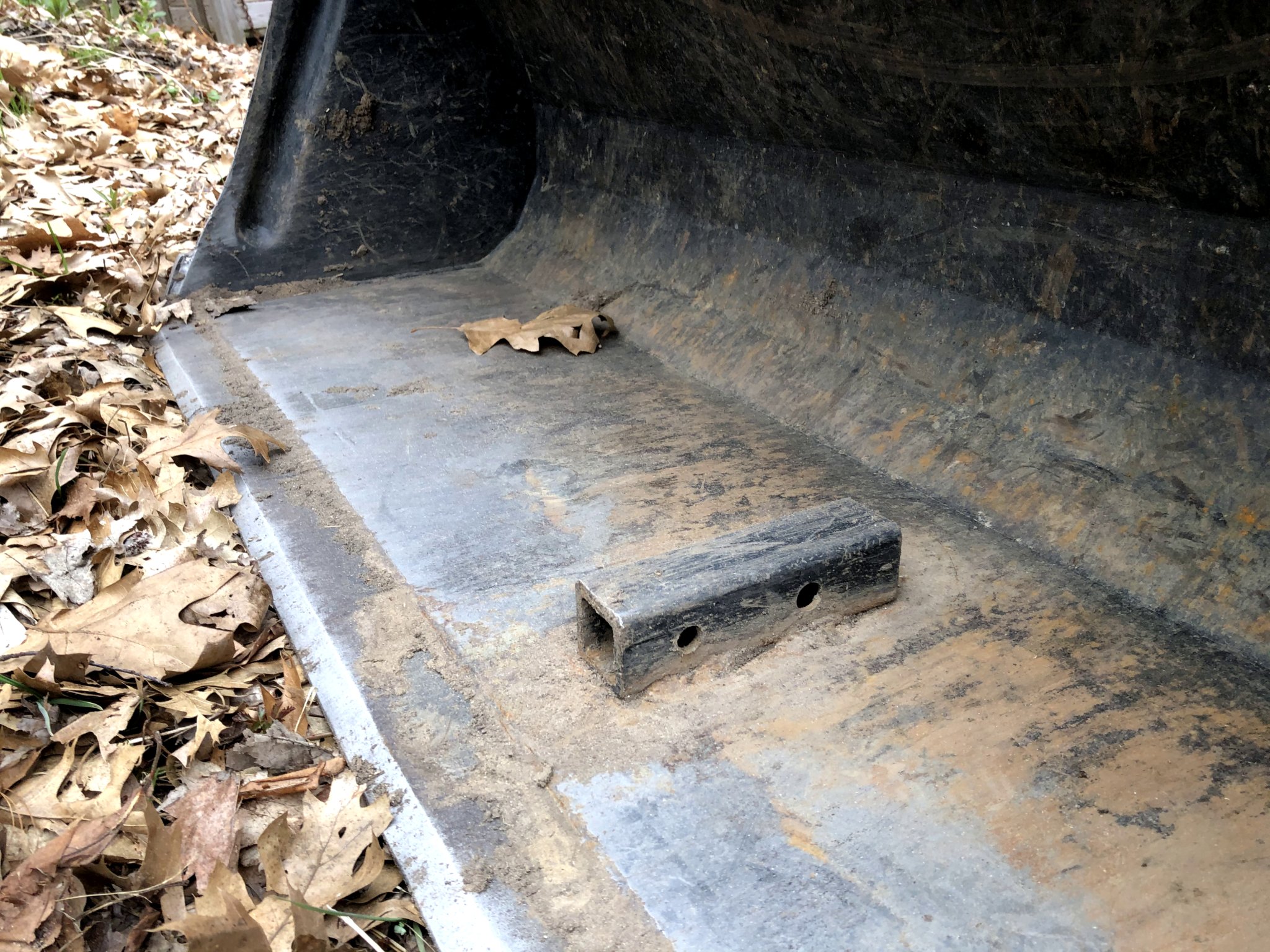

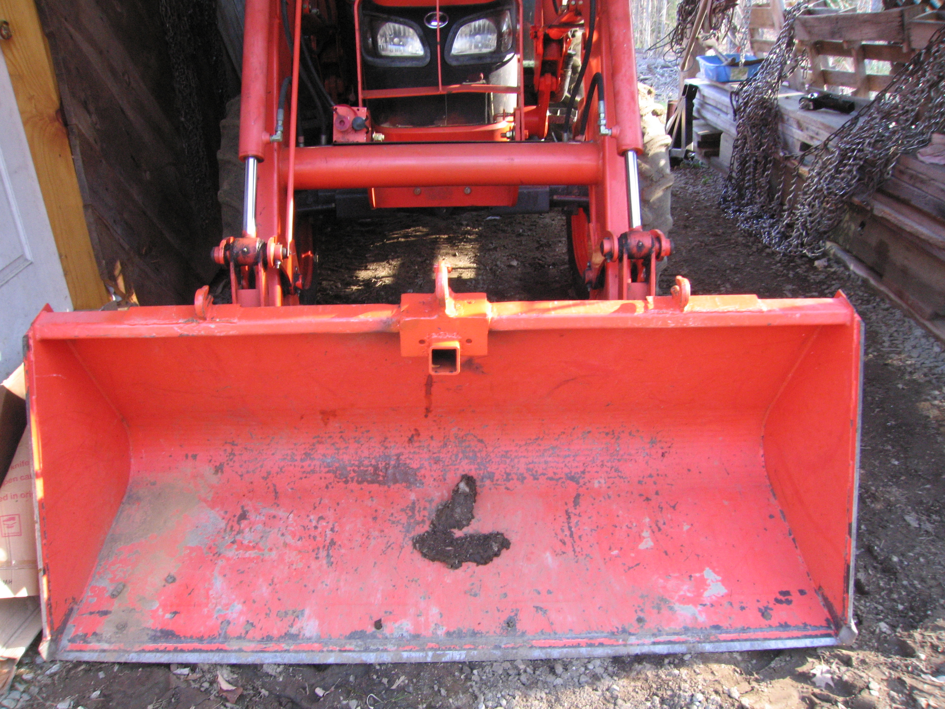

I welded the smaller (1.25" ) receiver tube on the bottom of the bucket. Works great for moving trailers and putting boats in the water. It is a little hard to hook up by yourself but you get used to it.

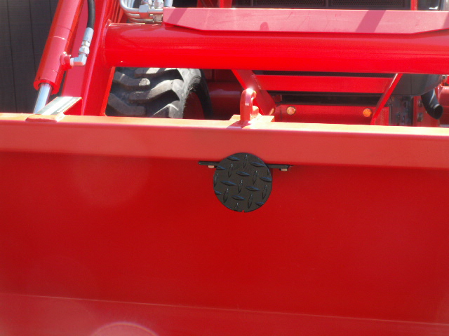

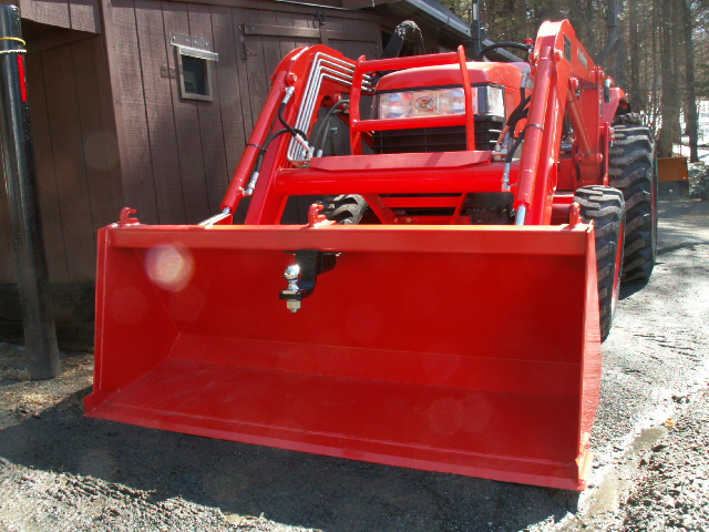

I didn't weld mine just bolted and works great when moving trailer in tight spots. :thumbsup:
You can see that ball from the tractor seat?
Does not appear so in your picture.
/ New receiver #11
No...that the only hiccup about.

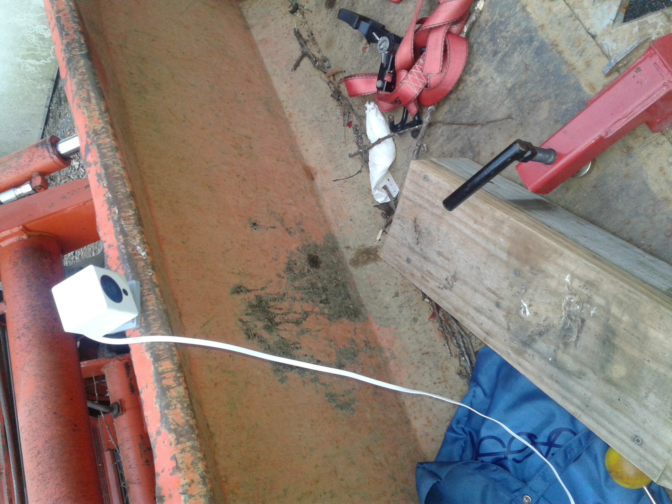

Yep, same here. Too high to be very useful. I ended up buying on that clamps onto the lower lip of the bucket and that does the trick.
:thumbsup::thumbsup::thumbsup:
View attachment 652703 View attachment 652704
With the clamp on I use a $20 Wyze wireless camera, the wire shown is hooked to one of those small phone chargers.
Makes it REAL easy to hook up.
