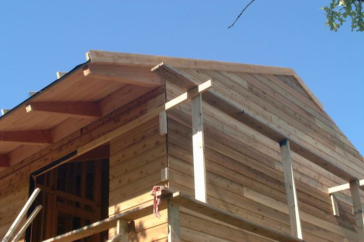

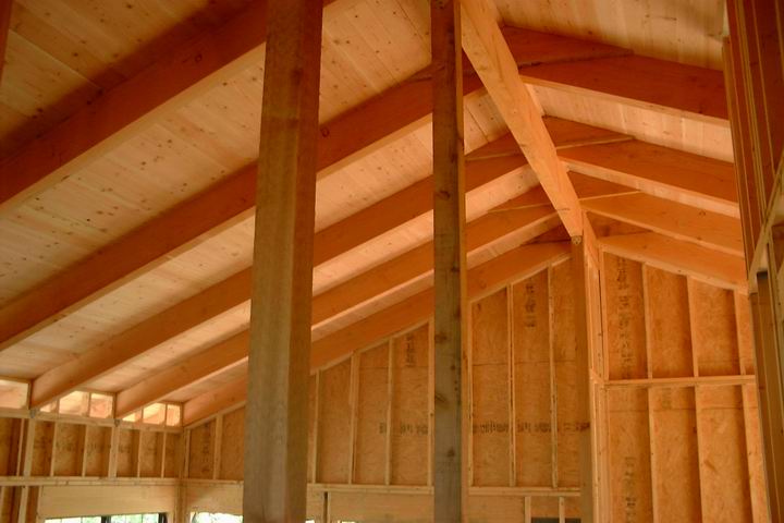

Tom, I've been reading this thread with interest, because you are planning on doing almost the exact construction that I have on my roof. My house has no attic and is a loft ceiling (even in the closets). I'm not going to agree or disagree with the advice you have been given, but rather, I'm just going to show you how my roof was done. The first picture is of the inside of my house showing the 2x6 tongue and groove layed down over 4 x 10 beams on 4' centers.

This next picture shows the eaves and the ribs (purlins) on top, but from this angle it is deceiving. The ribs only extend a short way up the roof.
