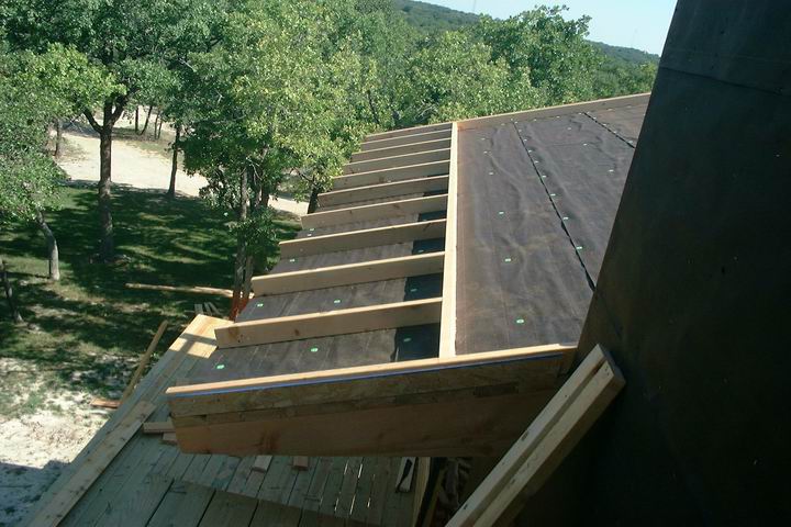

Looking down on the roof, you can see the 2x4 ribs are just on top of the eaves. Directly on top of the 2x6s is a layer of felt. and no structure whatsoever.

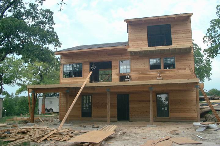

To fill that void, 4'x8' sections of foam insulation were just layed in with no structure whatsoever. After the foam was layed in the entire area was covered with OSB and secured down with 5" screws through the foam and into the 2x6 tongue and groove. Finally, this was covered by another layer of felt and then the metal roof was installed. You can see how it looks just before the metal was installed.

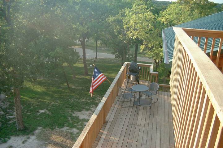

I had my choice of R-panel, U-panel, CF (concealed fastener), and AP Panels. Because I wanted the most strength, I chose U-panels. Here is a picture where you can see the roof after the metal and gutters were installed.
I recommend you check with your insurance agent before doing your metal roof. My insurance company required a certification of 26 ga. and the source of the metal used. As a result, my insurance is probably reduced by 25%, but that may vary in your area. You just want to make sure you know all the requirements before you do your roof. You don't want to find out after it's finished that you missed something and your insurance won't give you credit for your roof.
The only sealing done on my insulation was tape on the joints between the 4x8 foam sections. The weather is pretty mild here in Texas and my winter electric bills are less than $150 per month. The house stays nice and warm, but even at that, there are improvements that could be made.
...and yes, I do continue to find places that wasps and lady bugs can find and get into my house from time to time. In a couple more years, I figure I will have used another bushel of silicone seal and have all the bug intrusions stopped. /forums/images/graemlins/smile.gif

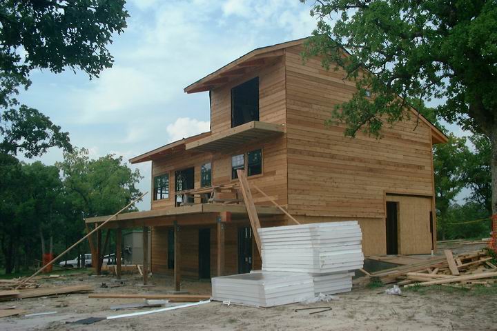

Oops! I forgot to show a photo of the foam. Here's a stack of it. It has reflective aluminum on both sides.

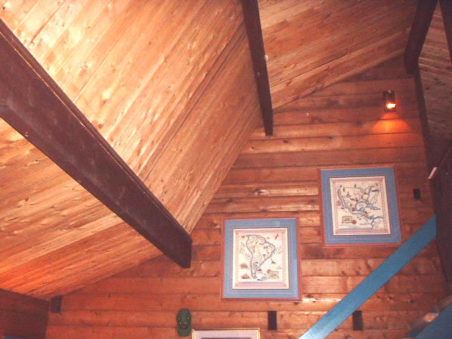

Jinman,
Thanks for these posts! Yeah what you have is very similar to what I have in mind. I am surprised that the foam insulation blocks are stiff enough that you can put your roofing right on top of it with no other support, using 5" screws. I hadn't even considered that. If that's the case, it greatly reduces the complexity of the insulation frame. What kind of screw is it that you use? Is there something like a deck screw that long that will screw in without a pilot hole? The other nice thing about that construction is that you get fewer gaps to worry about, one insulation block runs right up against another in a tight fill.
Very nice. I need to research local sources of materials, now that I know some things to look for.

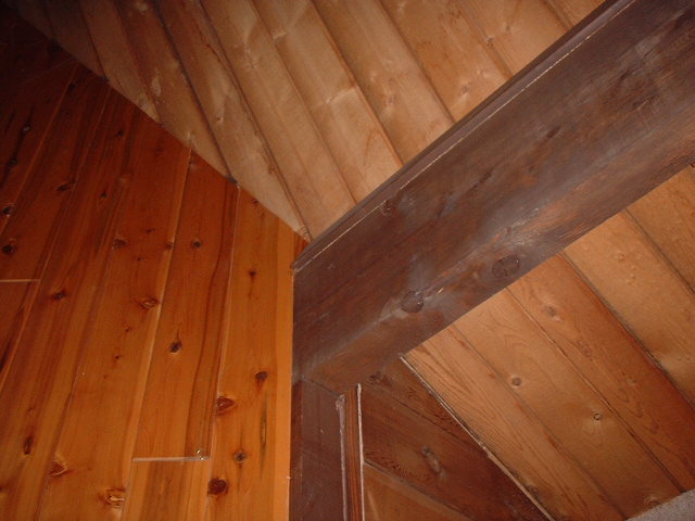

I've attached a single picture of my interior celing here where one of the lower beams joins two different roof pitches. With some daylight I can take some pictures of the roof edges and wall construction too.
Again, thanks very much for the postings. /forums/images/graemlins/smirk.gif

A couple of structural detail pics:
The ceiling from the inside (aka the underside of the roof /forums/images/graemlins/smirk.gif)

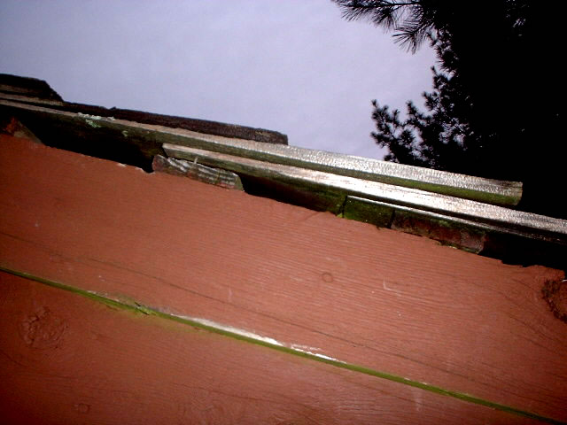

And on top of that is just this, the "perlins" (?) and shingles. Can't see it in this shot, but right behind that facia board is the T&G ceiling boards from the last shot, right underneath the perlins. /forums/images/graemlins/smirk.gif

   / New roof on a cedar home... Some questions? #40
Tom,
I see now what I was missing, and now it all makes sense.
You have several options on the design. I'm a big fan of keeping things simple, inexpensive and perminant.
After you strip off your shingls and 1X4, I'd install 2X6 rafters in place, one at a time. Use standard pine, nothing special. The facia should be something that will resist rot. You mentioned cedar or PT earlier. You can also use hardiboard, wich would be the very best in my opinion. There is no need or reason to block the rafters.
Spacing is going to be based on what you decide to use for insulation. Jim showed you some pictures of solid foam that would probably be what your looking for. I'd use fiberglass and put the rafters 24" OC.
After the insulation is in, you install your perlins. 1X4's work fine and can be spacee 48" OC.
This is were Chris suggests using the felt paper. You don't have a smooth surface for it over the perlins, so I'm not sure how well it will work. If you really want to use felt, then to do it right, you'd need sheathing. Installing this will probably be the hardest part of the job. Getting those sheets up there is a royal pain, it's extremely expensive and it doesn't do anything for a metal roof. It's your call.
If you do install sheathing, you might want to install shingles again. There are allot of different styles in composit ones that are very attractive. Shop around and do some searches online. It's a good idea to compare all your options.
If your still going to install a metal roof. I'd skip the felt and install the metal directly onto the perlins.
What is your timeframe? I'm just starting the dirtwork on a workshop I'll be starting on in a few months. I'll be posting pictures on it, which should clarify the basics of a metal roof.
Eddie
