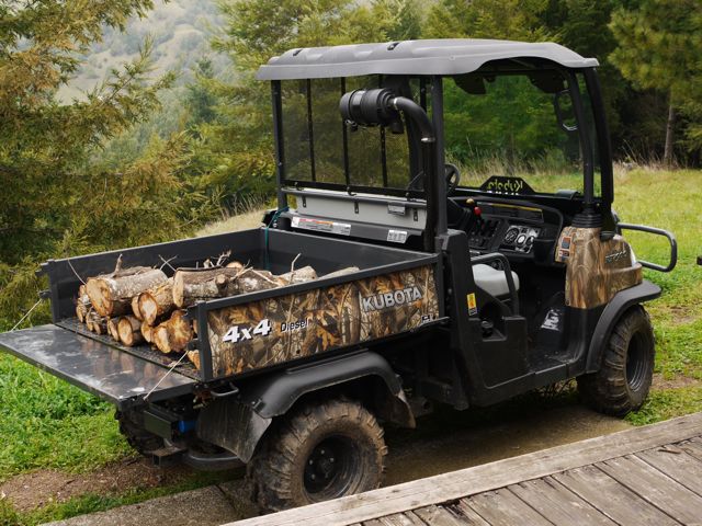

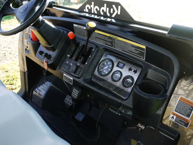

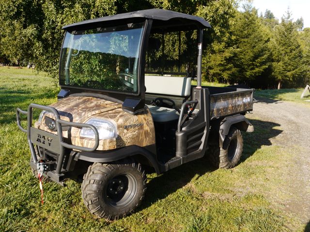

Picked it up from the dealer about 2 weeks ago- it's great!

As far as the unloading valve yes there is one tied to the brake and some early 1100s had the pull knob on the dash also that works faster, I wonder if adjusting the cable on the one on the brake will make it dump quicker.
