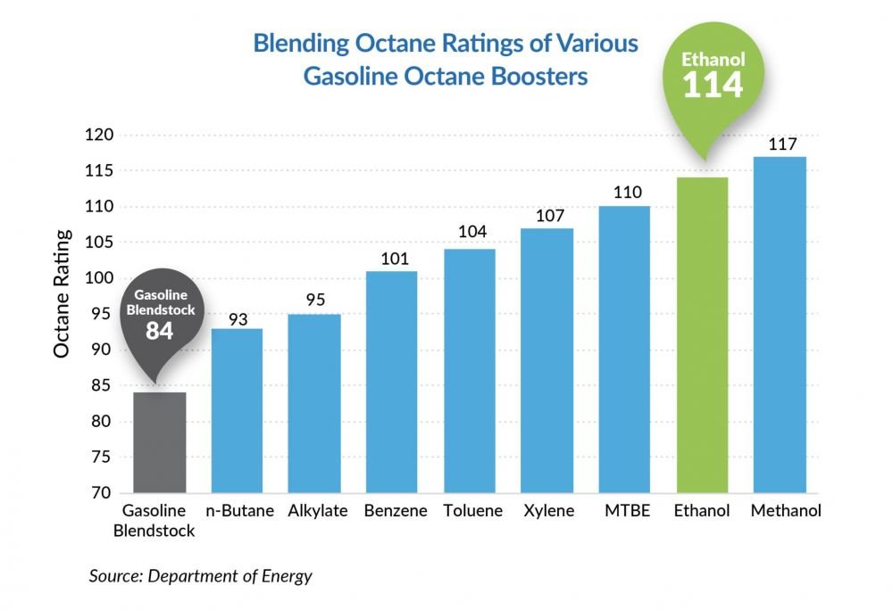

Ethanol is nothing more than an Octane Booster.
