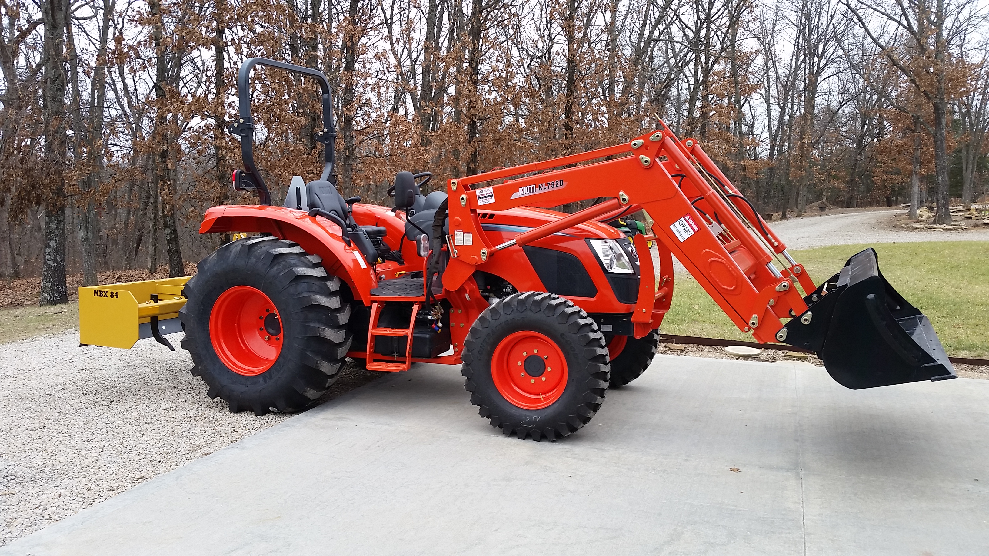

Rolled it off the truck yesterday. Big excitement around the homestead. This rig will be replacing a Bobcat branded DK50SE gear jammer which was a great little unit for 6 years and 1000 hours. This unit with an extra set of rear remotes, an 84" Rhino boxblade, a set of service manuals, filters for the first service and rear tires filled with Rimguard was right at 35K. Dealer was MoKan Outdoor Power and equipment and so far they have been the bomb. Very accommodating and helpful.

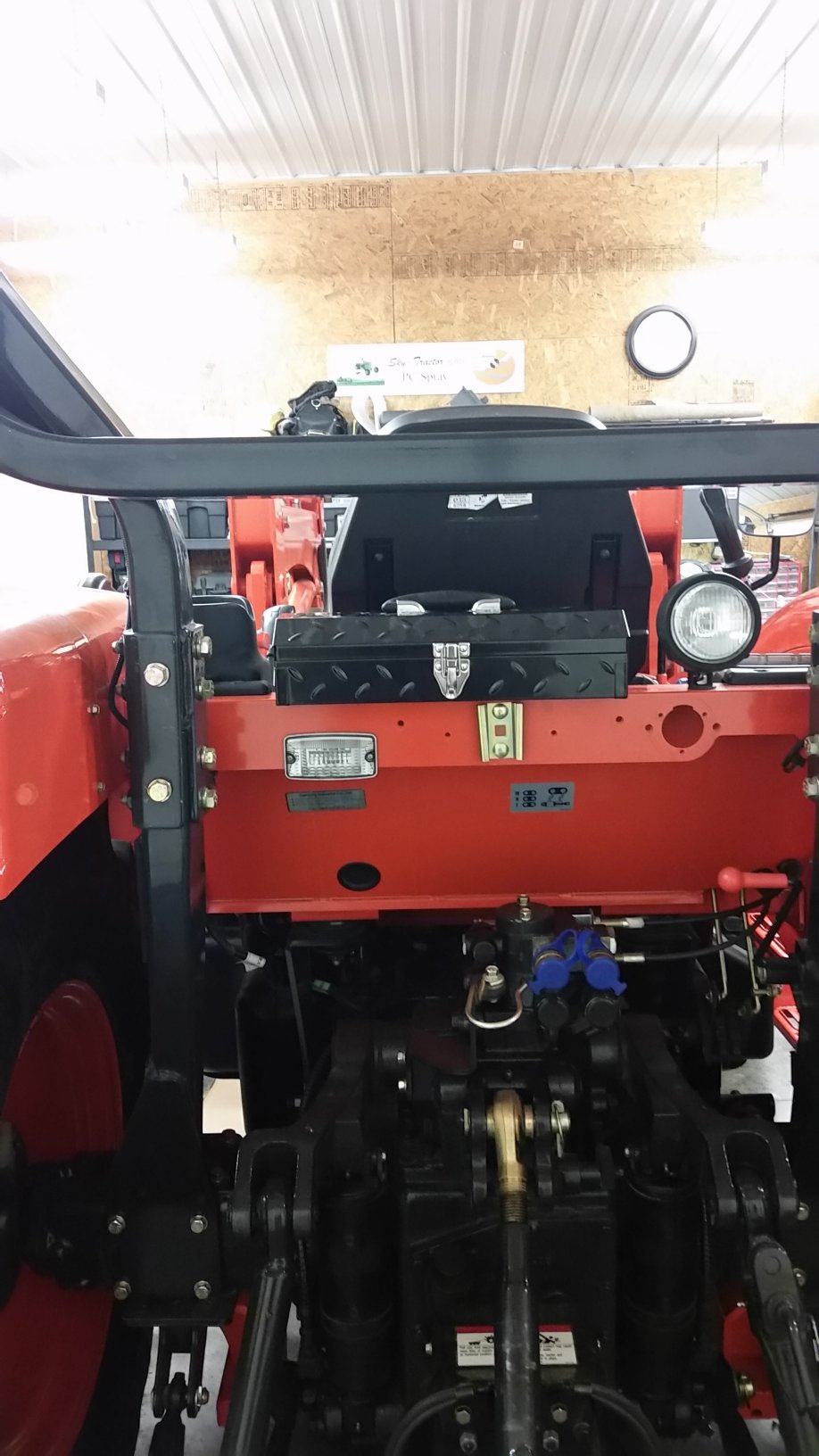

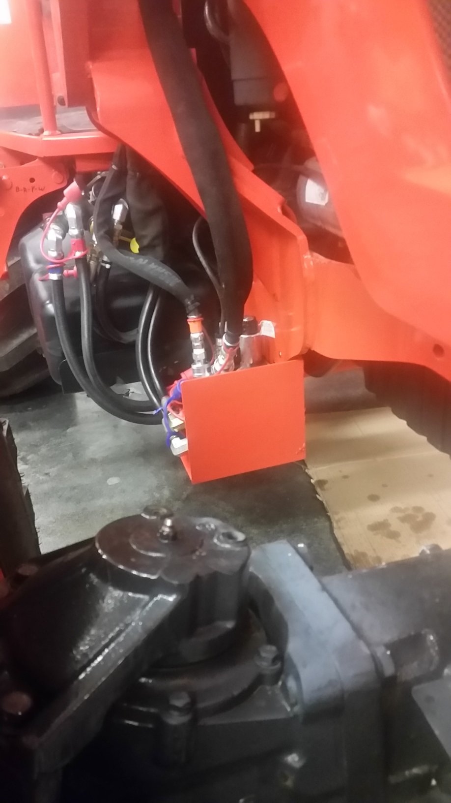

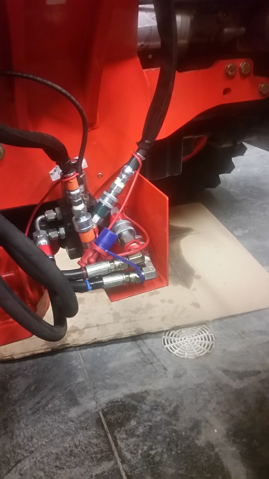

Very first stop was to roll it into the shop and install a Michigan Iron 3rd function kit. The kit is well thought out, only had a few wrinkles. The hole in the handle for the joystick was way too small. I had to stick it on the lathe and bore it to .640. Closest fractional equivalent is 41/64ths so that wouldn't be very handy if you were trying to do it in the average garage. The head of the bolt that fastens the valve to the bracket interfered and required drilling a hole through the loader frame. The position of the valve is pretty exposed so I'll have to dream up some kind of skid plate for protection. All in all a pretty nice kit though. All of the hoses were dead nuts.
I have high hopes for this tractor based on my previous experience with the brand and looking forward to tackling some work that the 50 hp tractor wasn't quite up to.

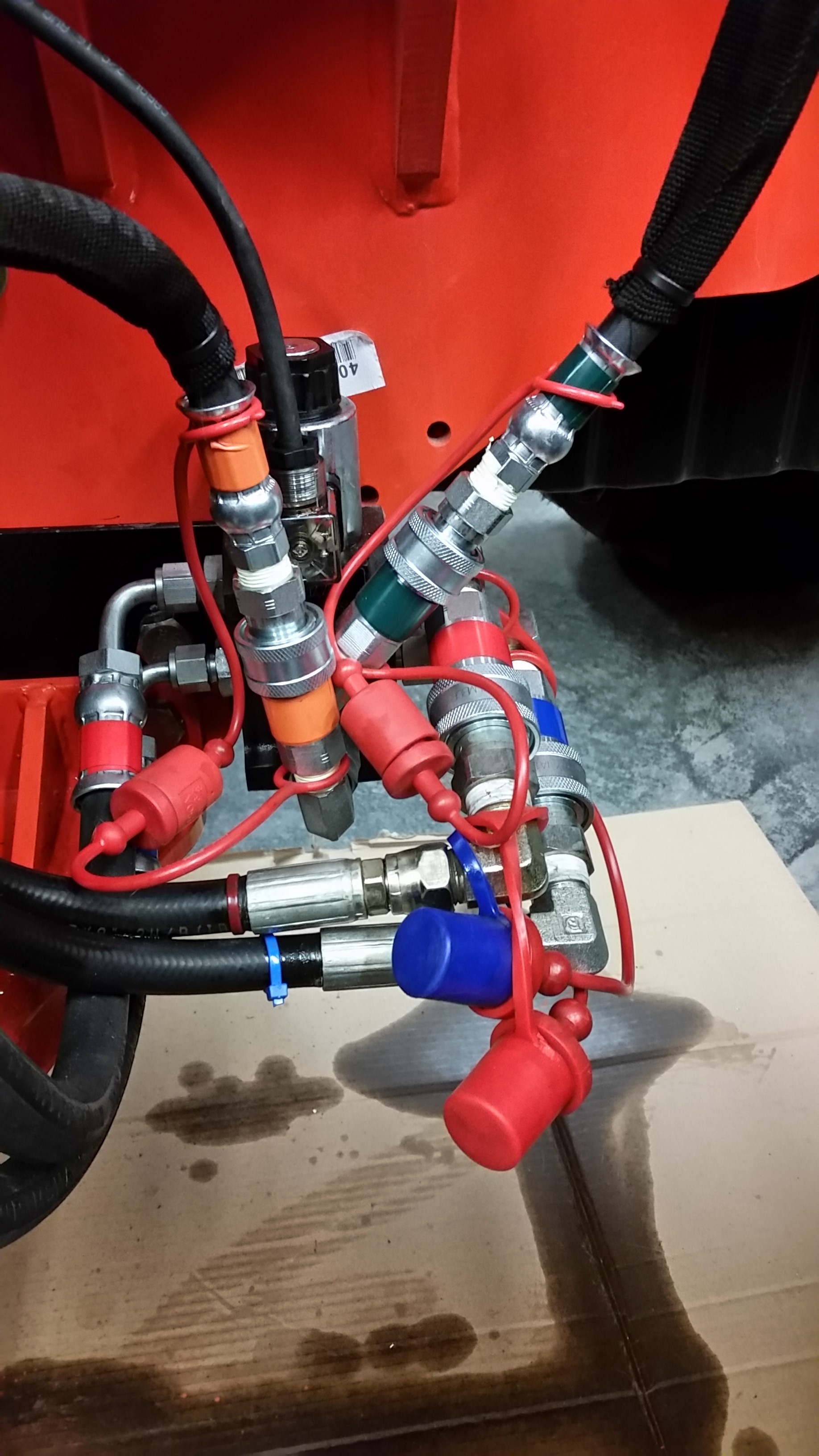

In the 2nd picture, I've got a question. On the 3rd function valve body, are those #8 o-ring boss-male to #6 JIC-male fittings?
/ New RX7320

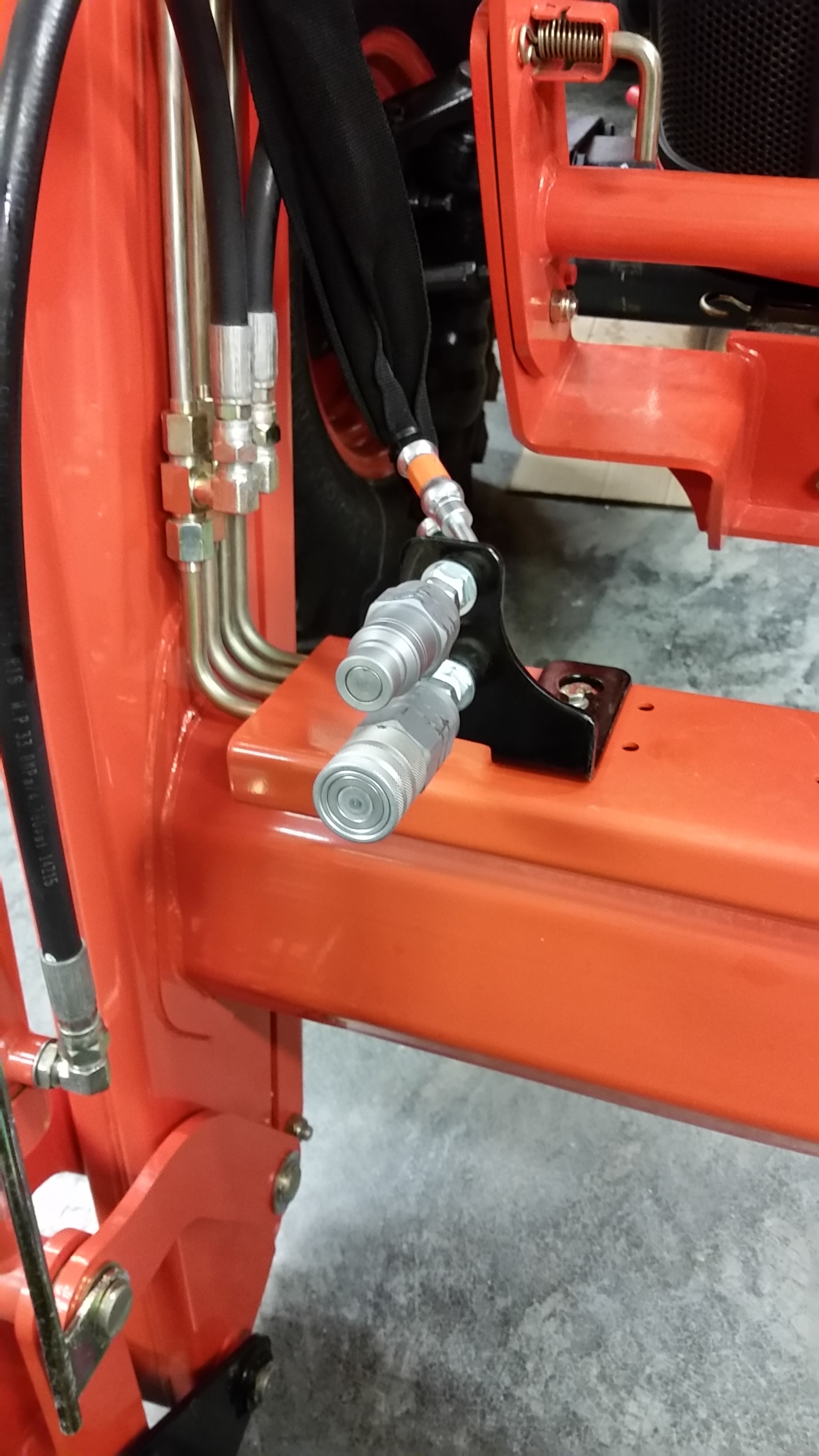

That is what those are. They are on the curl from the loader valve, couplers everywhere else. The diverter stays with the tractor so you need to disconnect six lines to remove the loader. The last setup I had the diverter stayed with the loader so you only had to disconnect four lines plus electric.
Thanks for the clarification. For some reason I was thinking that you had a true 3rd function (probably because of all the QDs there) and those #6 fittings would end up burning up your pump if there were on the constant flow ports. It is out of the norm to have the diverter not stay with the loader when removed, but it gives you another set of remotes to use when-if the loader is removed if needed. :cool: (AG use and all.)
/ New RX7320 #10
Our Constant Power Beyond 3rd Function Kits use a larger manifold body with SAE10 ports / JIC10 Fittings. This large of a valve isn't required for the Electric Selector Kits. Our Continuous Power Beyond 3rd Function Kits are rated for up to 18 gpm continuous flow.

I was like Hamlet pondering diverter vs. constant power beyond. In the end I went with diverter. I'm used to the setup from my old rig, the requirement to execute three functions at once is not an issue for me, and I feel that you can use a little more "feeling" with the curl function when using a grapple. After scouring the forums it seems that it is a matter of preference and, in the case of some of the smaller tractors, hydraulic capacity. The price was just about a wash to go either way.

Great. :thumbsup: Like I mentioned, my concern was that it was a true 3rd function and not a diverter 3rd function. I am also in favor of diverter 3rd functions. Much nicer to be able to feather the control of the 3rd function vs off or on like the typical true 3rd functions systems that are out there.
I do have a question for you though, what is your reasoning for leaving the diverter with the tractor vs the loader? :confused3: I know that on both of my utility tractors, I have the diverter valve mounted on the loader tower. Stays with the loader, just seems simpler.

Not sure there is any technical reason. We have always mounted the valves on the tractor. With the Kioti integral joystick valve in the tractor, it keeps the plumbing straight forward for an "Add-On" customer installed Selector Kit.

Ok, I was concerned about the selector valve being exposed to tall grass, brush etc. Kioti left me a couple of holes in the loader sub-frame which I drilled out and tapped to 7/16ths X 14. The sub-frame is harder than Chinese algebra and I was unable to get my good BluePoint tap through drilled for a 25% thread so I had to creep up a little bigger. That is actually good news in a way, the sub-frame is definitely a higher quality metal than the average Chinesium items littering my shop. Made a pattern and welded up a 10 gauge box that will protect against grass and light brush. Added a nine dollar toolbox from Wal-Mart for a couple of tools, pins etc. and Bob's Your Uncle. Ready to go to work. First job is a pile of rocks I need to move. Hate to scuff up the bucket right out of the gate but I got it to work and what good is a 30 thousand dollar hangar queen?
