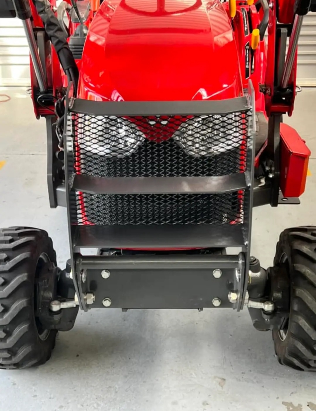

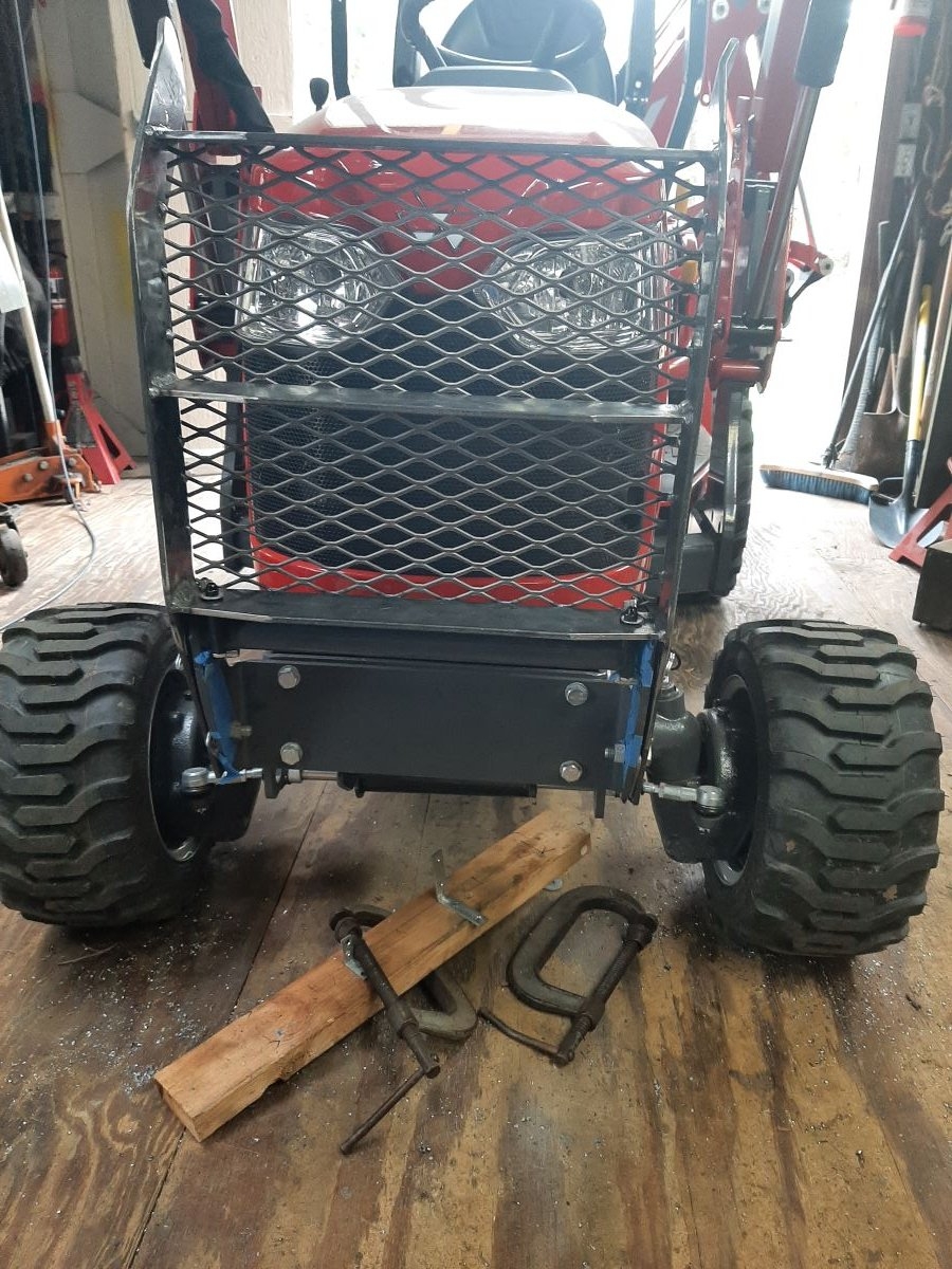

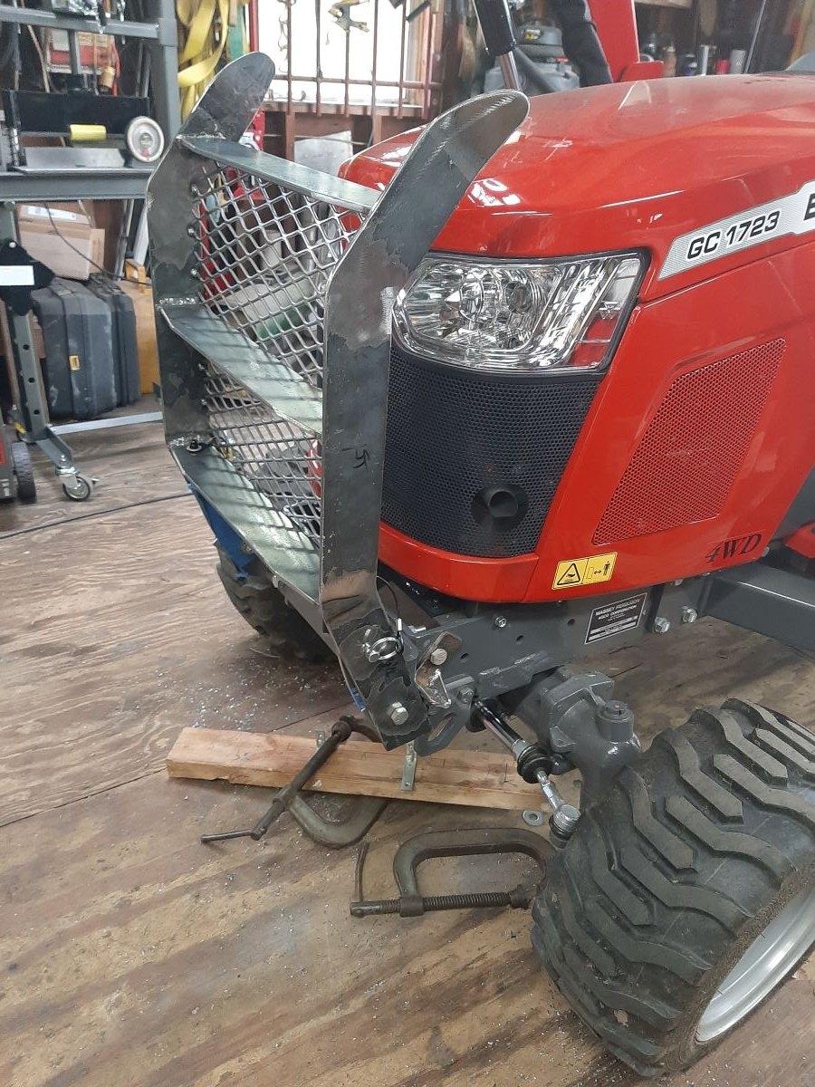

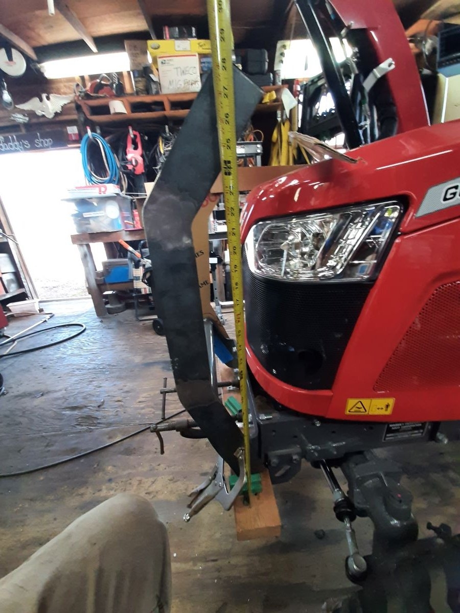

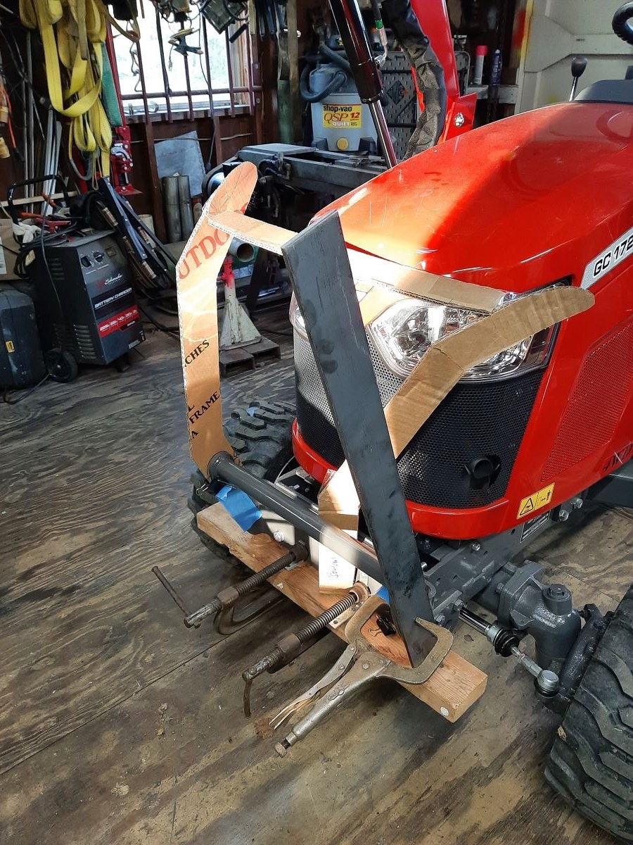

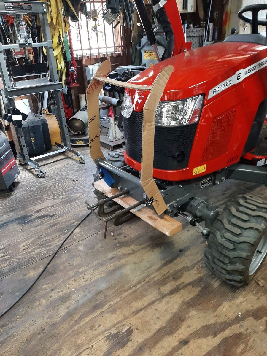

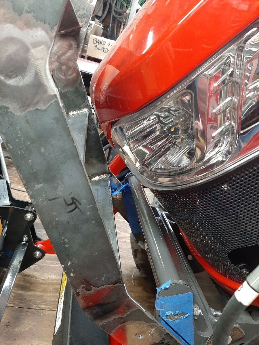

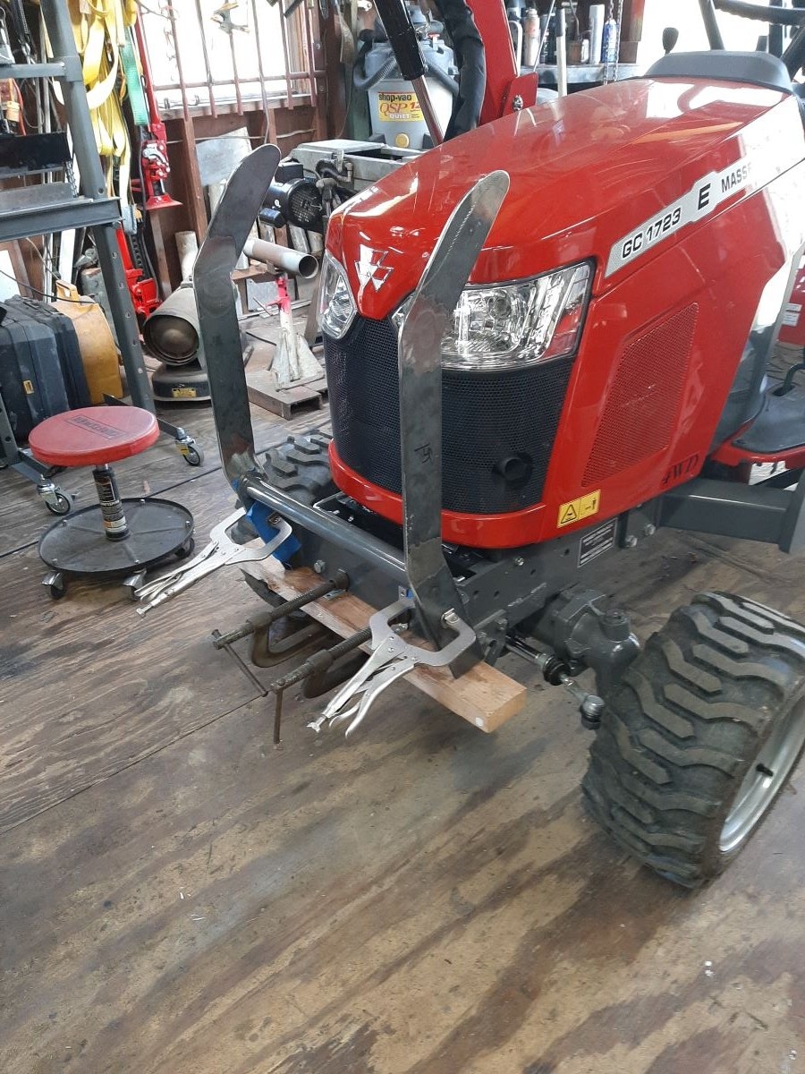

That looks good. If you carried your vertical sides spaced out as you have it only as it goes up if you carried the contour around matching the shape of the hood. The sides could have a soft radius as the hood does curving back . And the top cross piece could be welded on the same plane of the hood. If 3" higher but carrying the angle as the top of the hood.
Pay no attention if you have already cut that will look great. You're making it yours!

You already have that front end shape matched up nice. Pay no attention, I may mess it up for you:unsure:
/ Pimp my Massey: New GC1723EB #64
With 1/4" x 2.5" stock I would build it just like you have it mocked up. Without a brush guard the grill is always the first to go. It just happens. That will also add some front-end weight.

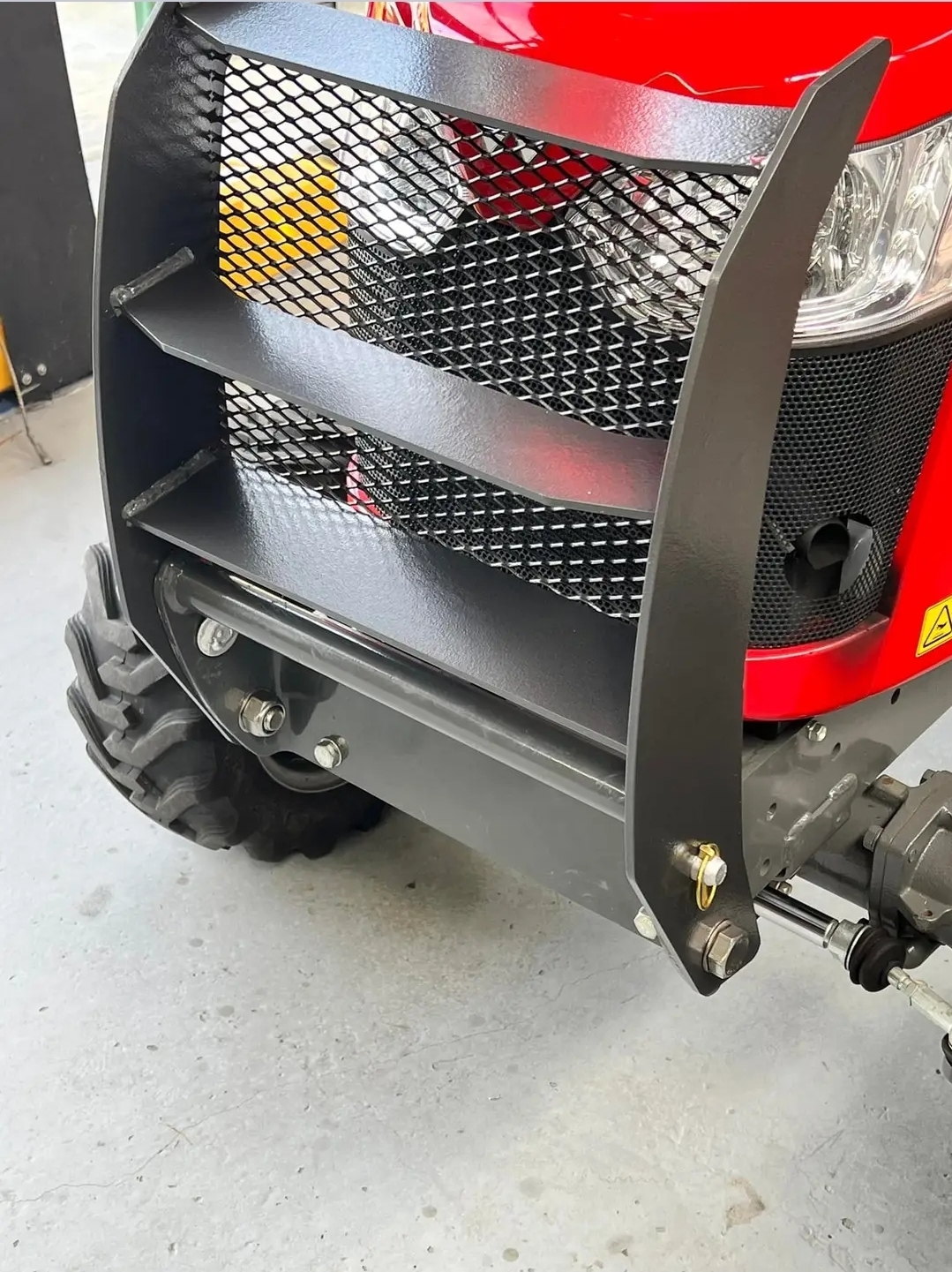

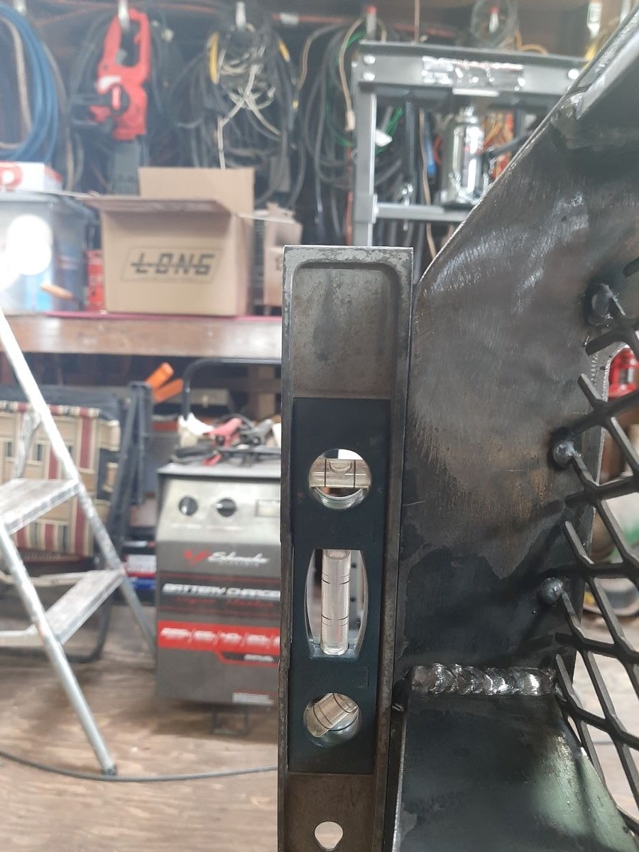

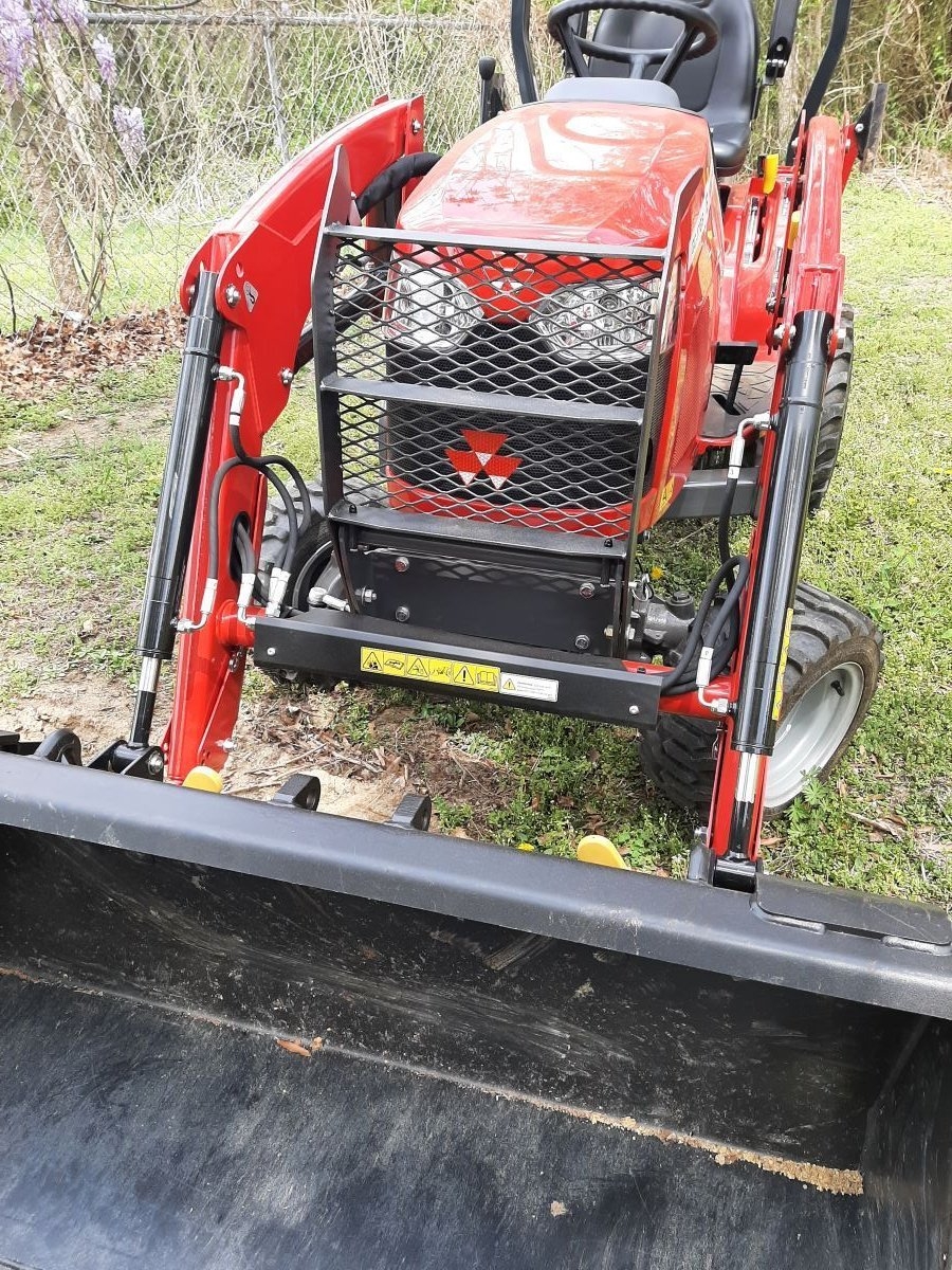

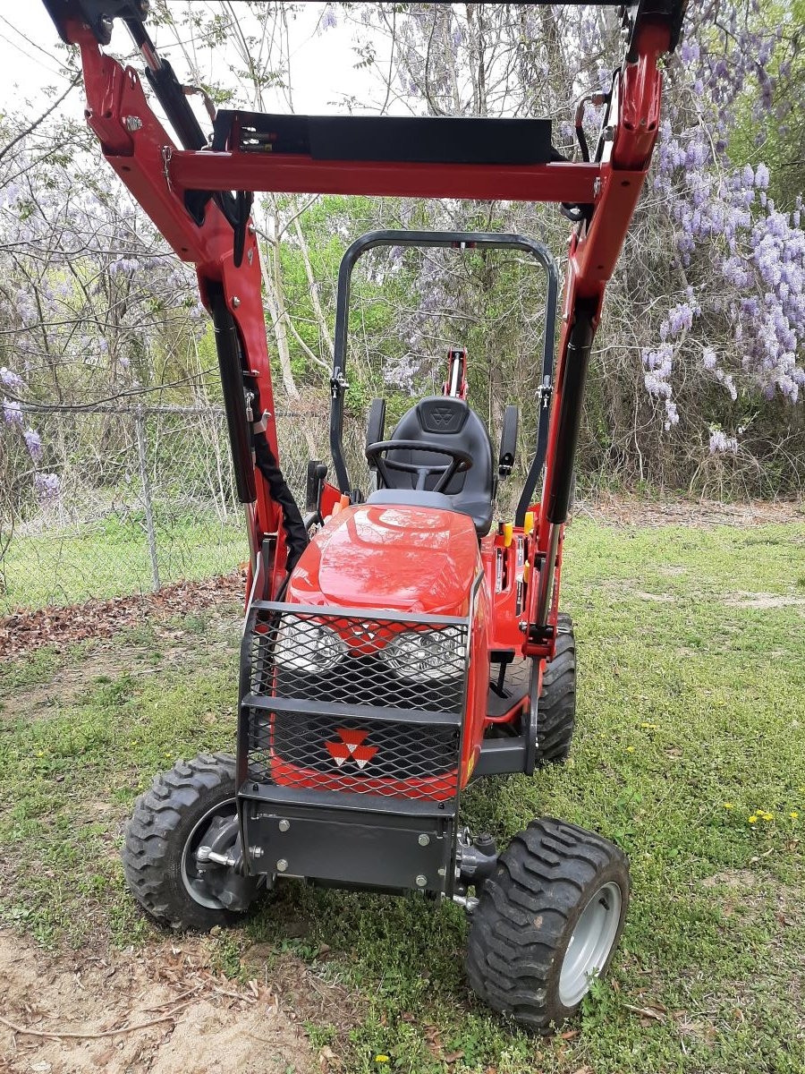

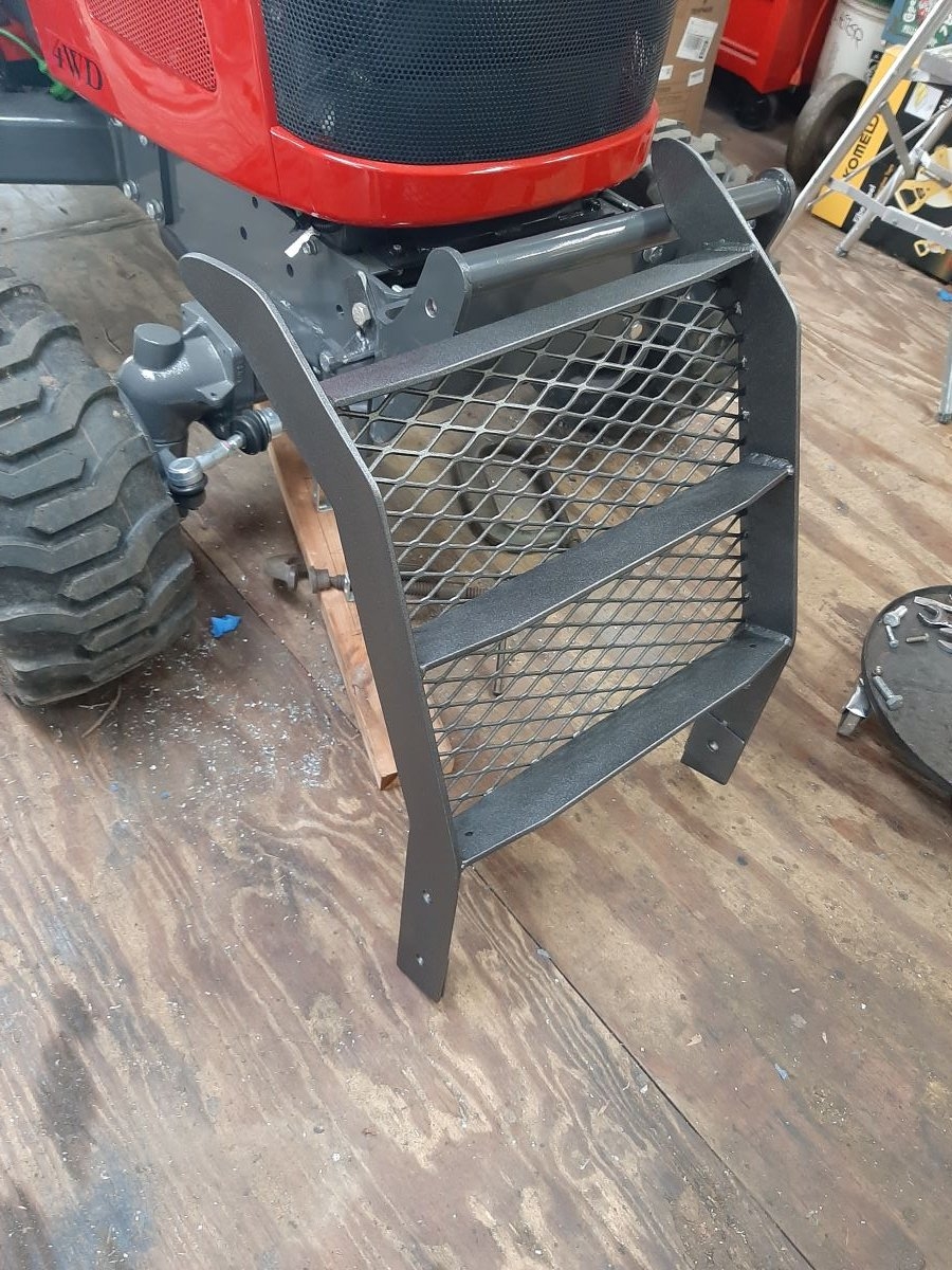

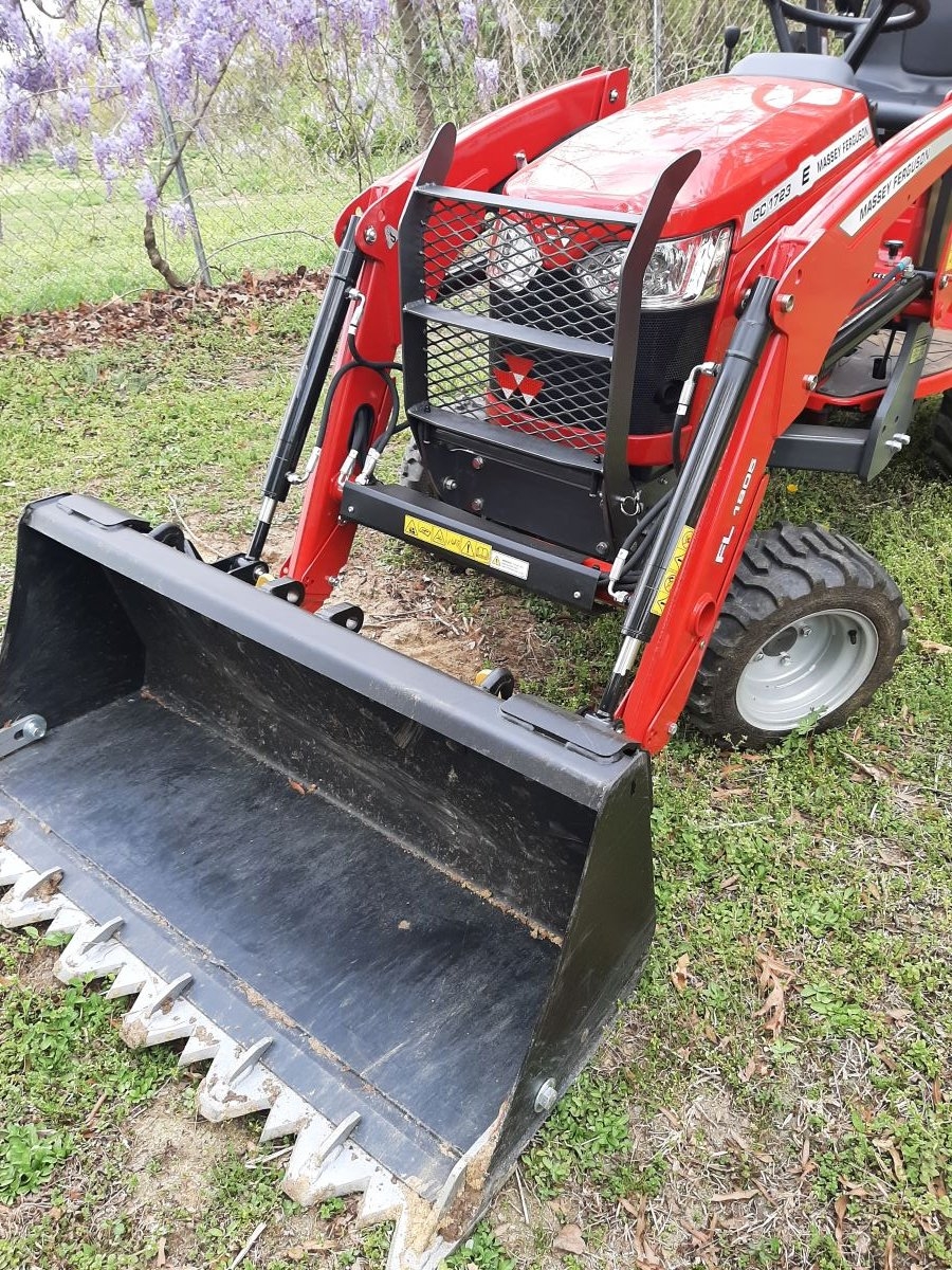

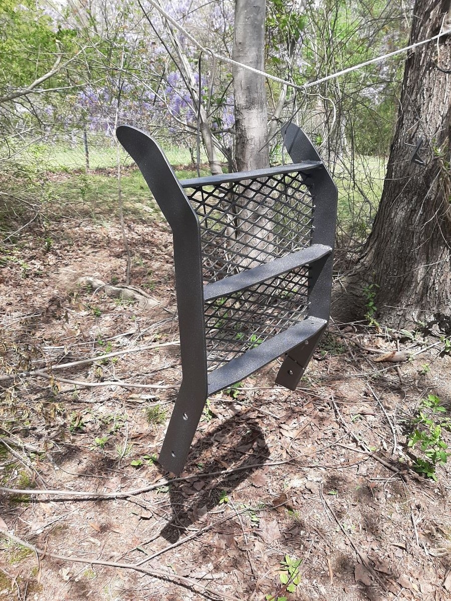

Brush guard complete, a few R&D items remain. Here the sequence of it being born:

Protecting your investment with class. The Mitsubishi Emblem is a nice finishing touch

Brush guard is almost exactly what I had in mind..... Gathering up a few more odds and ends and I going to start fabricating....

Thanks! The emblem is cut from some extra reflective tape I had, and mimics the Massey. Needs a backing plate, maybe later. Brush guard battle tested in the woods and worked great.

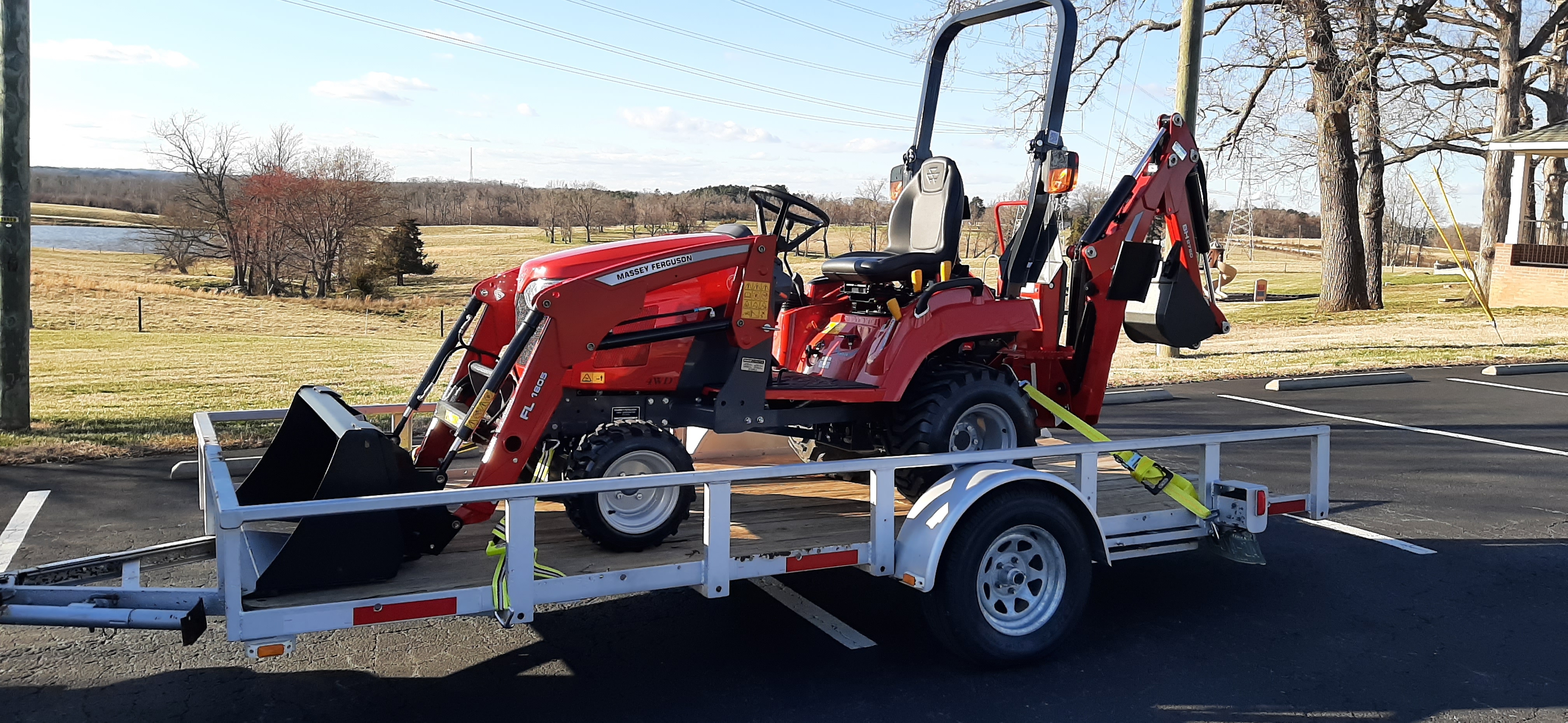

Testing out my buddy's 16 foot car hauler to see how the GC would fit and how much room left over. I will need to purchase a new trailer at some point, not crazy about the $4k price tags I'm seeing.

Built a 2nd brush guard for a friend, turned out well and he is happy with it.
