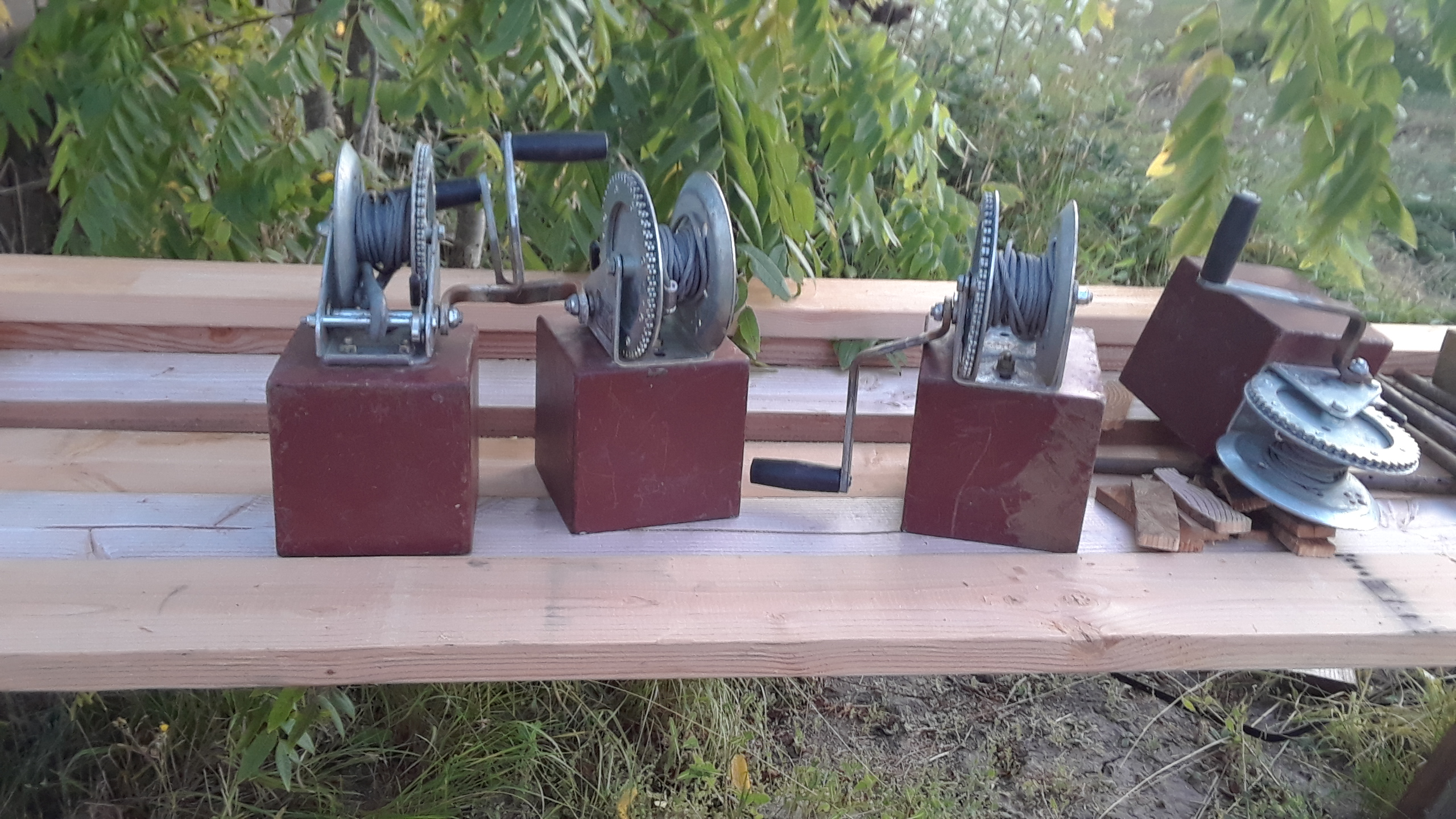

It was pretty simple, it's just boat winches on top of a metal box sized to fit over the top of the 6x6 post. we had 5 people on ladders and 7 ladders so there was a little monkey business swapping side to side, but that part was done in about an hour.

I took a picture of the truss jacks before we used them, it should pain the picture of what they do, they just sit on top of the posts. With enough ladders and people you could crank the whole thing up at once instead of going side to side like we did. On the corners we just wrapped the cable/strap around the truss, on the doubles just used a steel concrete stake between them.

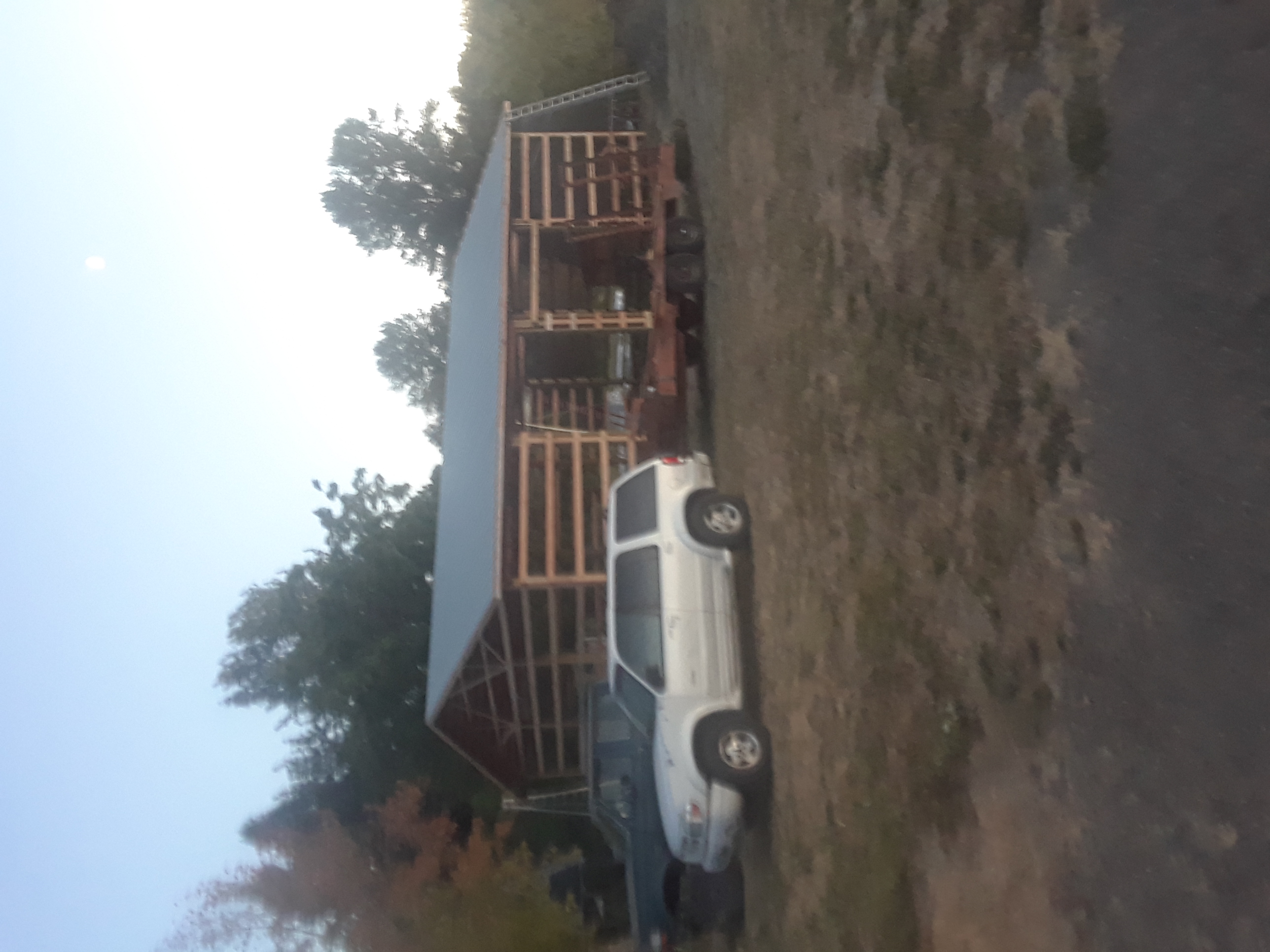

So, everyone loves pictures...
I was as normal overly optimistic with what I could get done in a weekend... I "thought" I could get the roof and sides done by myself... didn't even get the roof done with a friend! I severely underestimated the time it takes to put in almost 2000 screws... and that it would be nearly 2000 screws just for the roof...
Anyway, just the last row of roof left to put on and the cap and trim! Then onto sides! It did NOT help that it was probably 80% humidity and 85F yesterday...
And I finally attached a picture of the truss jacks.
