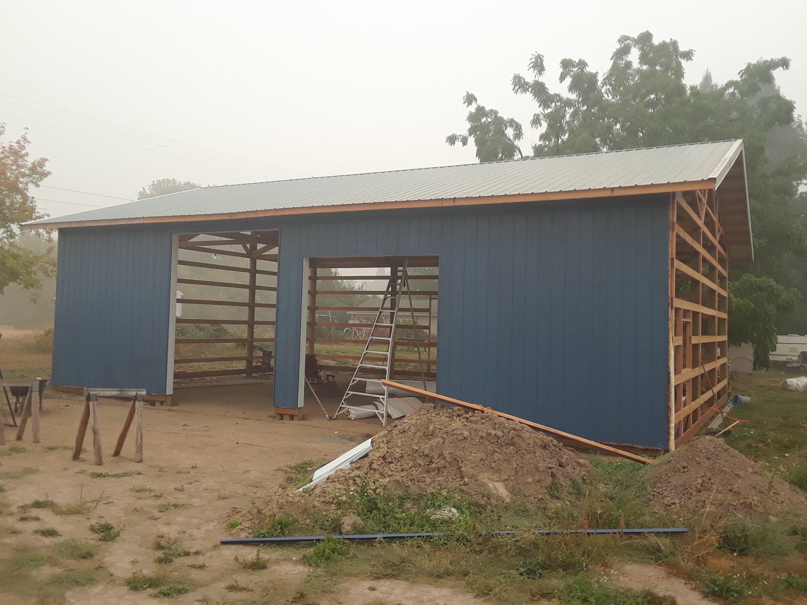

Here's this weekends progress.
This metal siding with insulation takes some time especially alone... That wall took some time, only 4 of the sheets of metal didn't need cut of any sort, two were just a simple corner cutout for the trim, 4 pieces needed cut 3" shorter and 6 were major surgery :). That said, the hard wall is done and now I know more... I got one more bay wall covered on the other side since I had some daylight left... Looks like the weather next weekend will be decent too so hopefully I can get the walls done.

I like your color choice. What are you using to cut the metal? For length, I usually use my 7 1/4 inch saw with an old, dull, framing blade in it backwards. For more detail cuts, I use a 4 1/2 inch grinder with a cut off wheel.
   / New shop build, beginning stages with questions #114
I used to cut sheets of steel like you do Eddie. I got tired of the noise and jagged edges. Now I cut with a simple set of non compound regular tin snips. It's a bit of a pain over the ridges but it's quick and quiet.

Combination of brand new Milwaukee tin snips, an electric shear, and an air powered nibbler depending on what I'm cutting :)

Yep, that's me. Circular Saw is way too violent.

yeah, and I read something about it overheating the cut and rusting early... didn't want to deal with that, combination of the manual shears and the nibbler seems to go good across the ribs if you cut the deep one manually it will go over the rest of them. I did buy a metal cutting circular saw blade anticipating its use but I'm more turtle than hare...
The new manual snips are key... I've never used new good snips before, cut like butter and will cut a hair off the edge if you want to! Plus the Milwaukee snips have more of an angle than the normal Wiss so your knuckles are out of the way, and only $34 for the pair of left and right at Home Depot... I think $2 more than the 3 pack of Wiss
