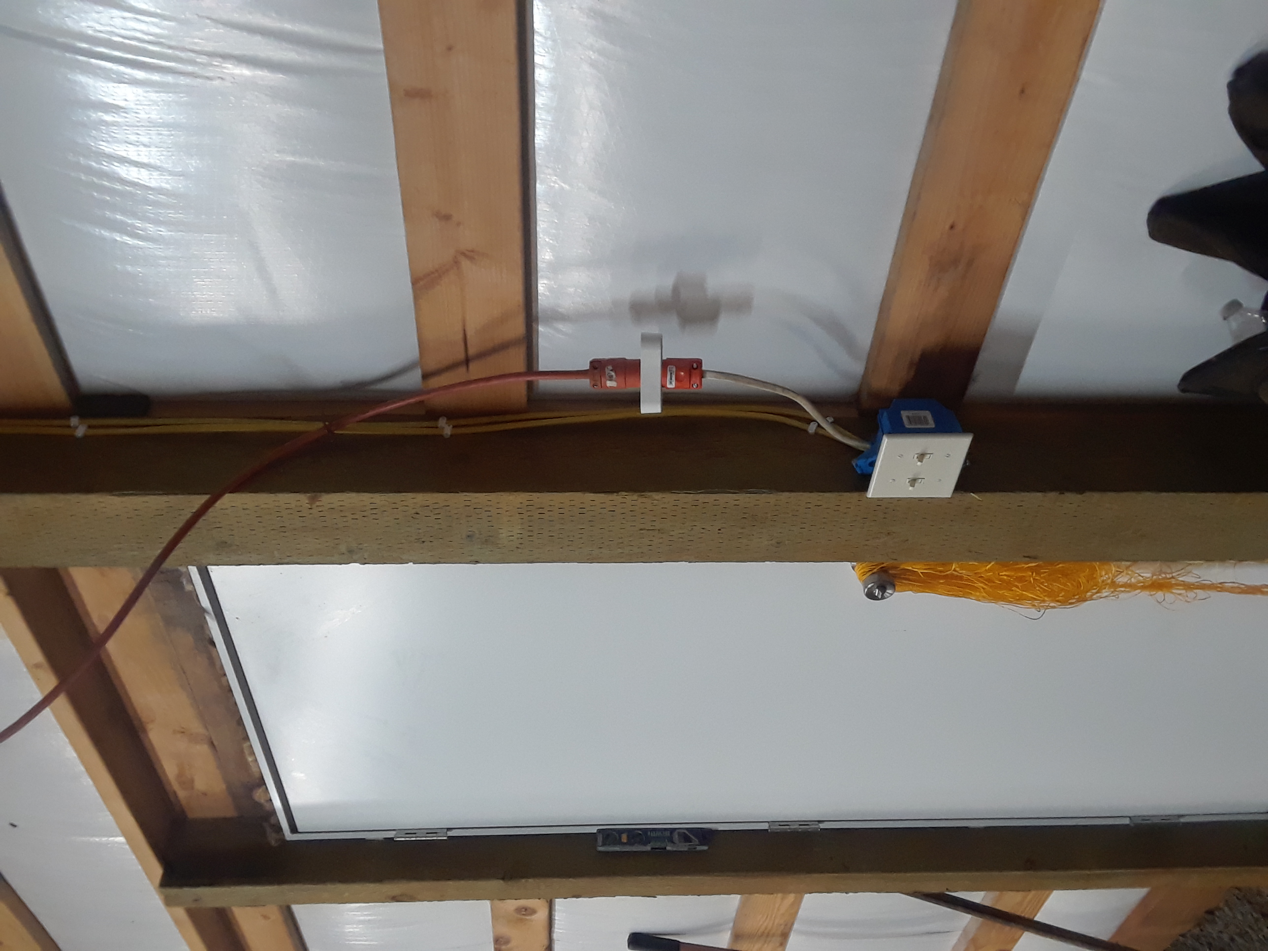

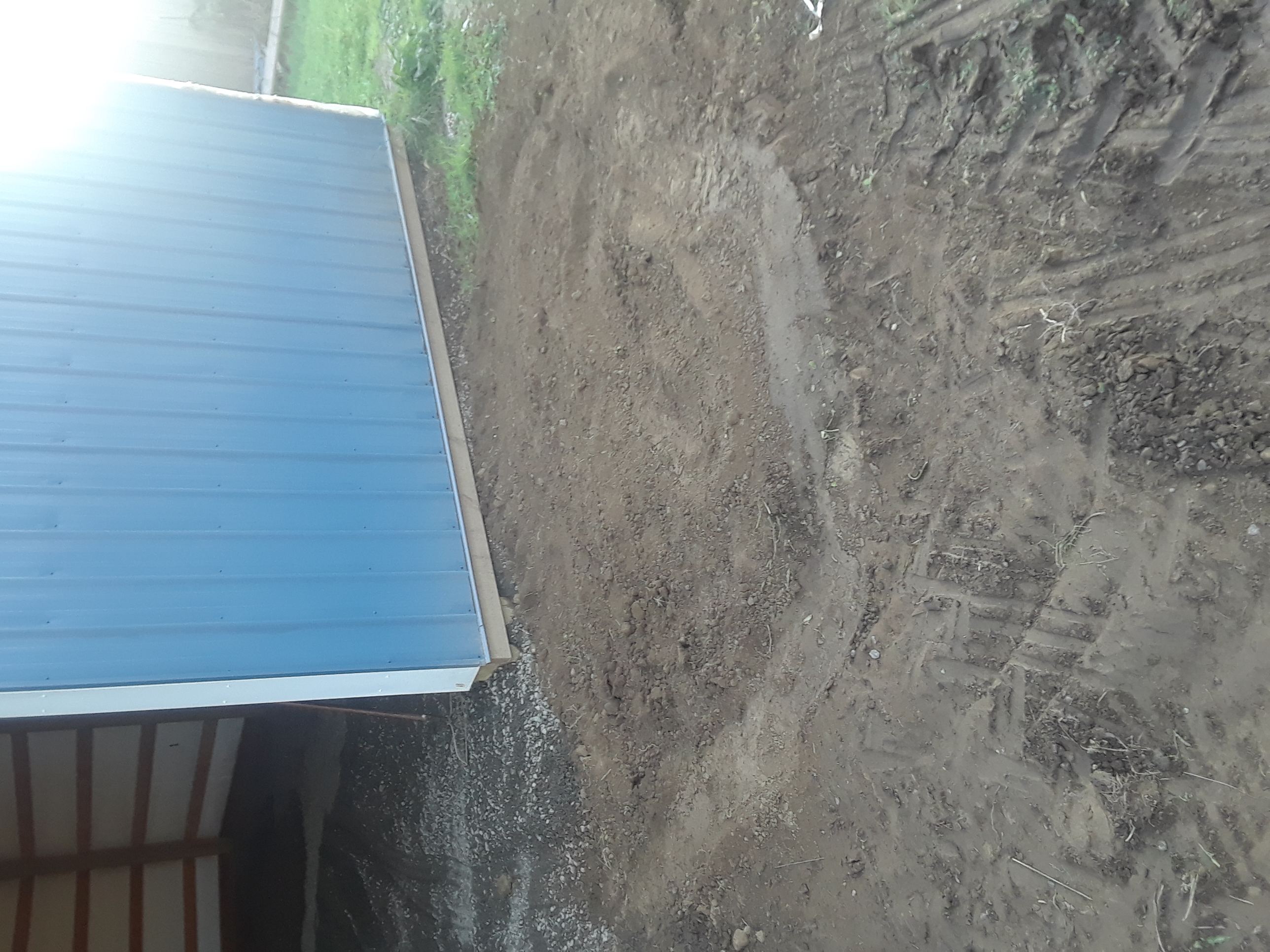

Here's the latest pictures... One is the stupid big hole in the depth it's been for a long time, once I finally got gravel I put it in from the inside and let it get it's natural angle on the outside then I filled it with top soil and compacted it with my jumping jack and now it doesn't look like anything as you can see in the other picture.
The other picture is my sweet power inlet to the shop for now, extension cord going to a splitter going to the switch box so I can power other things if I need to... It's temporary, electrician will be calling me on Wednesday hopefully to see about working on my wiring stuff, will need to get a bigger box tot he house so I can safely transfer power to the garage and shop from the house, don't even currently have a main power cutoff but at least it has breakers...

   / New shop build, beginning stages with questions #137
Looks really good. You should be in good shape for winter!!!
