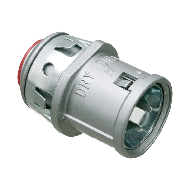

On another note, there was a local Home Depot return online auction a bit ago and I picked up a roll of 12/2 with the aluminum shield for a little under retail ($20 I think, anything helps) which would probably be good for some of the runs to outlets. Also picked up a 24" attic vent fan with louvers to put in the trailing edge peak to get welding fumes and possibly paint fumes or summer heat out for less than retail.

just be careful using mc or bx cable (Thats the aluminum wrapped #12 wire). Make sure the metal is cut clean and does not pinch the internal wires. They make special connectors that have an internal plastic shield to help prevent arcing. I have had to do a fair share of troubleshooting over the years to find shorts with this wire. C66496F0-56C0-4030-8C15-BE6B4DBC345F.jpeg
