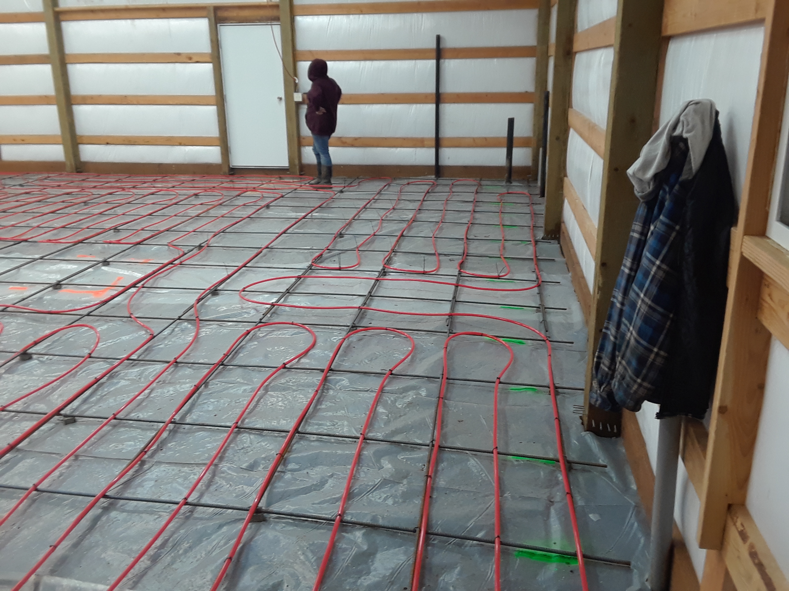

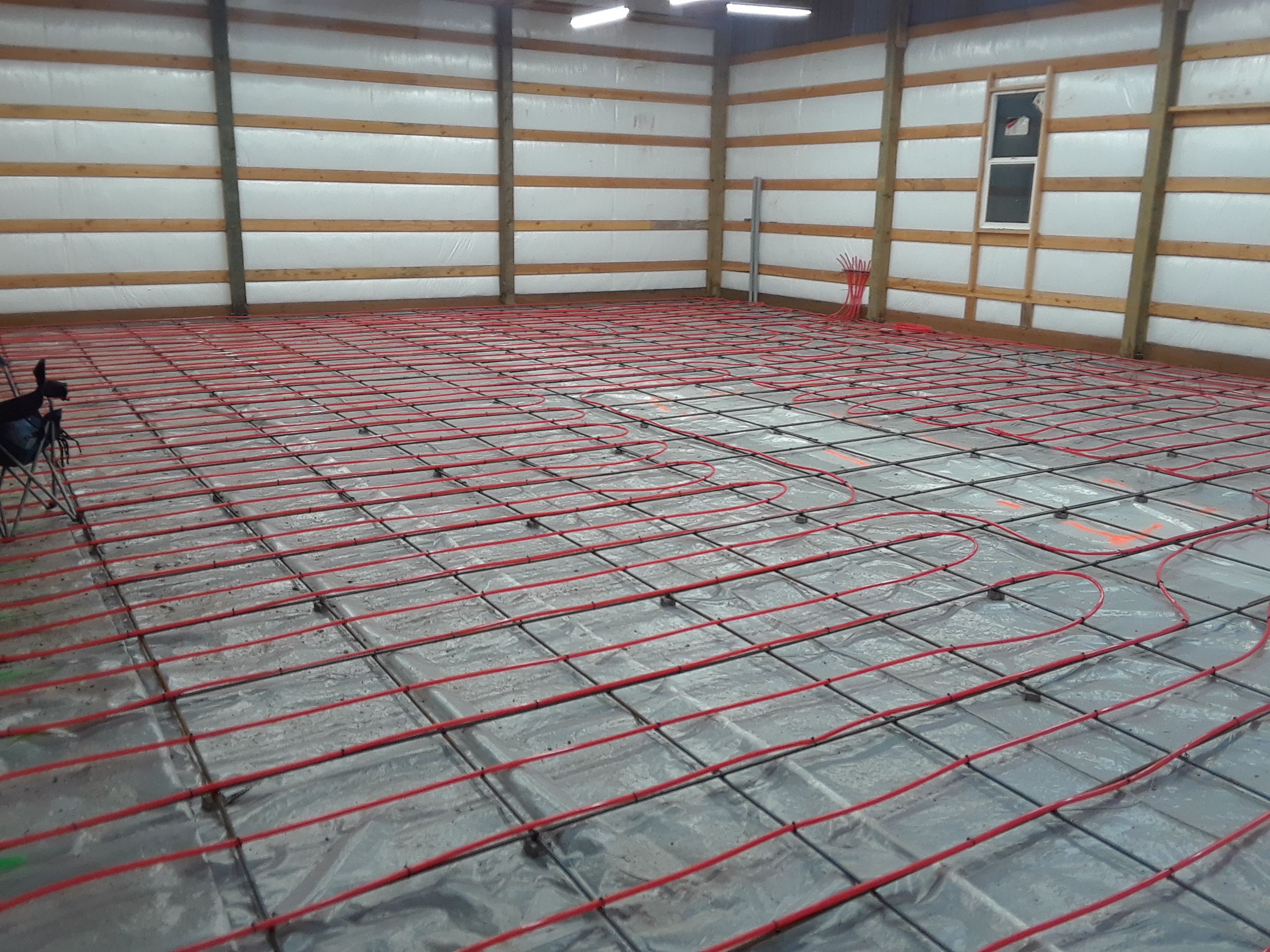

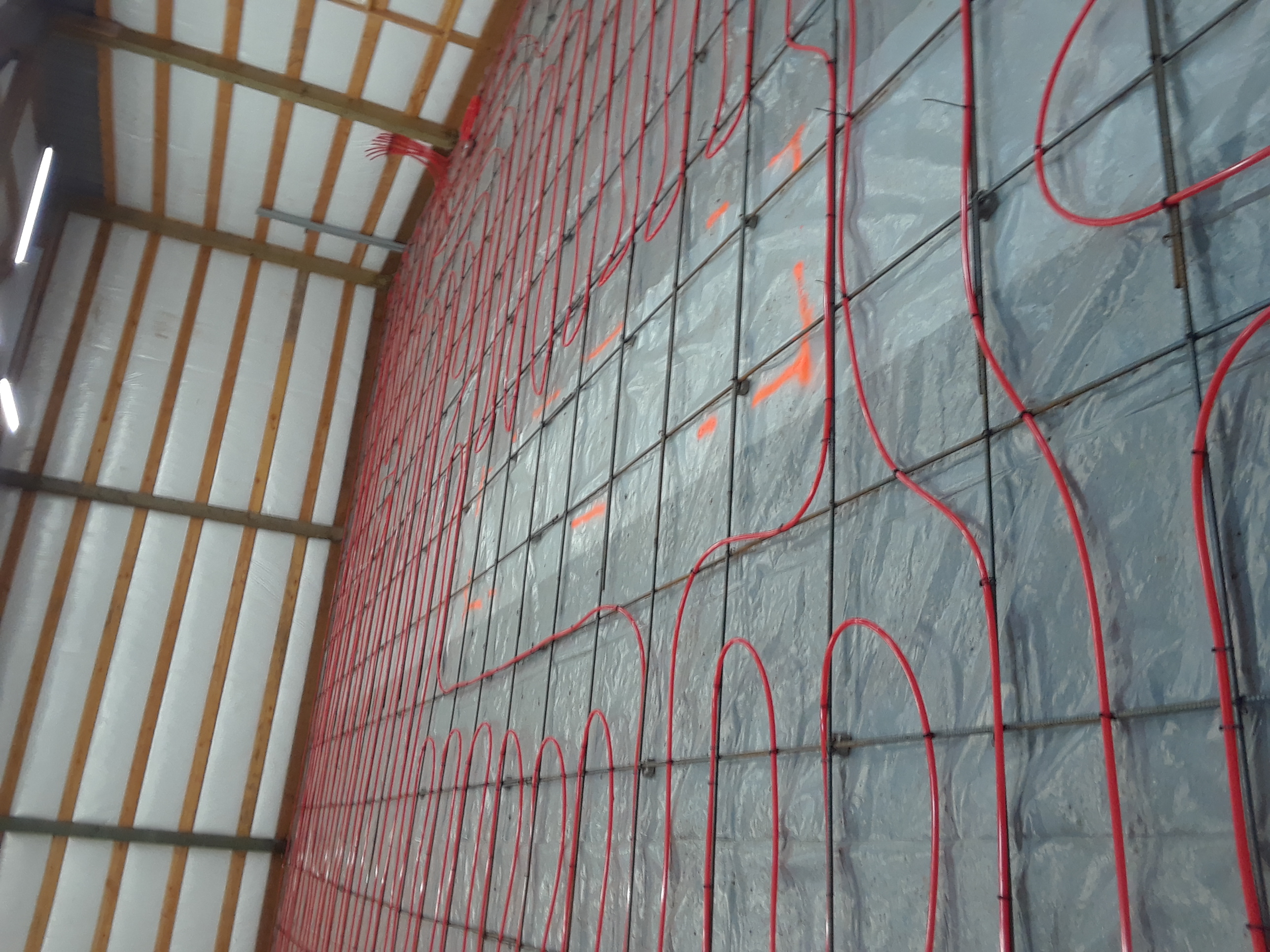

I got the PEX installed today, I'll get pics up in the morning, I'm beat... I'm pretty sure I used 1000 zip ties myself today... still have some touchup since a couple of the loops go up, gotta look into securing those... then to figure out the floor additions and get some mud taken care of in the driveway to the shop as it's getting a little sloppy for a few feet and the concrete guy rightfully doesn't want to risk a truck getting stuck (I highly doubt a 10' sloppy spot will stop one of those, but I don't wanna pay for that extraction either...)

Ok, enough waiting, here's the pics from yesterday. With all of that we only put one kink in the PEX early in the second circuit, reading into it all it takes is a heat gun to straighten out so I'll dig out the heat gun and fix that in a bit.
