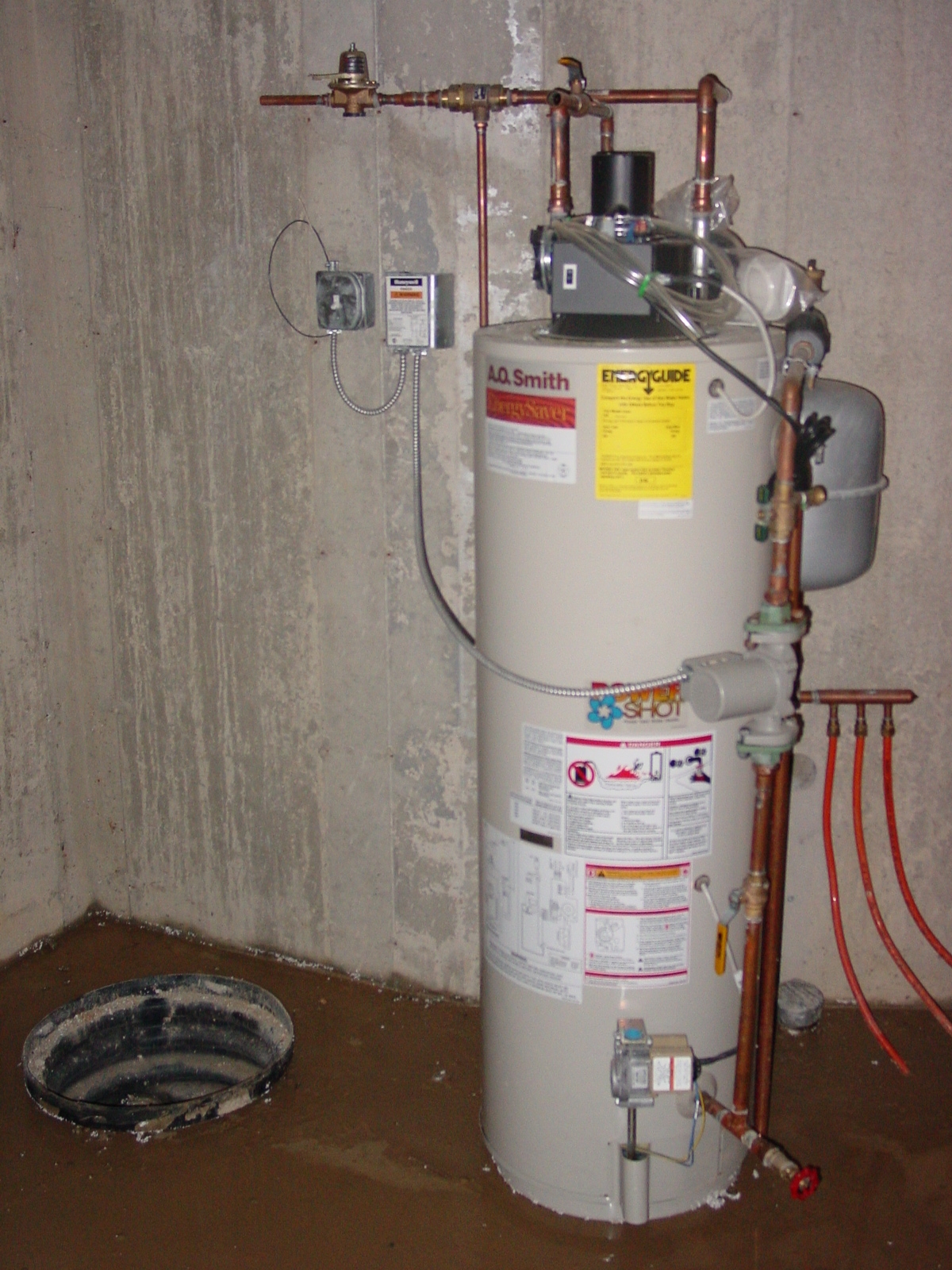

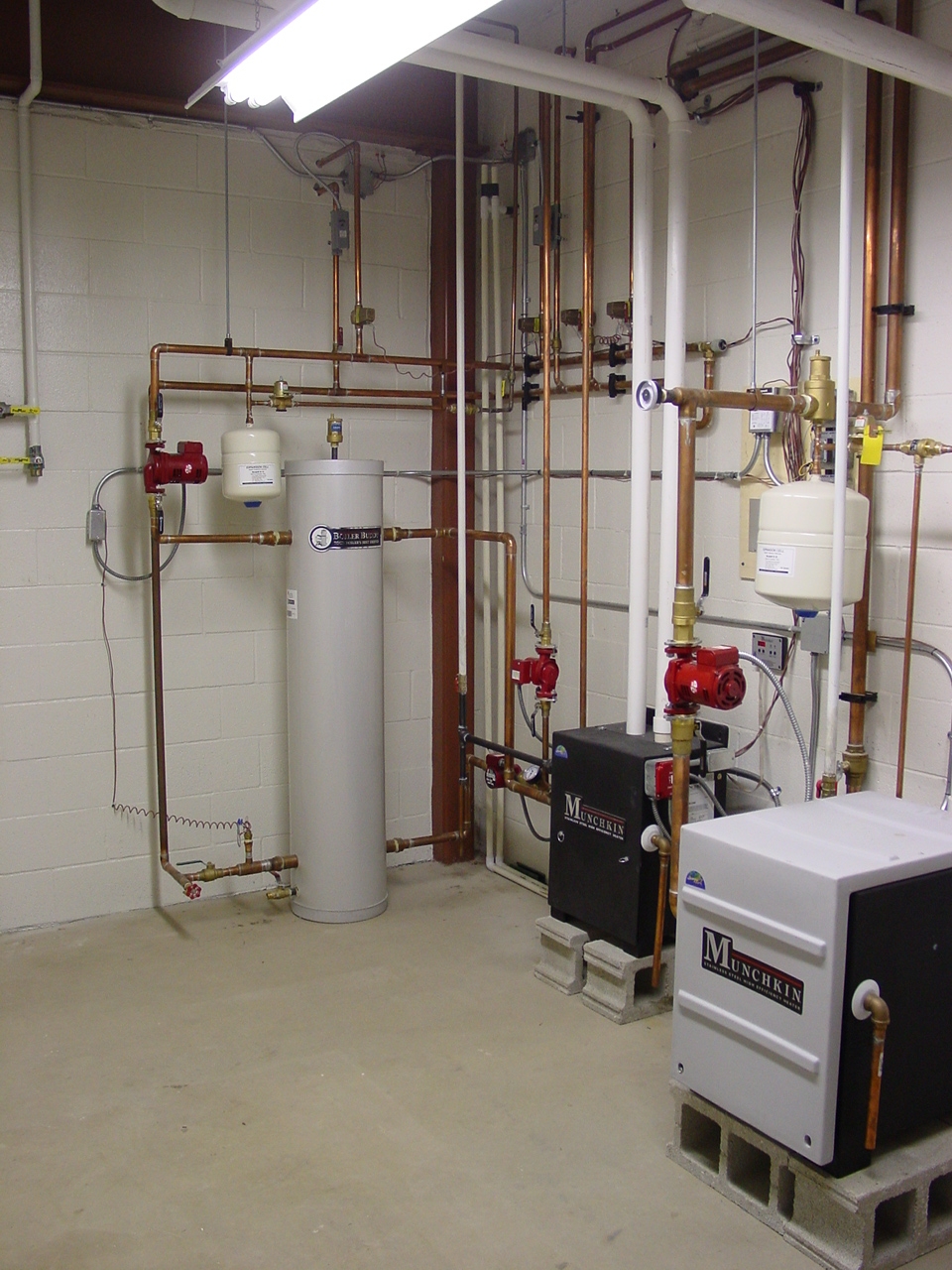

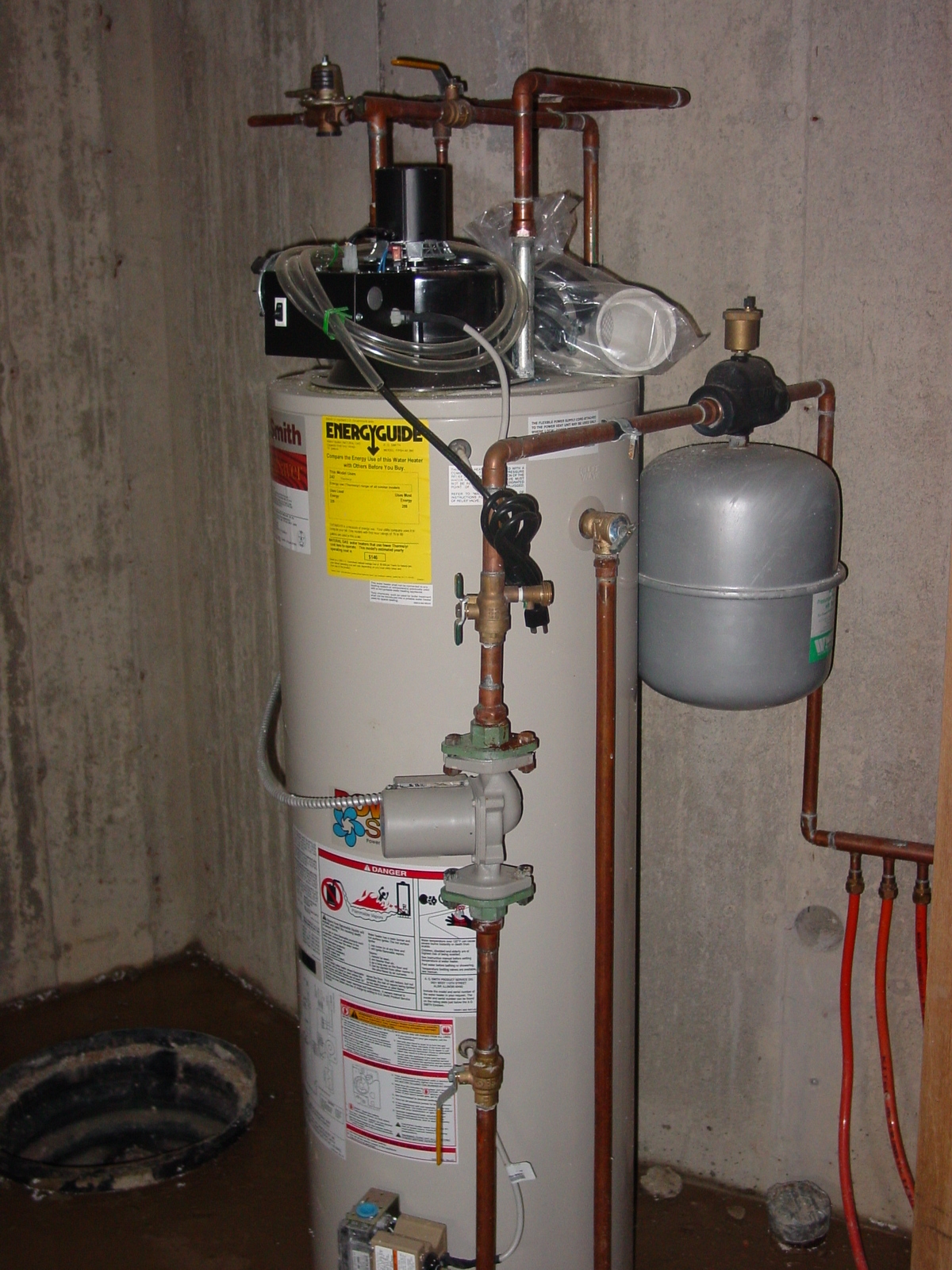

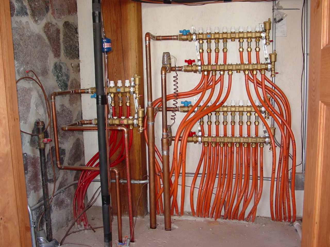

   / New shop build radiant floor heating sizing heat source. #3
You can get by with a basic system with a water heater as the source, I installed many this way with no issues. OR... you can get elaborate like the system I built for a special barn/office of about 15,000 sq. ft.
