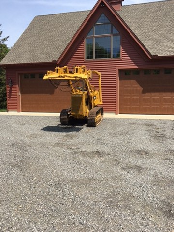

Did some logging w the jeep
Red safety bar is for going down the road
