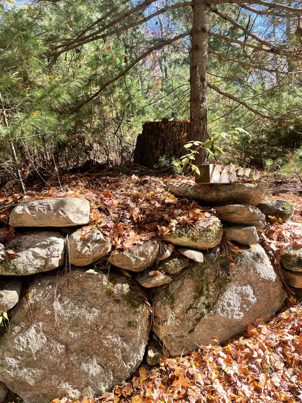

Took down a super sketchy tree with minimal escape routes. Wedges used and then the “wack, retreat, wait, repeat” method
Once I got it where I felt really uncomfortable, I went to do another project and heard it come down 10min later. Wife called me from the house 500 yards away as she heard it come down and was wondering if I was safe.

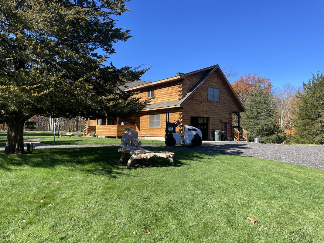

Then I finished up with one of my favorite chores. I hate mowing etc but rolling the driveway is relaxing. I need to add a cup holder

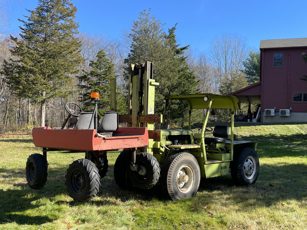

Rescue the Quadractor day
Threw a belt and now even though I went thorough it last year, looks like another tear down and fix a some shifting issues for the long term

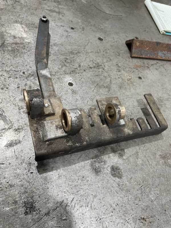

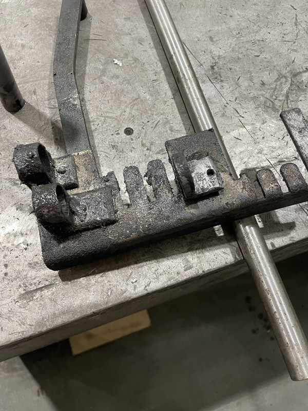

Ok so the issue was wear within a sliding rack that turns Fwd/back shifting motion into left/right rack movement.
Rack with the 3 worn guides. Zinc or aluminum?
You can see the wear between rod and guide

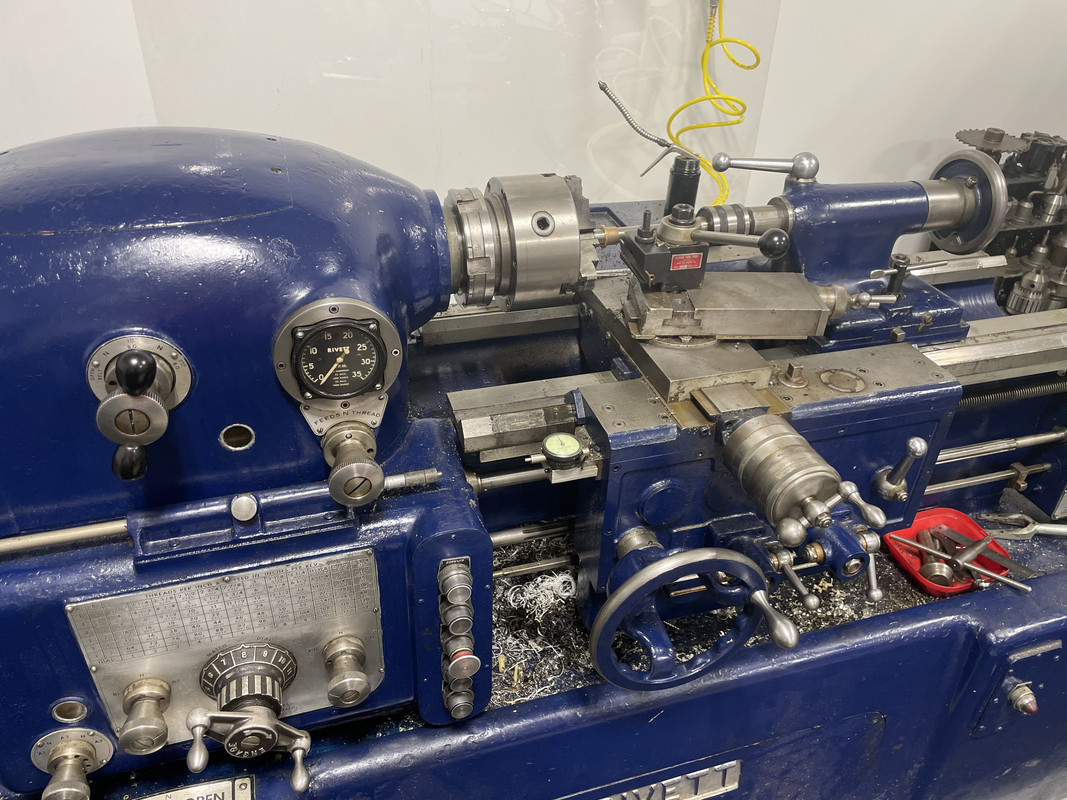

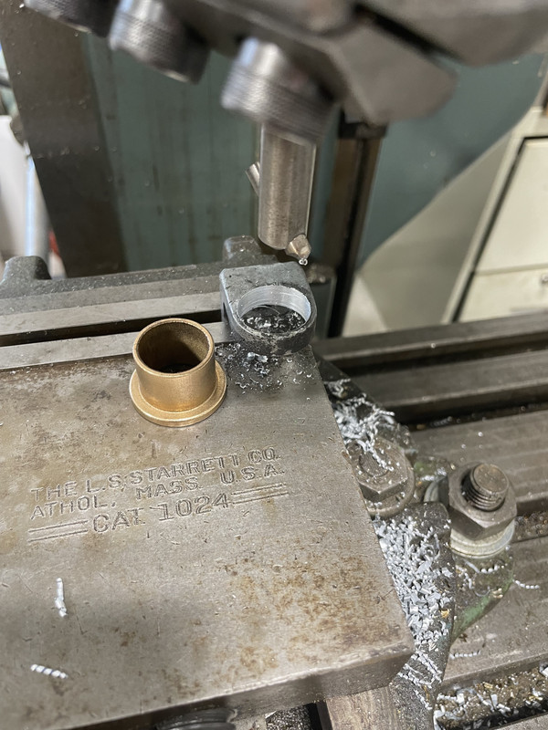

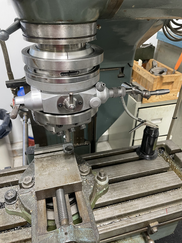

So boring on the mill with the D’andrea boring head to insert an oilite bushing

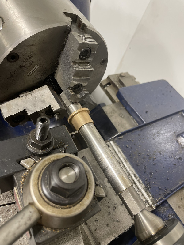

Turning bushing on lathe for press fit

What a difference, shifts like a car and no more belts jumping out of phase
