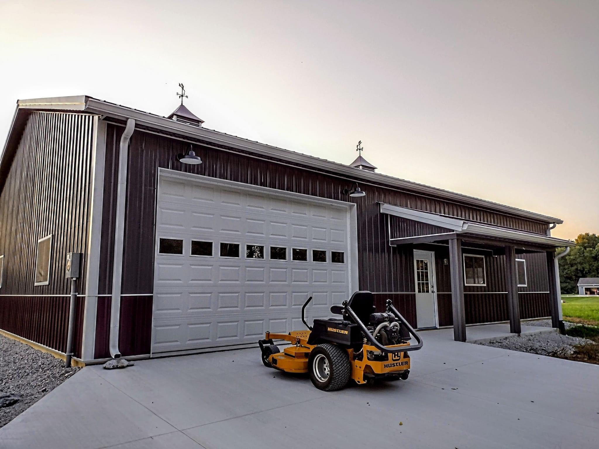

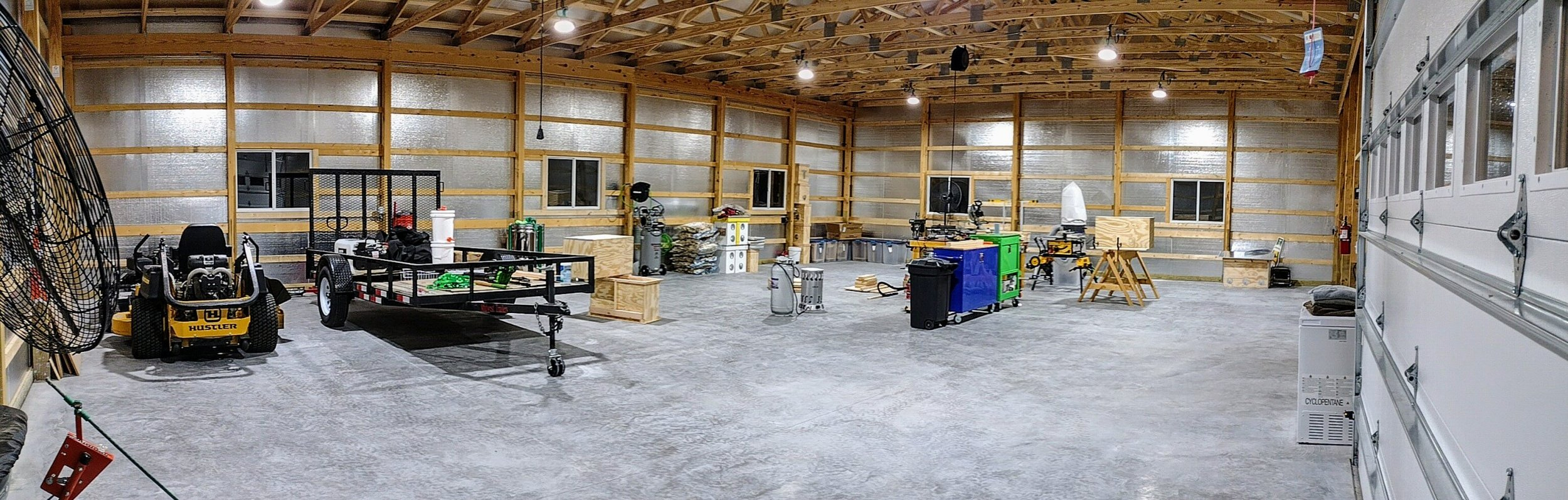

Some updated pics. Have the Hardie and electrical done. Will order the steel for the ceiling next week. The area under the porch will be brick wainscoting.

Lookin good!!! Thanks for the update!!!!
/ New shop under construction #40
Love the color choices, and the Hardie!!!! It all looks great.
