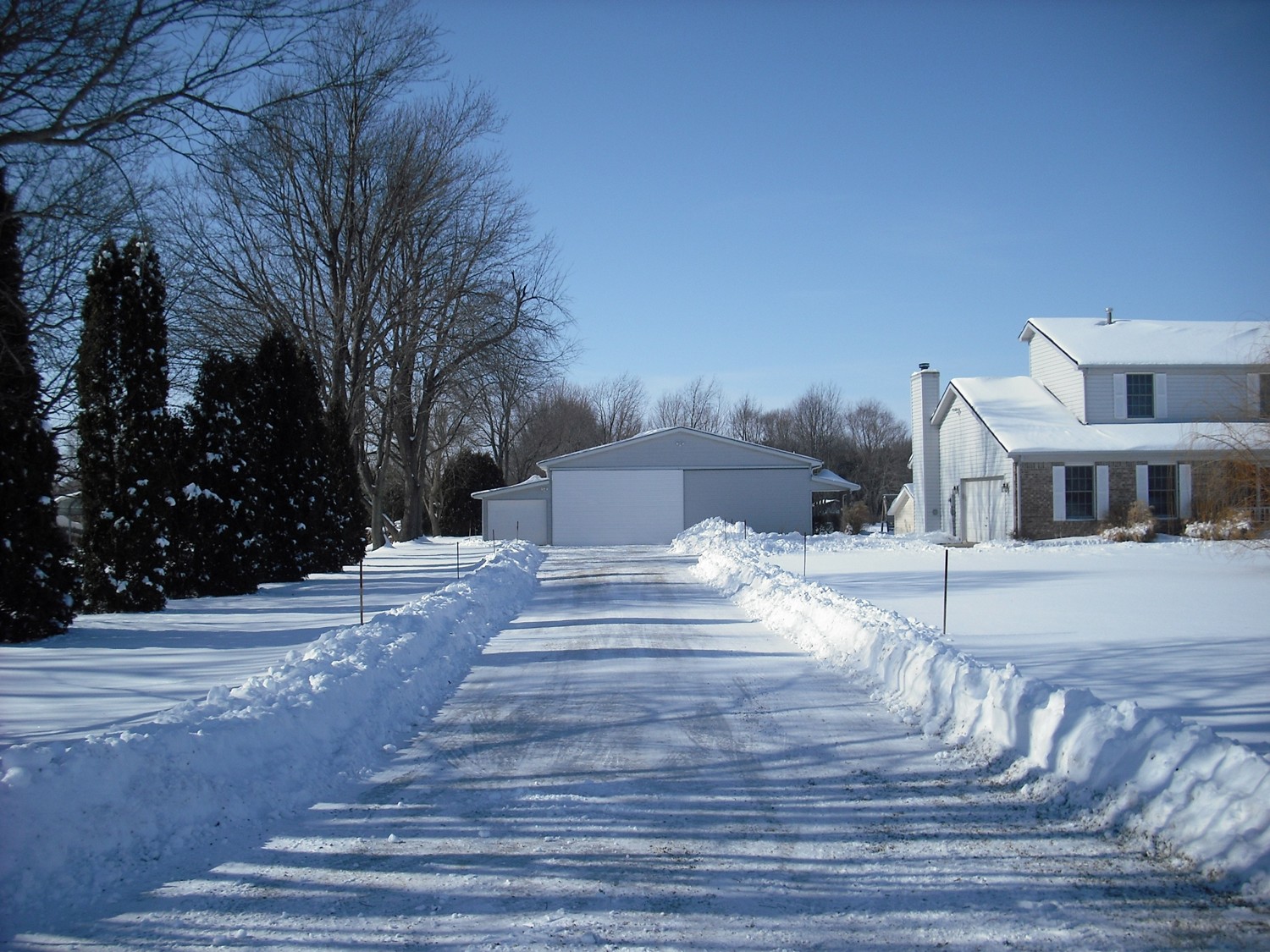

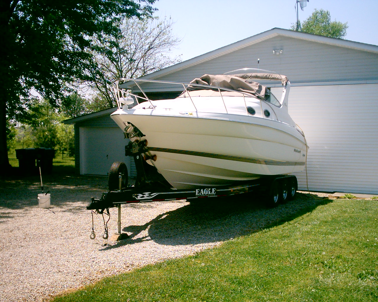

I would go no less than 14'. I am sorry every day I only went 12'. I can not get my boat in the door, my neighbors backhoe, dump truck, camper, ect. Its been a thorn in my side for 7 years now.
Go 14'!!!!
Chris

Chris, not to sound crazy and not knowing how the interior is laid out would it be possible to "raise up" the whole building so you could get 14 feet? It seems to me that this would work for you and not cost an arm and a leg. Your thoughts?
If he can afford a boat that big. A small 20x30x16 should be a pittance. :D :D
