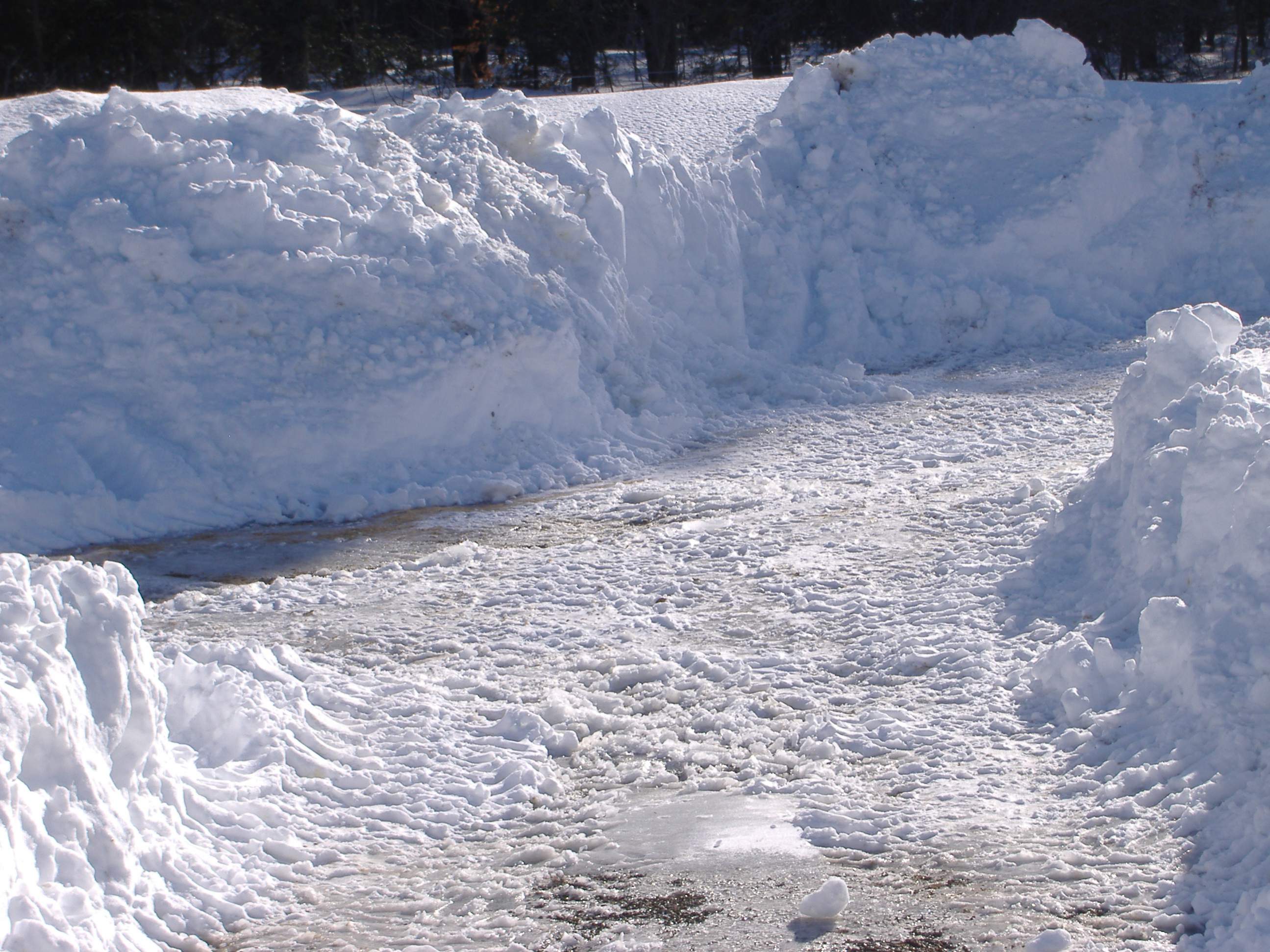

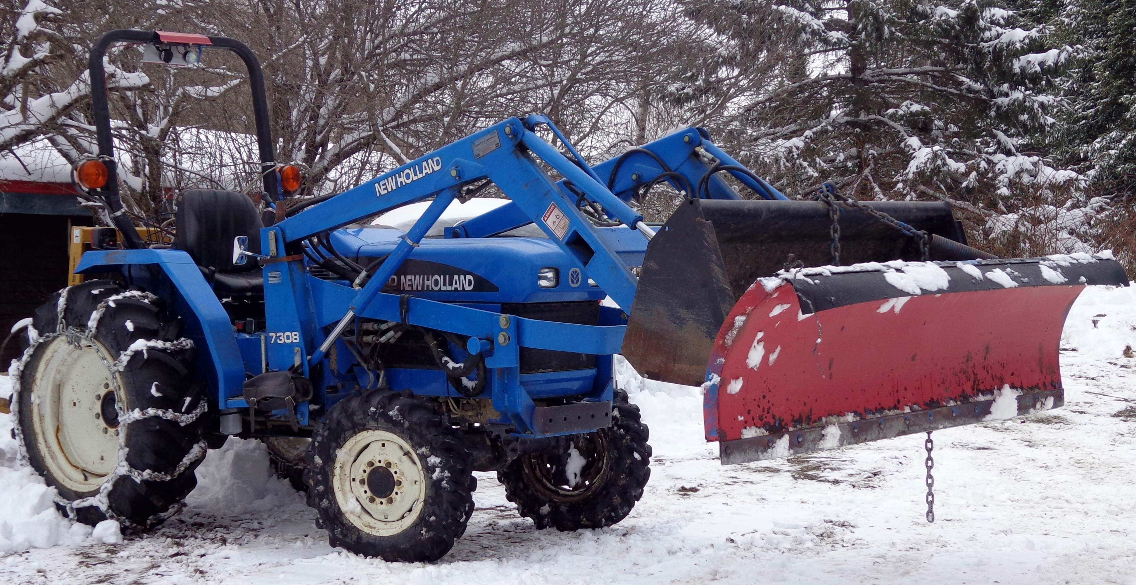

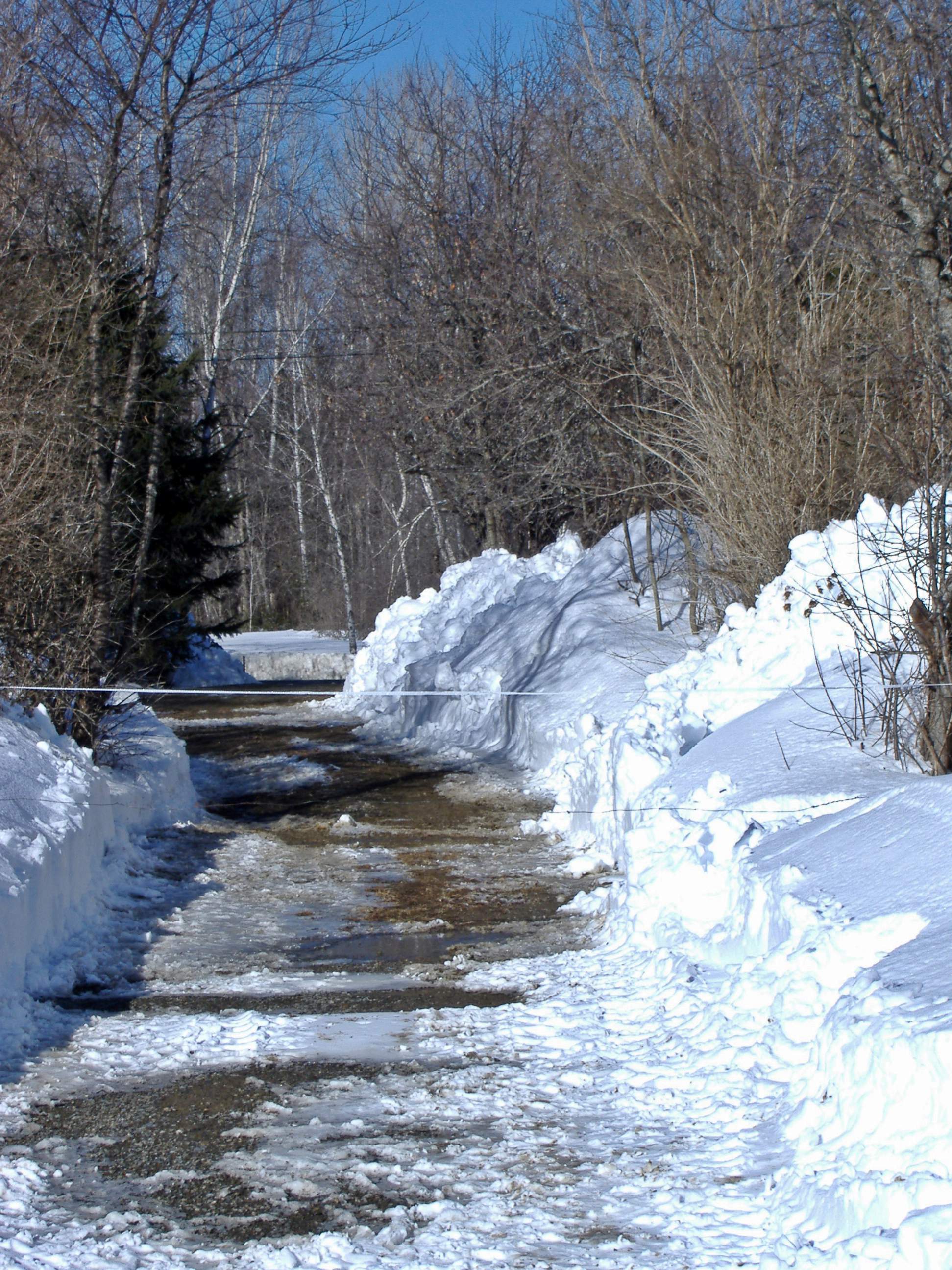

I plow much more than that with my 30 hp tractor. In my experience I cannot push snow 150' with the 5'bucket or 7' snow plow. The snow builds up and gets too heavy. The tires will spin in place - all 4, and the rears are loaded. I use chains on my icy driveway. Of course I always wait for the storm to be done before I begin to plow. I find the bucket faster than the plow, does a better job- scraping it clean. I make snow banks. The plow is handy, but I leave it off now.
If someone is planning to push snow- a pickup or a much larger tractor would be a better choice than a 30hp.
