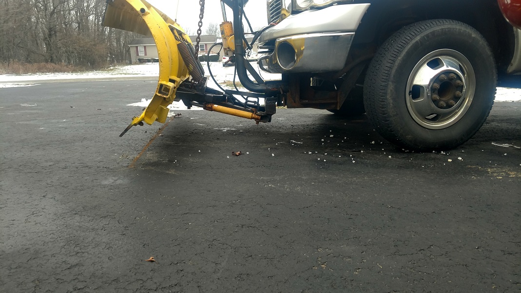

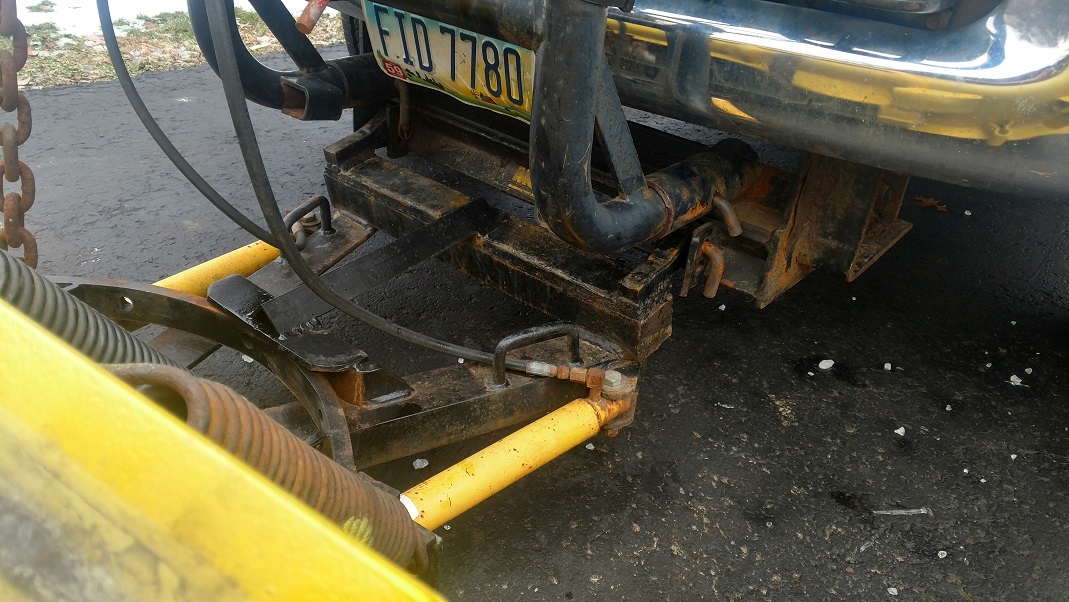

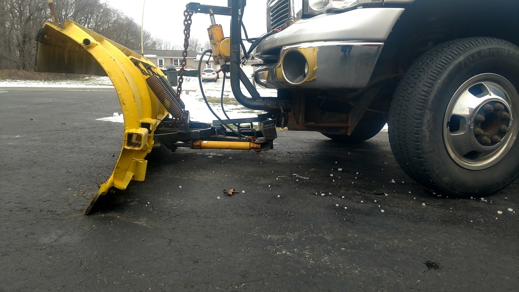

Here is my meyer plow on the truck.
I took some measurements, and the issue with meyer, as I have said, is that where the sector meets the plow is only 7" off the ground at the center line of the pivot pins.
The pin CL is ~1" above the bottom of the sector, and the a-frame is under that yet. End result is with a level plow.....just a tad under 4" of ground clearance on the underside of the a-frame.
In this configuration, the pin height would need to be in the 8.5-9" range. I raised the pins on this plow 3" because my bottom holes on the truck are at 10.5, and the top are at 12. This is with a new cutting edge and I am running the top hole to get a level plow.
But all of my modification is irrelevant. The a-frame is where it needs to be for a level plow. And when raised....still only ~4" of clearance at the a-frame right under the pins. Which you can see hoe easy it is to glide over a parking block, and get hung up.
If the plow were unmodified, and the pin height as per factory spec, the a-frame would be on a downward angle, 3" over its 31" length. (5.5 degrees) With a 10' plow, on full angle, that translates to about a 6" height difference between leading edge and inside edge of the plow. And progressively worse as the edge wears. Pin slop takes up a little bit of difference, but not enough. And the result is not scraping clean on the inside edge of the plow.
On my old ST7.5 on my chevy, it had a longer 38" a-frame. So a few inches translated into less angle. bout 4.5 degrees for the same 3" difference over its 38" length. And being a shorter plow, didnt magnify the issue over its length as much. The same 3" a-frame difference, would only be ~3.5" difference at the plow ends when angled fully. Usually not enough that plow wear and pin slop couldnt account for.
I am really thinking about either modifying the plow to be like yours, in that it pivots. OR have even considered slotting the two existing holes in my mount, so instead of two holes centered at 10.5 and 12", it would just be a slot from 10.5 to 12". Then I would consider removing the 3" spacer I have on the plow

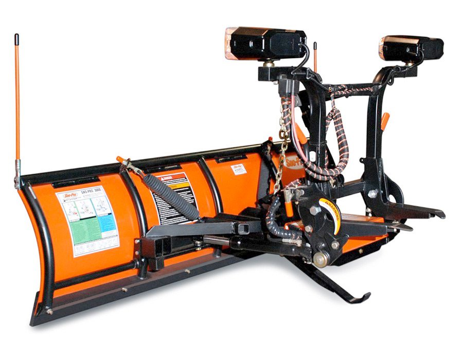

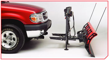

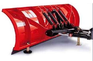

Even meyers new "lot-pro" plows are pretty low
Look at how high western, boss, and curtis are
The higher the mount pins that attach the sector to the moldboard.....the more leverage the cutting edge has over a full trip plow, and stiffer springs are required. Trip edge plows can be mounted higher.
Almost like meyer should have put the a-frame ABOVE the sector.......:rolleyes:
