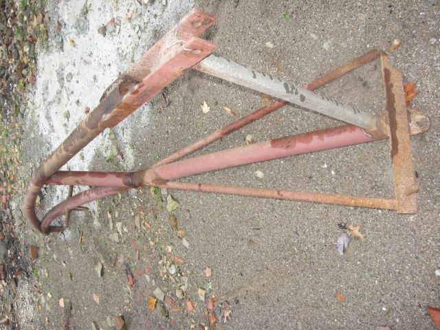

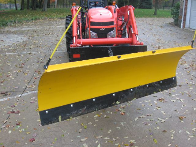

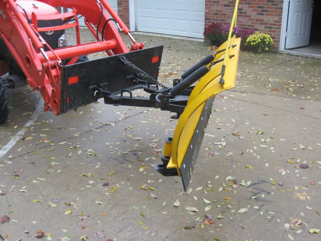

I want show off my new plow that I bought off Craigslist last night. It,s a Meyers 6 1/2 foot with a manual angle(no front remotes yet) on a SSQA plate.I've been looking to build my own but I found this for $600 so I went for it. Hope I didn't do to bad.
Also went to an aution and picked up a boom pole for $12.50 and 2 ratchet binders for $8. I want to adapt the boom pole to the loader.How'd I do?

Yea, looks great.

You did good!

Not too bad considering its good condition.

Looks good, you could have that power angle for just a little extra money.
Just need the cylinders some hose and hook it up to your curl circuit QDs, since you don't need the curl cylinders with the chain set up.

I see that 71Bronco has a chain for added support I am not sure if mine needs one, what do you think? I have a hook near the swivel but believe the rotation would twist the chain. Do you reattach the chain when you manually turn your blade?

Your blade is fixed to the adaptor plate. his is pinned so the chain is supporting the front/ weight of the plow.
His plow will float over the contour of the ground with the loader arms stationary.
With yours you will have to engage the float feature of the loader valve to allow the loader arms to move up and down with the plow over uneven terrain.
JB.

I was trying to just find a plow on CL with the thought of buying an adapter plate and welding it up solid untill I found this one. I never thought of hooking it up like this but I think I'll like it better this way. It does stick out quite a ways though and I think I'm going to need some ballast. I have a 55 gal drum to fill with concrete and add a few goodies like a receiver hitch,Chainsaw scabbard,places for chains and gas and oil. I will also put in some pipe for hand tools. Do you guys think that is enough weight for a 3240? I'll probably fill all but 4 or 5 inches of the barrel. Any other ideas?

I also started welding on my boom for the loader. I mounted it to the receiver hitch on top of the bucket and it rests on the lip on the bottom. I'll take some pics if anybody wants to see it.
