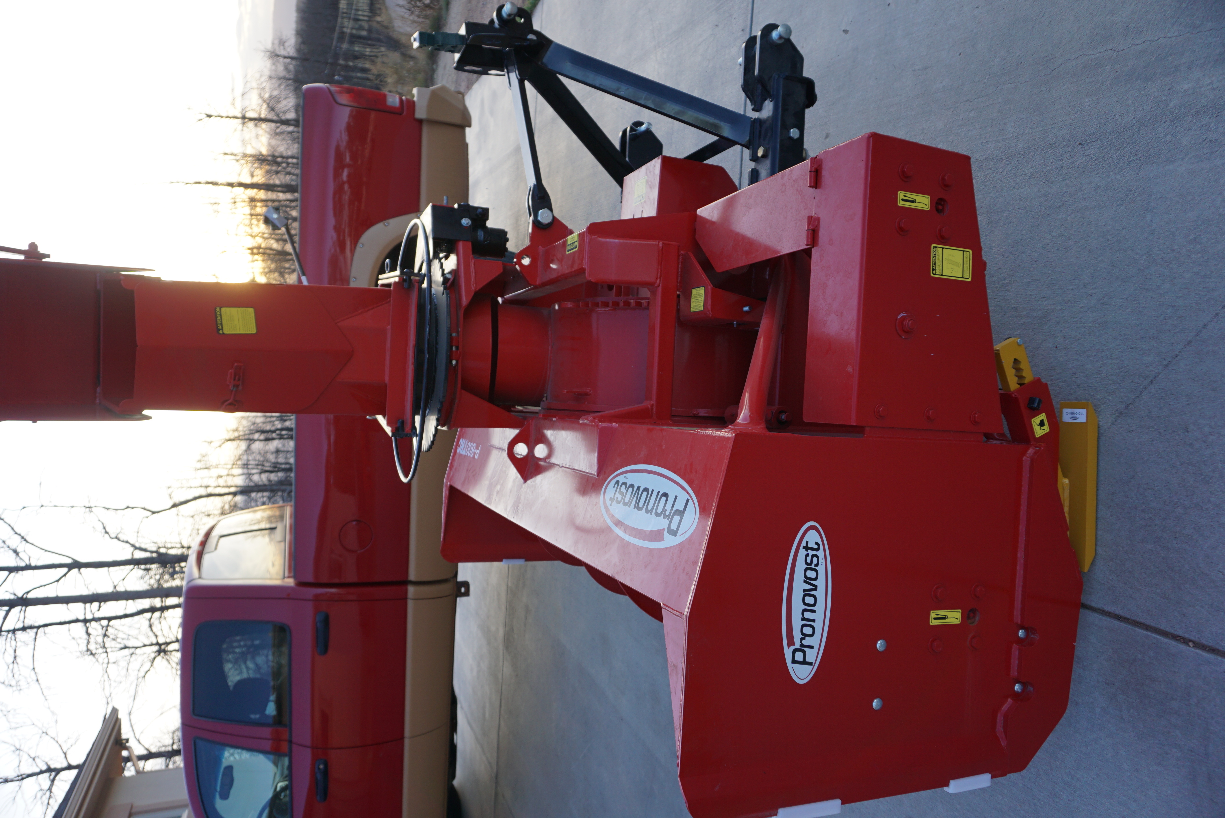

Recd my new Pronovost 800TRC yesterday. Holly cow this thing is a beast. Pronovost also appear to be experts at packing all the loose parts for shipping. Everything was tetris'd into the auger and tied in place with heavy wax lacing and zip ties. It took me an hour to get all that stuff out of there. You definitely had to be patient and hold your tongue just right to get it loose.
So as I go through this, ill post my experience with it and how it goes putting it together. It came without the 3 point pieces attached to the frame so those were the first thing to go on. Makes it much easier to move around. I pulled it off the flatbed with a bobcat and it was tricky. It has two lifting eyes on top but the chute kinda gets in the way for easy lifting. Made it work though.
First thing I noticed about this thing is that it is **** heavy and everything is thick steel. The internet pics do not do this thing justice. I have seen posts where folks have questioned the value of this thing being worth the extra money. Just in shopping for a snow blower and looking at everything from landpride to Schulte, I have to say this is the beefiest snowblower I saw. I didn't see an Erskine so I cant compare there. The other thing I noticed was that this thing is huge. Its an 80" working width but height of the housing and height of the chute are huge. Maybe its cause I'm used to garden tractors with small blowers on the front. But even compared to Kubotas snow blower that's nearly the same width, this thing is huge.

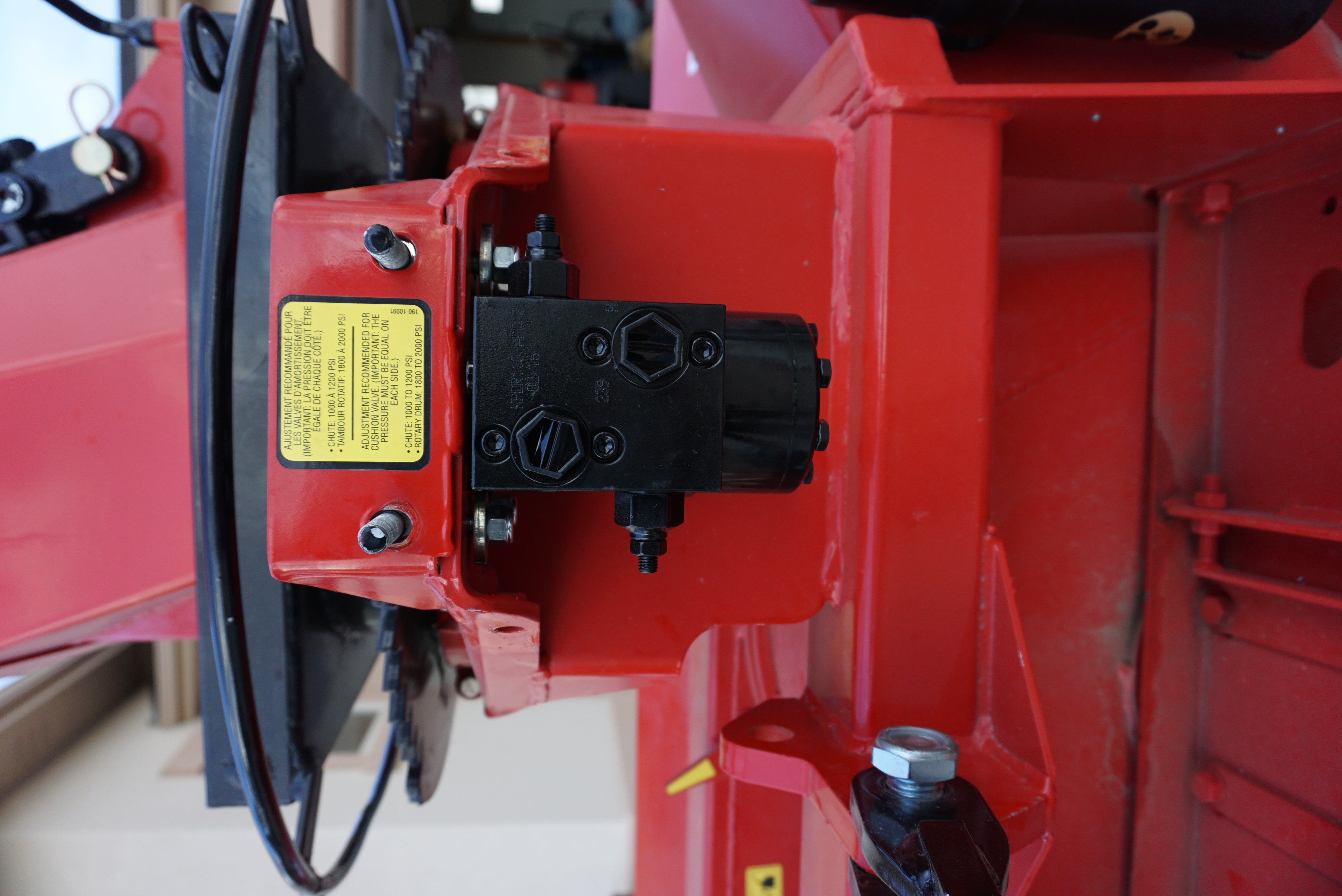

Things of concern so far: Mine has hydraulic chute rotate and discharge angle, and because its a TRC it has a hydraulic chute rotation for side discharge. The two orbital motors were not installed at the factory. Kind of a nit pic but why wouldn't they have just installed them and set gear contact depth? Another nit pic is that when you buy it they tell you up front that you have to have hydraulic lines made. Many hydraulic implements state that the customer has to do this due to the many differences in tractors and equipment match ups. Not that big a deal, but my grapple came with lines... Tractors running rear snow blowers aren't THAT different. Lastly the instructions, or lack thereof frustrated the wife to no end. Nearly everything is going together from internet pictures and the parts diagrams in the back of the book. I'm a mechanical guy and have a full shop and do all my own maint to a bunch of equipment and vehicles, but sometimes there's value to torque specs and sequenced steps. I'm not asking for Ikea level idiot proof with a single allen stock but....
Its a beautiful day today so ill try to shoot some happy snaps of putting it together.

Heres a shot Ill post more as it goes together.

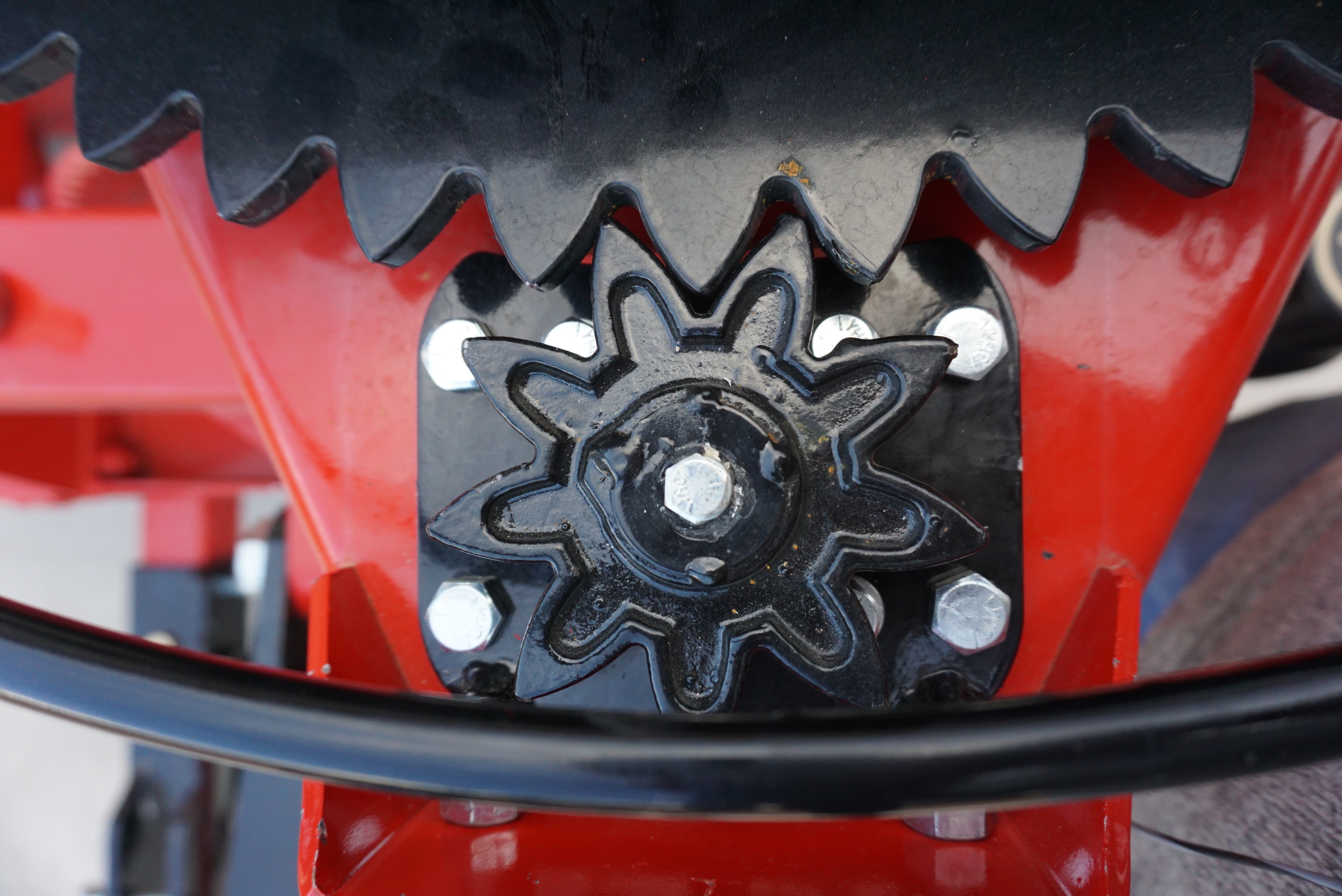

Bob, could you upload some more images of the rotating drum and the chute gearing and the hydraulic motors??
I do not remember if the TRC units have a chain drive to rotate the impeller drum if the unit uses a chain drive both sides of chain on either side of the hydraulic motor must be tight to avoid the chain skipping and falling off
The gear on the hydraulic motor that is used to spin the chute has to be tight as well but not so tight that it binds.

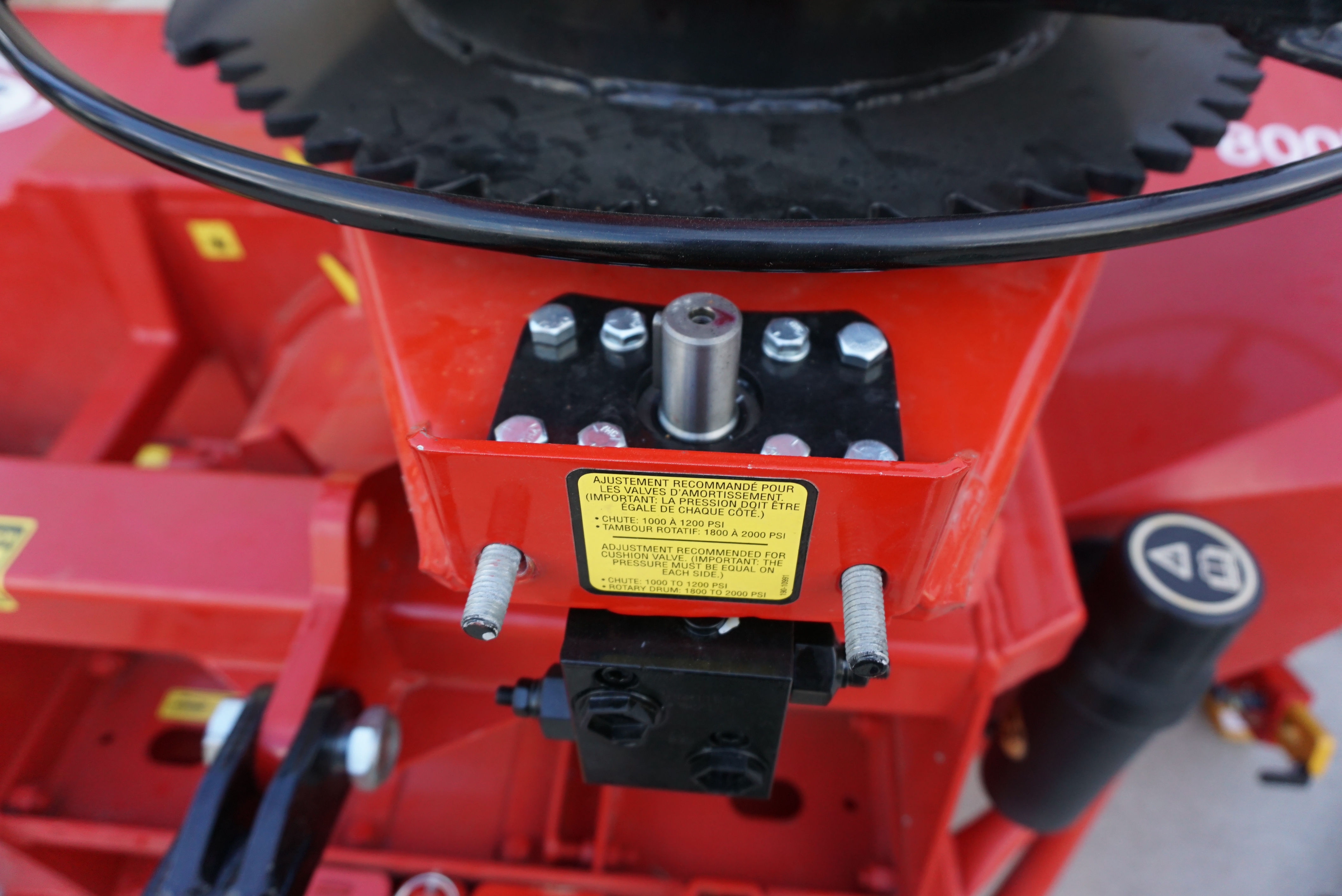

Bob, you may or may not have the same cushion valve on the chute rotation motor as my p-74-inv but be careful as the valve i have uses a very shallow thread depth and my initial hoses were set up with a more standard fitting and i damaged the valve. Pronovost was super cool and helpful in replacing the part. They are very good to deal with and the blowers are really well made- i would have loved a trc inverted blower but no such thing at the time

Leonz, Thanks for posting that but most of it doesn't apply to my blower. The chute rotator I have is a direct drive hydraulic motor to the chute. The one in the manual you posted is cable driven from a ram. Adjusting it is relatively easy, its a nice design with the adjuster plate and bolts. How far in or out to adjust it is another issue though.

Heres a shot of the motor with the gear in place and the position of the motor under the mounting plate

Hello Bob,
I went through the manuals again last night and all the Pronovost manuals that have the hydraulic rotation option are shown in the specific exploded diagrams.
As the chute rotation hydraulic motor is bolted in place it has no adjustment other than replacing the gear or the mating gear on the chute.
There has to be a little gear "backlash" movement to allow the sprocket to mesh with the chutes replaceable gear teeth section.
You need to call Pronovost in Quebec or the dealer you purchased it from as that hydraulic motor may require B.S.P. hydraulic fittings with B.S.P. (British Standard Pipe O Rings with the blue stripe).
The BSP hydraulic fittings allow more adjustment of the hydraulic fitting to allow them to be connected to steel or two wire hydraulic hoses.
