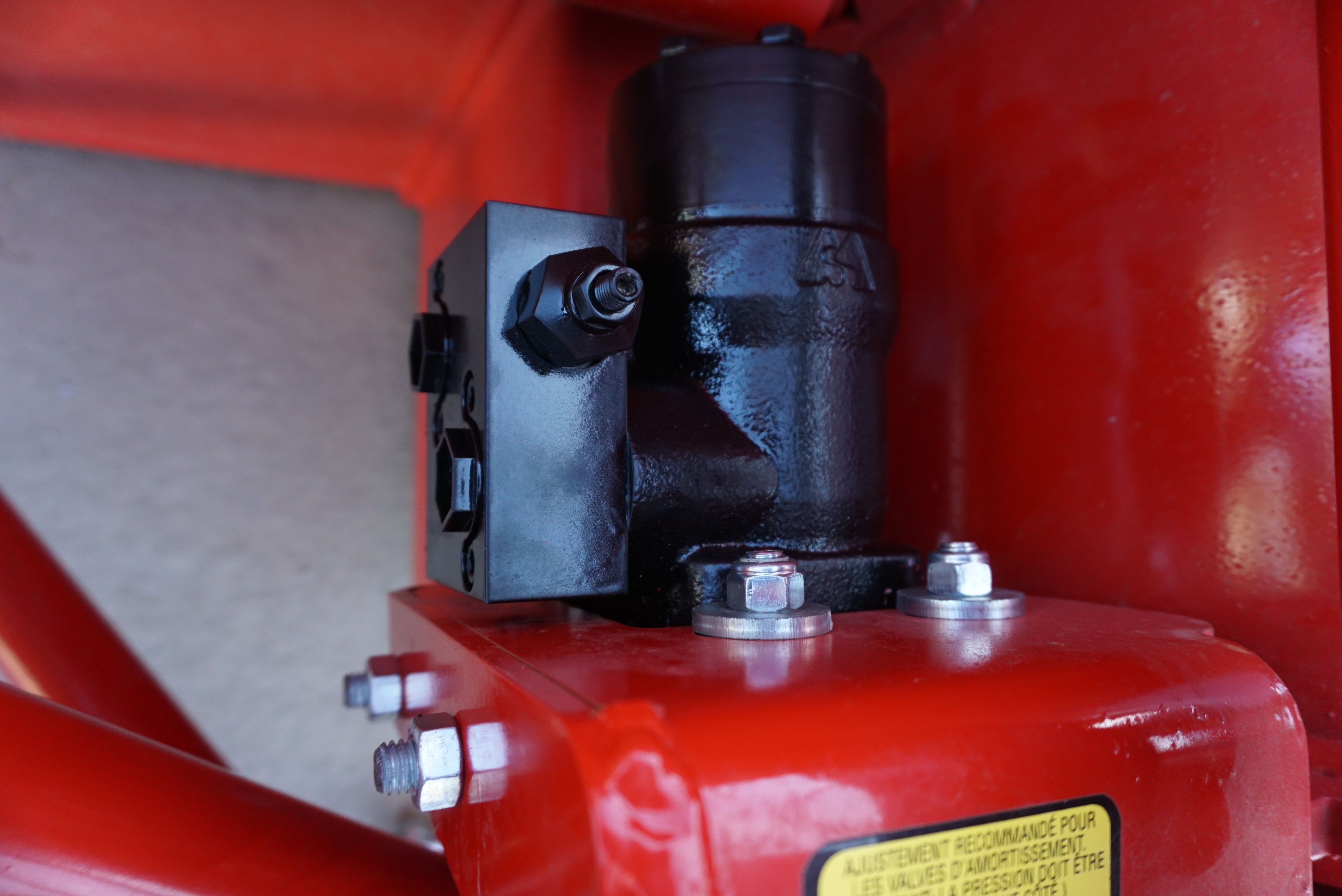

Hello Bob,
You need to call your dealer and ask them if the cushion valve was adjusted and set at the factory.
If he cannot tell you it was pre-set at the factory you must assume the directions on the valve must be followed to set the cushion valve pressure using a flow meter or the test gauge port on the cushion valve body itself
The thing is if the cushion valve was not adjusted you could break the gear tooth flange that rotates the chute and the impeller drum drive chain if it is not correctly adjusted with the hydraulic system at a hot oil operating temperature of 120-140 degrees.
The pictures are lousy but the exploded diagrams and parts numbers are very easy to read and examine.
The Pronovost snow blower group manual that I uploaded to TBN and sent to you via e-mail is the resource you need Bob.
Every model they make except for the motorised snow caster for rubber tired backhoes and front end loaders is in that complete manual.
If you have not done it already you should use some blue Loctite on the nuts and bolts especially for the hydraulic motors flange mounts unless they have used nylock nuts for everything.

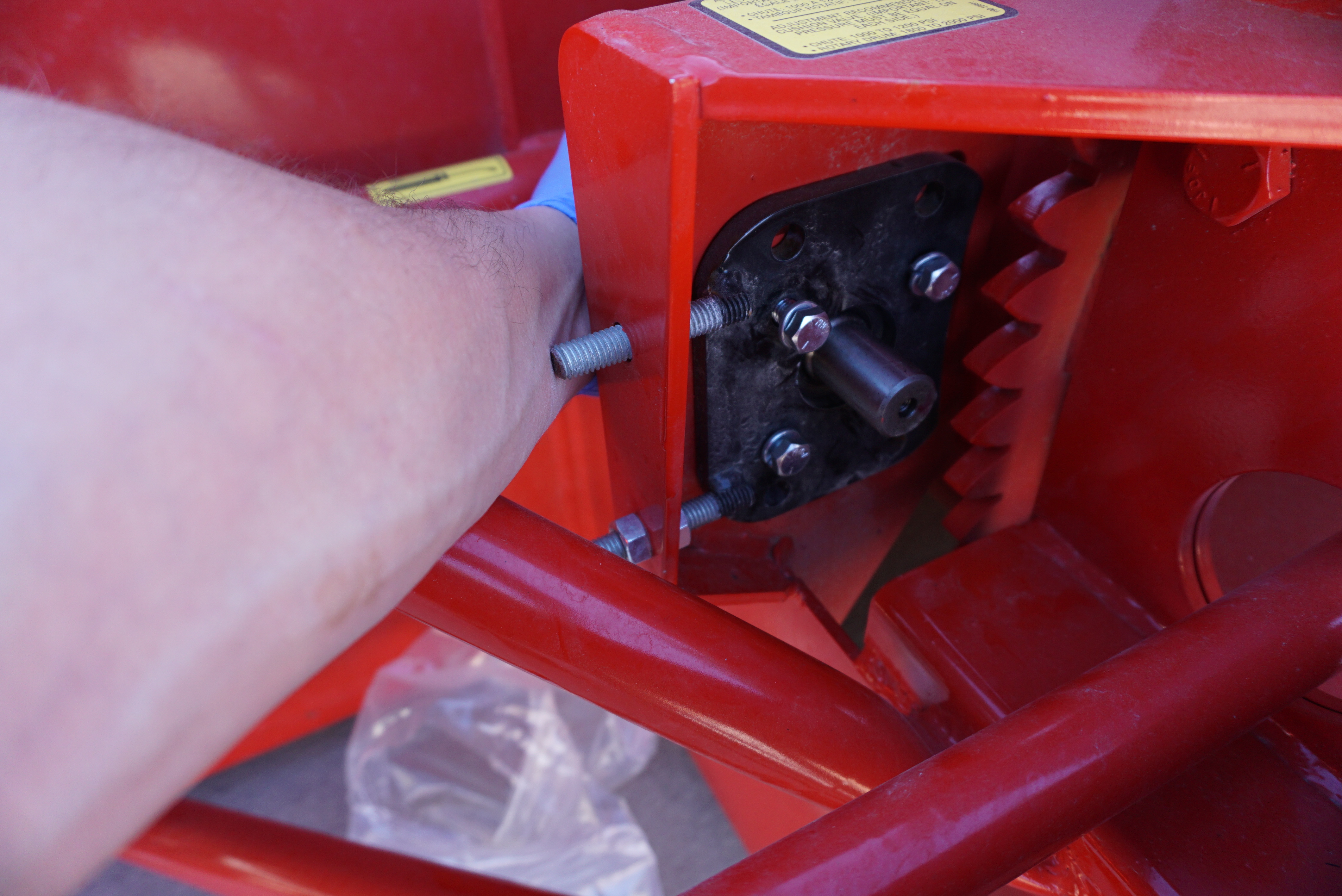

Mounting the hydro motor for the TRC chute today. Quick note: It can only go in one way. Ill show you why.
The motor and the shaft for the auger drive live behind this cover DSC01676.JPG
First thing to do is remove the adjuster plate and install the other adjuster nut. In this pic you'll notice I have the motor installed and the second adjuster nut is not on. Learning has occurred. Then you can bolt the motor to the adjuster plate.
The motor can only go on one way: with the hose fittings facing the left. If you orient them in any other way the securing bolts wont go in. More learning.

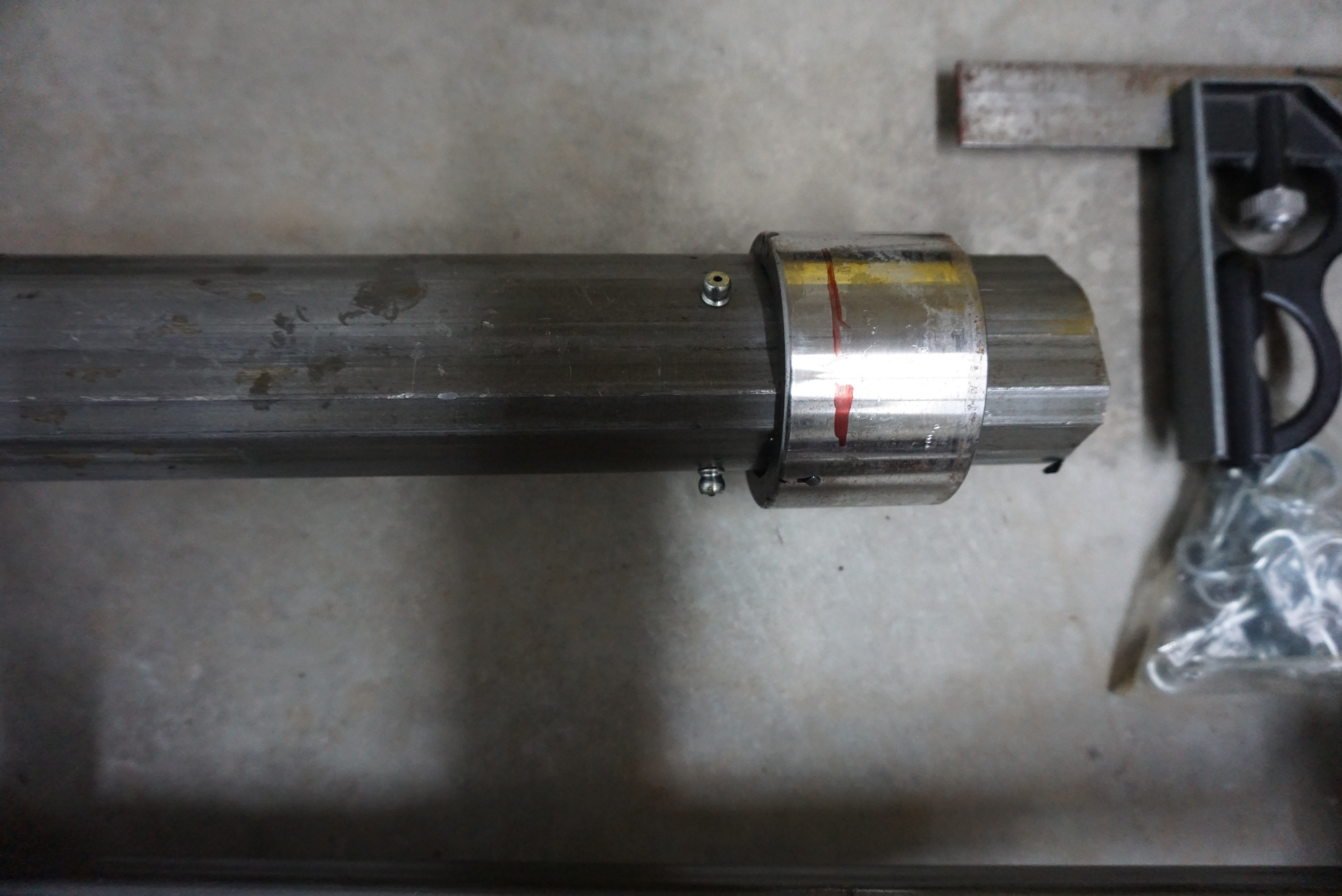

My tractor is back from service, while there I had them add 1 more remote to the rear. Shoulda had all three installed when I bought the tractor (more learning). The 800TRC needs 3 rear remotes: chute rotate, chute discharge elevation and the TRC rotate.
Later today Ill attempt to mount the snow blower and get the PTO shaft cut to the right length. Intention is to get the thing spinning under tractor power today. Ill get the hoses made up next week and get pics of the routing and hoses I use. Dealer suggests 3/8 hoses.
