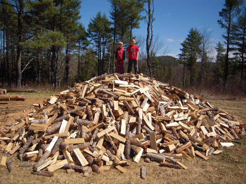

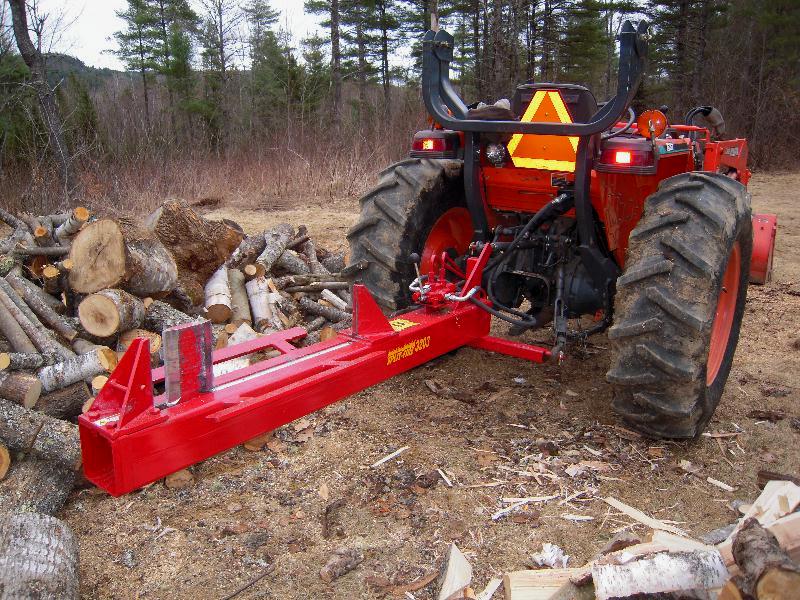

Congrats on your new toy!
Piston, you may recognize these from FF. :)

Hey Piston, I got it through the local Massey dealer, Northwood Power Equipment. They did the plumbing as well. The distributor (here in Maine at least) is J.S. Woodhouse. I'm trying to figure out if the 4-way head is an option for me or not. I don't 'think' it is for this model, if memory serves.

I don't think the 4 way is an option either. What about checking with a local fabricator? Maybe he could make something up based off pictures of the split-fire 4 way? It does seem like it would greatly improve the splitting efficiency.
There are a couple of differences of note that make it difficult but not impossible to upgrade to the 4 way model.
Look at the abutments at both ends there are two triangular wedges welded at each abutment about a 1/2" behind the primary abutment surface. These pieces keep the wood on the splitter once the 4 way wedge starts working.
The other primary difference is the carriage assembly that the wedges ride on I assume you could probably cut/grind the existing wedge off and Weld on a piece of bar stock like the 4 way mode l. I assume split fire would probably sell you the 4 way wedge. You might even try contacting them to see if they would sell you an upgrade kit thank includes the carrage assembly with the 4 way wedge and retaining pin and the 4 pieces that are on the abutment.
