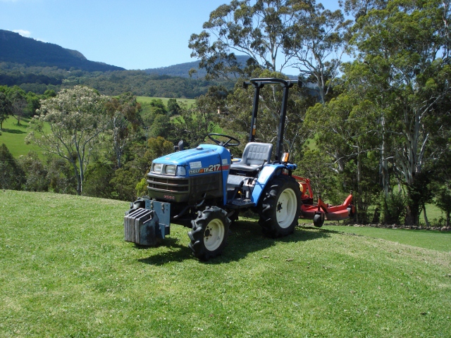

I used some 3/8 plate and a bracket to lower the weights and extend them forward .. tried to lower the center of gravity
That Bolens looks better than new!
Thanks! Thats a great looking Iseki you have too!! I really like the idea of lowering the center of gravity, and that is a nice ROPS set up you have too. It looks like you have quite a bit of acreage to mow. What model is the tractor? Is the landhope version?
/ New suitcase weights for G154 #12

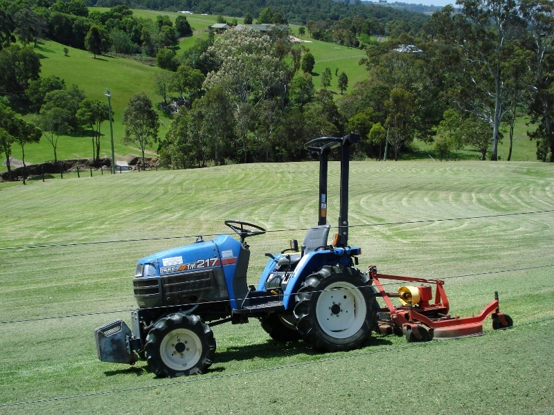

That ROPS is not that practical! It has side tabs for attaching a sunshade .. was going across a slope once and hooked the ROPS on a tree, ended up on its side. Its a tough little machine though, two rollovers have not done any harm. Its a TM217 .. 900hrs and not one problem.
Wow, thats wild, I'm glad that you, and the tractor are OK after both roll overs. I guess thats probably why they changes the design and made the model that I have that has a curved top, so I guess a branch would slide off better, hopefully. That is an amazing tractor that you have! It looks like you get a ton of time on it mowing your fields!, very impressive! Thanks for the photo, how many HP does that have, is it a 17hp engine? Thanks for the photos!
