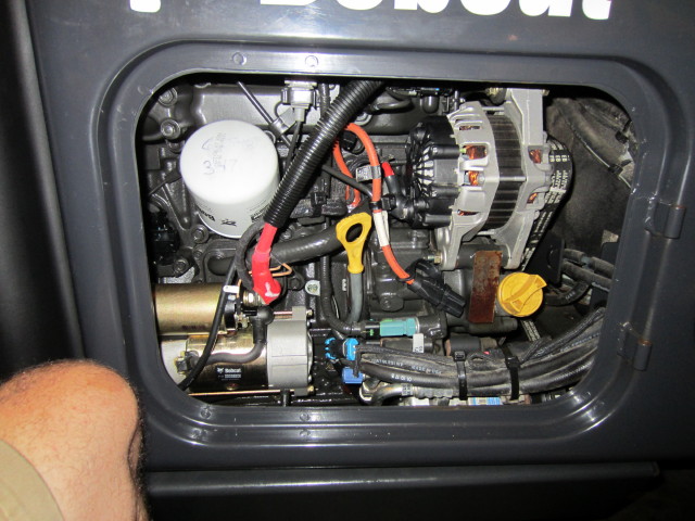

I would run #2 with additives and keep a couple of cans of treated #1 around. If you know you're going to leave it outside in -40F throw in the #1 run it until all the fuel is mixed, then plug in your block heater an hour or 2 before you're going to use it.
DEWFPO
   / New TC owner with questions about security code and winter fuel. #6
DEWFPO
Good point about the block heater. The new toolcats have a Doosan engine that uses a "dry pocket" block heater. That means you don't have to mess with the coolant or freeze plugs and is a easy DIY job. It is well worth having in cold weather.
