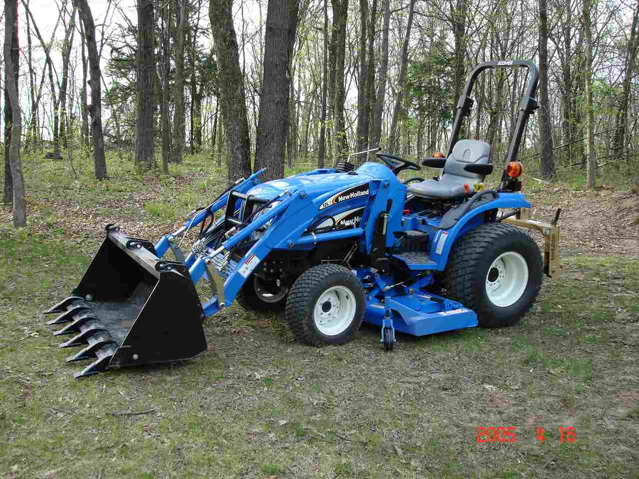

This picture shows the 60"MMM, New Holland toothbar, and armrests.

Compact1,
Whats the story with the armrests? Part #, etc.? Option?

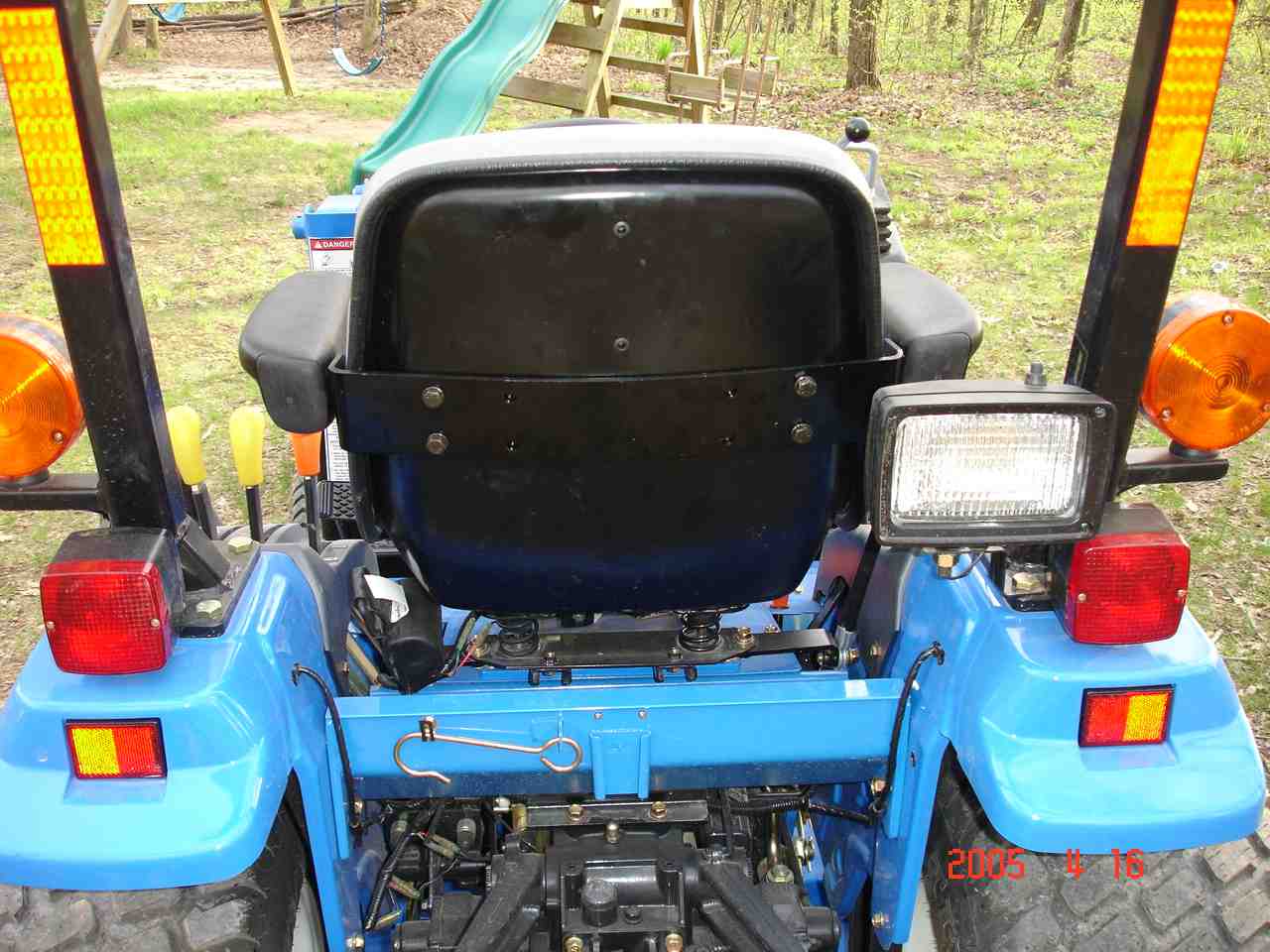

Are they cool or what? Apparently my dealer didn't write down the part number on my paperwork but they were obviously an option. The MSRP was $75 but I was able to get them for $60...and they fold-up out of the way!
I attached a photo of how the bracket connects to the seat. Sorry for the poor quality of picture.

Jeff,

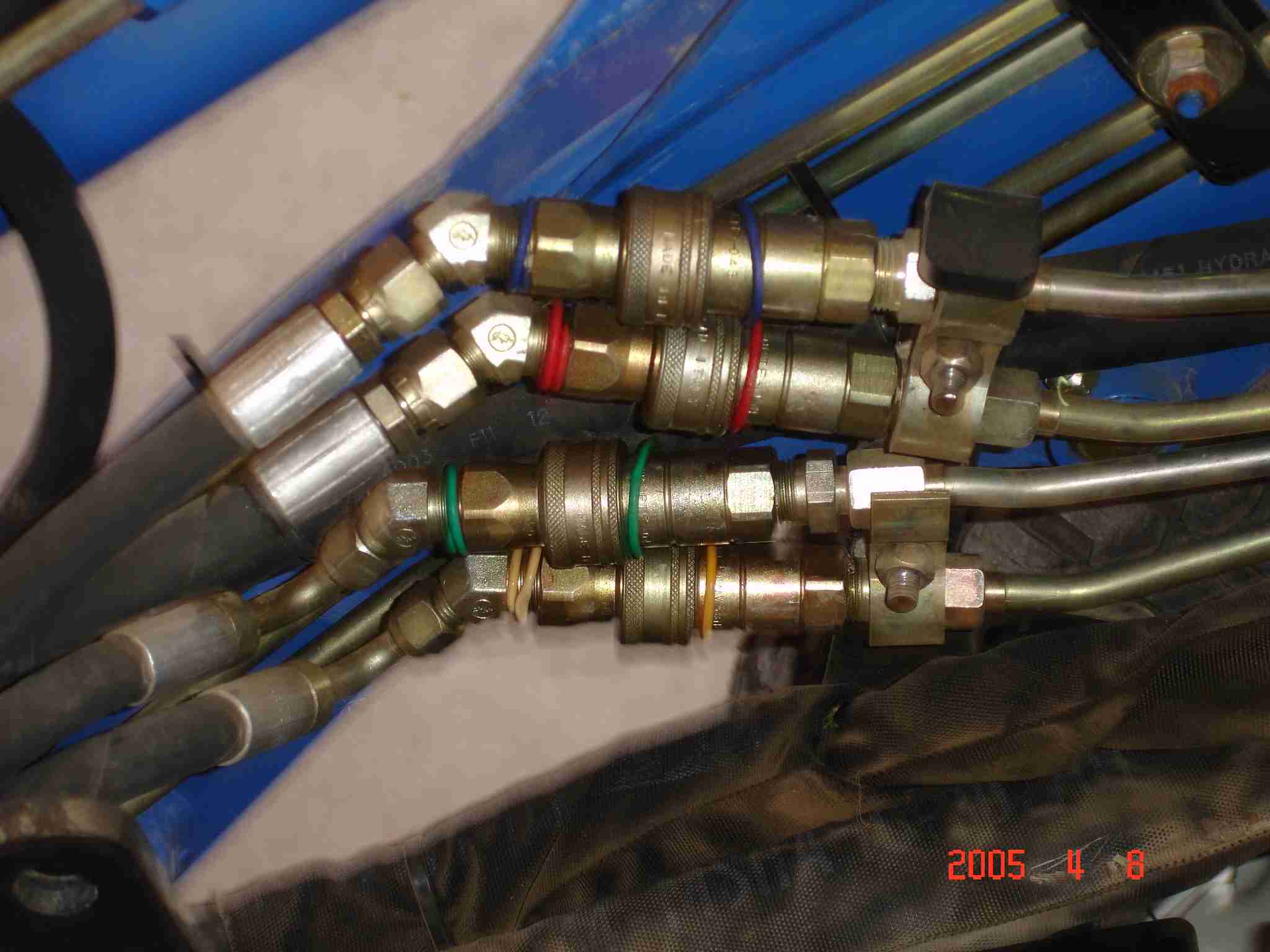

Thanks for the info on the armrests. I'll be looking into them, they would be nice for loader work! After seeing pics of your grille guard, I went out the next day and ordered one. No, kidding on being heavy! I was wondering if you could post a pic showing the detail, say from the right side, showing the hydraulic connections for the loader. I changed a couple of fittings on the yellow and green lines from 45 to straight because everytime I needed to connect them, I had a rough time. I wanted to see how your dealer set yours up.

Joe,
My FEL fittings rubbed the hydraulic hoses when the tractor was delivered so I fixed the problem myself. I left them connected, loosened the swivels, and turned them in the appropriate direction. Now they don't rub anywhere when I move the FEL. I also had to re-route the hydraulic hoses so they didn't interfere with my grill guard.
Let me know if you need another picture.

I just use a bunje cord and wrap the hoses around the stationay brace. This way it stays off the front wheels.

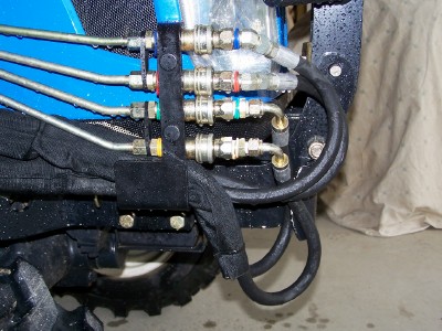

Thanks for the picture, you had the same set up I had. Here's a couple of pictures of the changes I mad. Like I said, I change the 45 fitting on the green and yellow lines to a straight one. No more twisted, rubbing together fittings. Much easier to plug-in and unplug! As you can see, things are wet from just being hosed down. Had a storm come through and rut up the driveway. BTW, I changed my display name to Mega_Me.....it's what the guys at the firehouse call me....long story!
