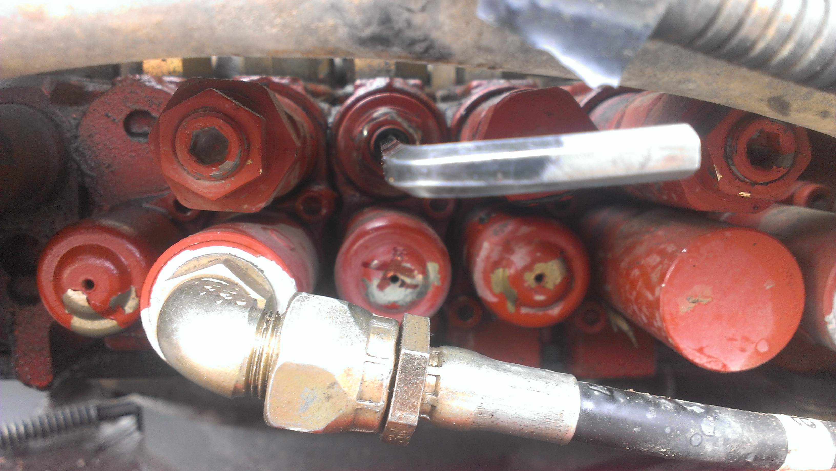

Hey Mike,would you happen to have the description of the valves on the first picture. I don't think that I have relief valves after all. The Allen screws that I'm adjusting does turn down pressure to the thumb but they don't hold pressure. I'm thinking about the cross over relief from Princess Auto that was suggested??? Thanks.

I would like to see a picture of the relief valve. I am pretty sure mine has a cross over relief valve near the base of the main boom. Its quite a large unit but I have purchased cross over relief valves from Princess auto for other projects and they where not $250. PA has a 10GPM Poppet style for 99 bucks.

So the allen key is what I adjusted and it does turn pressure down but wont hold. I think the cap below it is the spot for a relief. To the left of where the allen key is what looks like a relief for another circuit and I would say this is what I need.

Here's the description of what each valve is in picture 1 the aux relief Is #5 it should have hoses a6 and b 6 going into it
To adjust it you loosen the jam nut and and tighten the Allen screw to raise the pressure and loosen the screw to lower the pressure than tighten the jam nut again

This is what the Takeuchi dealer sent me today. I'm thinking this is what I need??
Steve, here is what I found on thumb kits. #12 is a overload valve. I have two in stock @ 171.87 It shows only using one in the kit. Hope this helps
