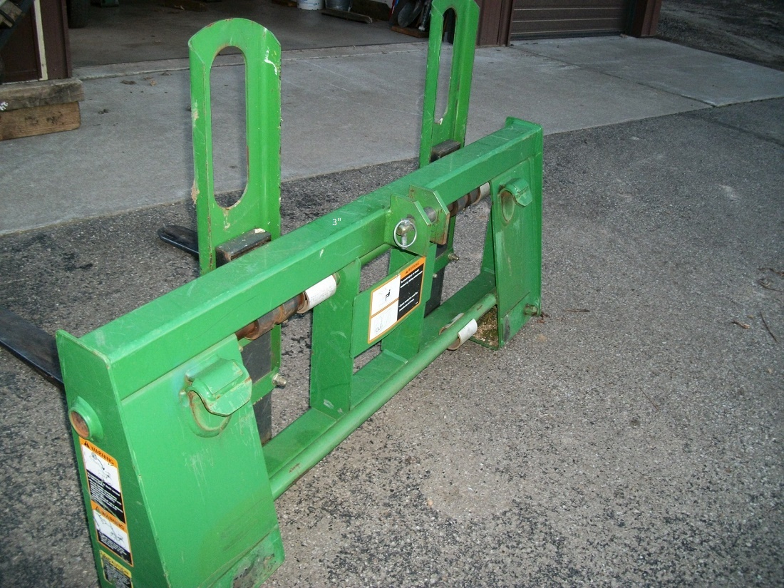

I bought a tiller (Shibaura RS 3147, also sold as Yanmar) for a song and a dance. I've ordered a new driveshaft and clutch. But lo and behold, the draw pins are set much closer together than I need. I have located "extra long" draw pins (6-1/2" long) but even those are not long enough for me to attach this to my quick hitch. It looks like I need more like 9"!! (Yes, I know what you're thinking...) Yes, I will add bushings to reduce rattle in the quick hitch, but I need to solve the length issue first.
I searched through the forums unable to find a post related to this problem. Does anybody have any suggestions or resources? Photos attached should convey what I'm grappling with.

Have not looked at all the suggestions
But just weld one length of the right diameter round stock across the bottom to be picked up by the lower quick-hitch hooks.
Looks like a walk in the park.
Did that on my forks to be able to pick the forks up with the 3 pt quick-hitch (iMatch) and it works great. Pic shows welded round stock added.
Do the same for your tiller.

Unfortunately, the "rear end" pumpkin is in the way. It will require bracket extensions that stick out in the forward direction toward the tractor before the lateral piece of round stock can be welded in place. If I end up going that route I'll add some length to create more distance between the tiller and the tractor.
