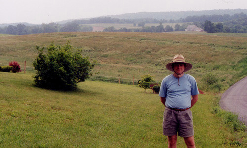

There isn't much difference between my lawn and my pasture. Prior to my purchase, all 7 acres was used as a hayfield. About an acre of ground was disturbed during excavation/grading operations related to the construction of my house and 175’ driveway. This area was reseeded with TSC Horsemax mix (a grass/clover combo). There are actually parts of my lawn that are identical to the pasture. I guess the big differences would be the presence of more weeds (not woody brush) and abandoned woodchuck holes /forums/images/graemlins/frown.gif in the pasture. The pasture grasses also tend to be coarser and have thicker stems. The woodchuck holes are a nasty hazard, so I’ll be marking and avoiding them (whether I’m mowing or not) until I can get them filled in. The lawn is nearly as bumpy as the pasture. In the attached photo, you can see what happens by Memorial Day without mowing (note that I am standing on the neighbor's property and my house on the hill is not present because this is a preconstruction photo).
