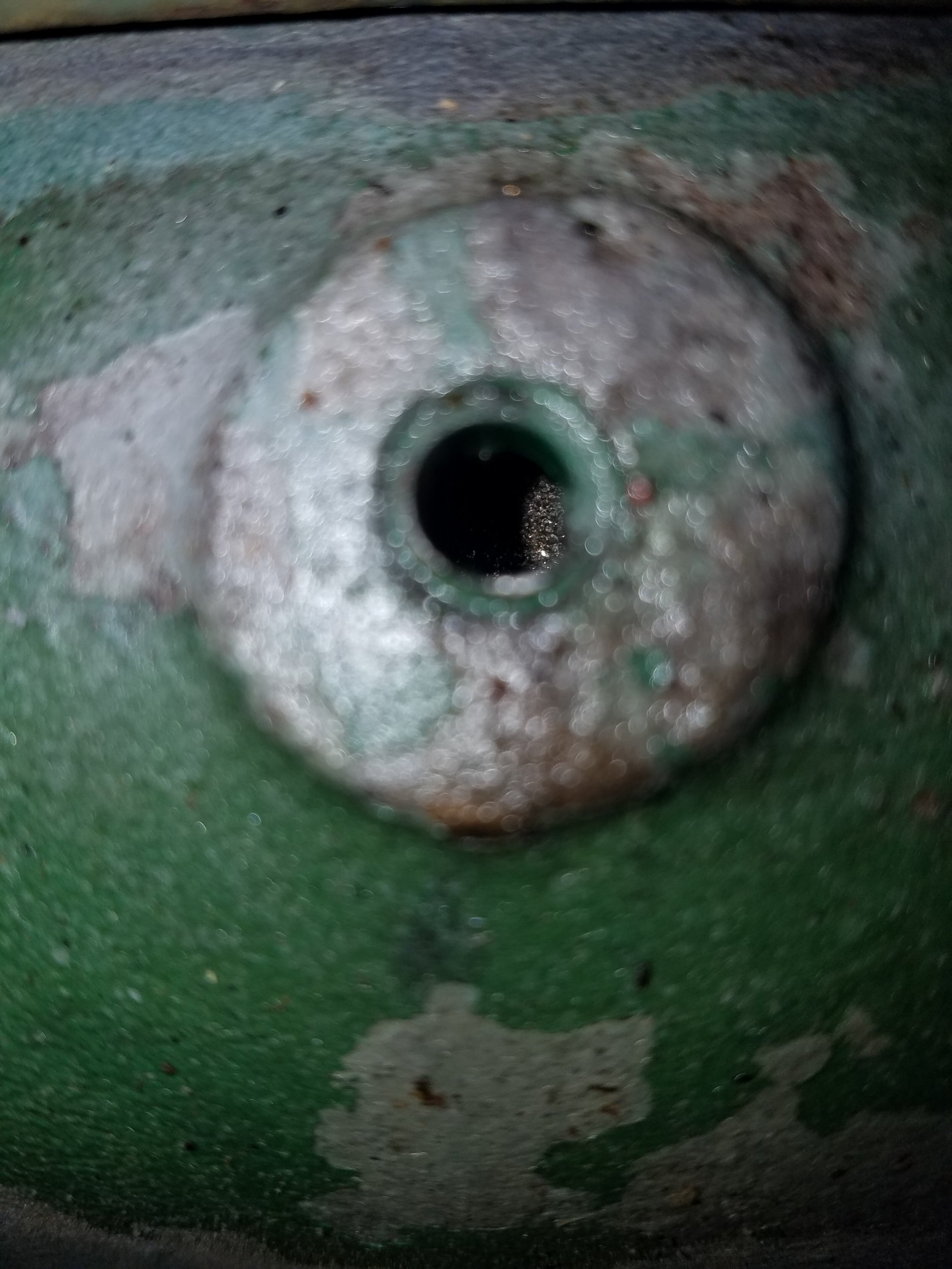

Don't know whether under or over?? Have you made sure your transmission vent is open? (On top of the rockshaft)
   / New to me 2210d
#52
Need to... guess I'll walk over there now....
   / New to me 2210d
#53
Well good news and bad news.... it's open but it's also too open...
   / New to me 2210d
#55
At some point I'll work on getting the old one out n go from there.... kinda hope it's threaded as that might be easier to remove..... unless it's harder lol
   / New to me 2210d #56
It's threaded. And an easy-out should remove that ... easily!
See if Hoye has the replacement. It's common to replace them. People think they can attach a tow rope there. Nope.

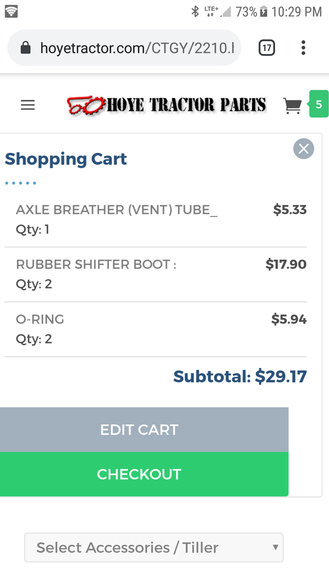

Good deal... winston was kind enough to link the replacement above
   / New to me 2210d #58
The tube is Part# AB-42280 Repl. #1941150.42280 to many models to list apparently. Fredricks has a few 1000 I'm sure.
