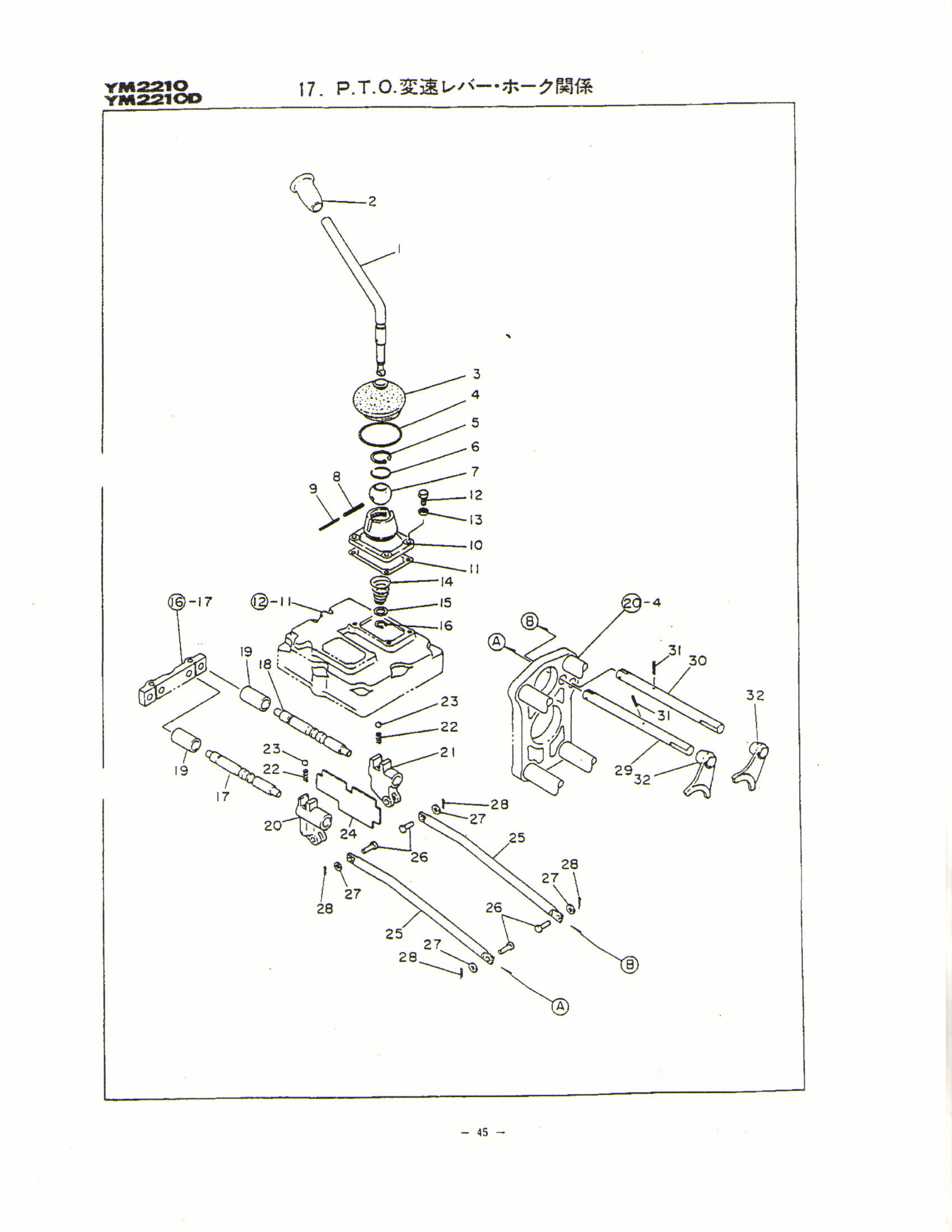

What do you guys think of this....
Hydraulic oil coming out past the pto shifter while driving... pto engagement status doesn't matter...
Fill level is perfect according to the dipstick...

   / New to me 2210d #48
Is this o-ring missing? O-RING
#4 on drawing
   / New to me 2210d
#49
Hmmm dunno... will check
Is that supposed to go over the boot?
Is it normal to have oil in the boot?
