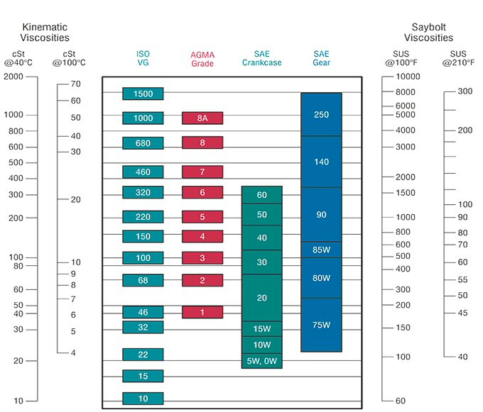

I would not underestimate the impact of oils that are the wrong viscosity, especially in a well engineered engine. Not only does it generate more work (if too thick), but it probably isn't lubricating as well as designed. 30W oil is quite a bit thinner than 40W oil, as in nearly half. (NB: The vertical scales below are not linear.)
Comparative oil viscosities

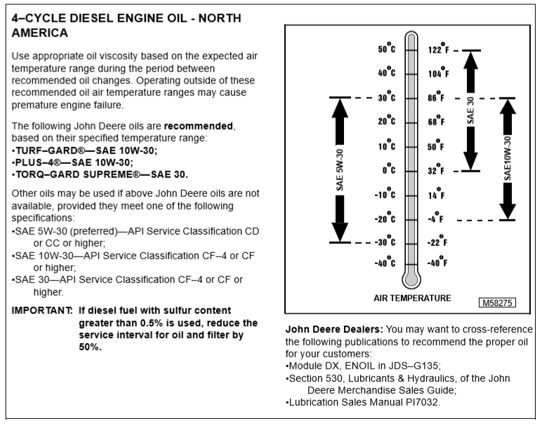

From the John Deere info on the 50 Series (aka Yanmar YM Series)

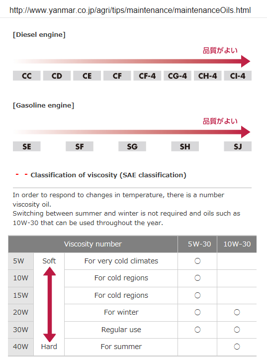

From the Yanmar site
Yanmar RS - AF Series oil info. Using engines like the F & FX Series based on the YM Series.
