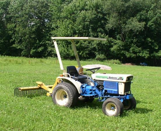

Bolens iseki h152
image.jpgJust picked up a new to me H1502 bolens. this tractor seems to be in great condition for its age. One thing I have not seen but on my machine is that the chassis is blue most I have seen are black. I bought the machine with no accesorys with intentions to turn it into a loaded tractor with a previous loader that I have. I'm kinda scared of parts breakage and parts avaviblility but the machine is in such nice shape I'm
Sure it was well maintained.
My question is how are the hydro rear units on these machines should
I be scared of using it to hard?

I purchased my Hydro 1502 in 1986 , ,have extremely steep hills to mow and have never experienced any issues yet with the drive system .I have never seen one painted blue but that doesn`t mean much . Good luck ,they seem to be a nice economical little machine .Parts seem to be available but are at a premium price where available .

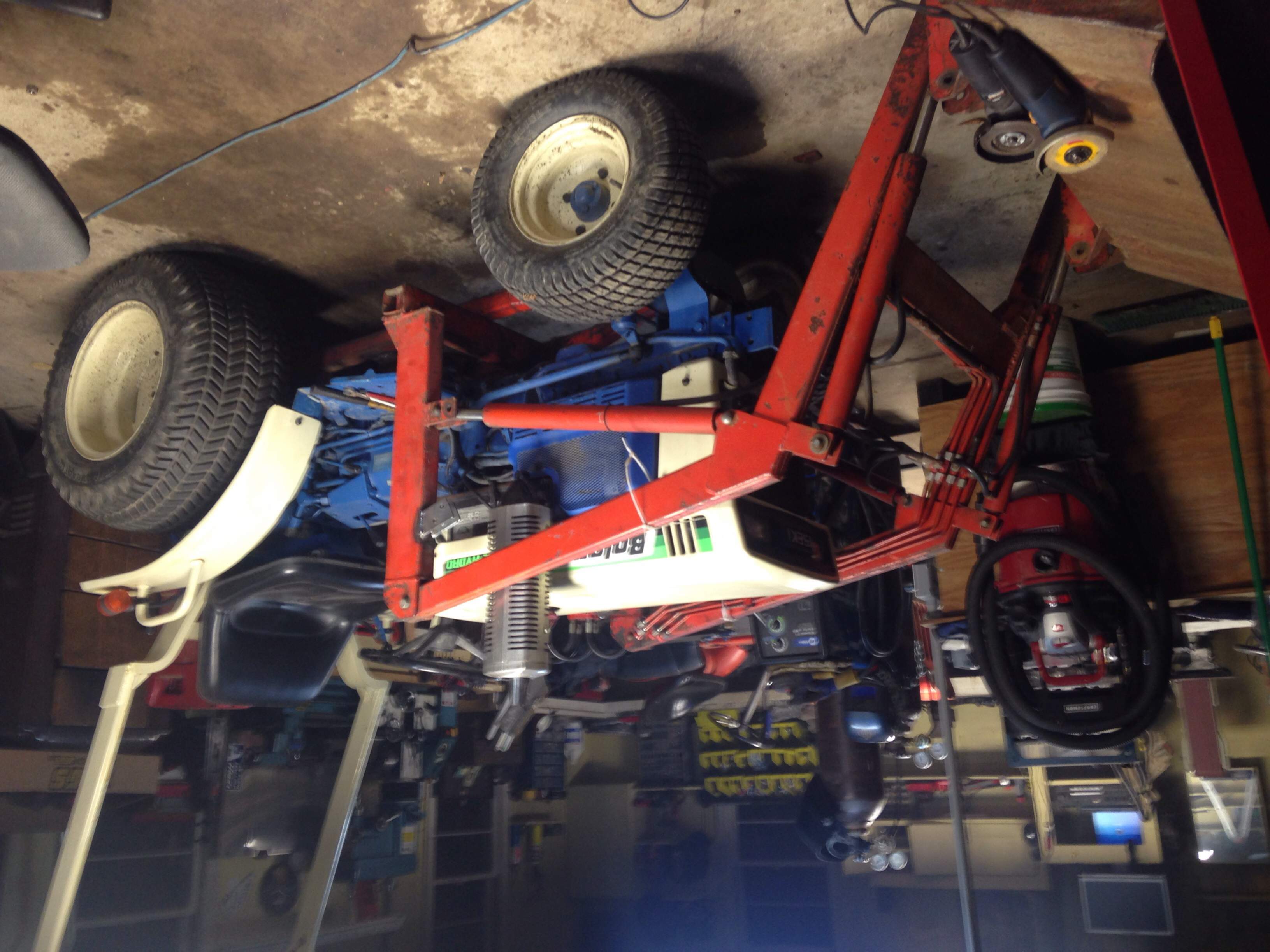

Thanks guys I hope to have it operational by the first snow here. I hope...image.jpg
