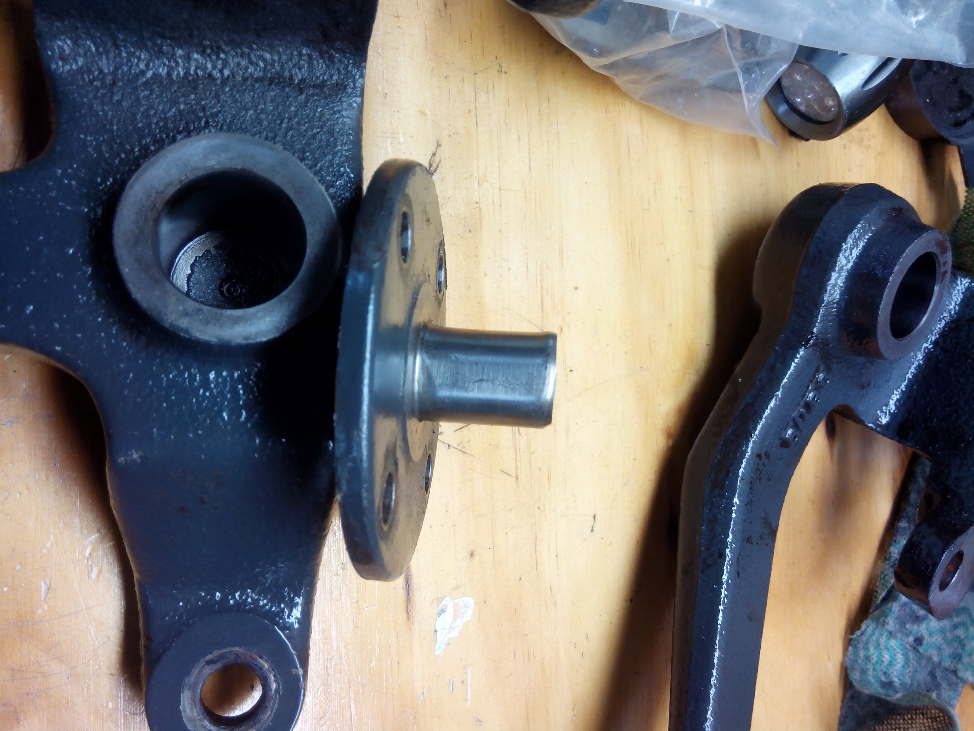

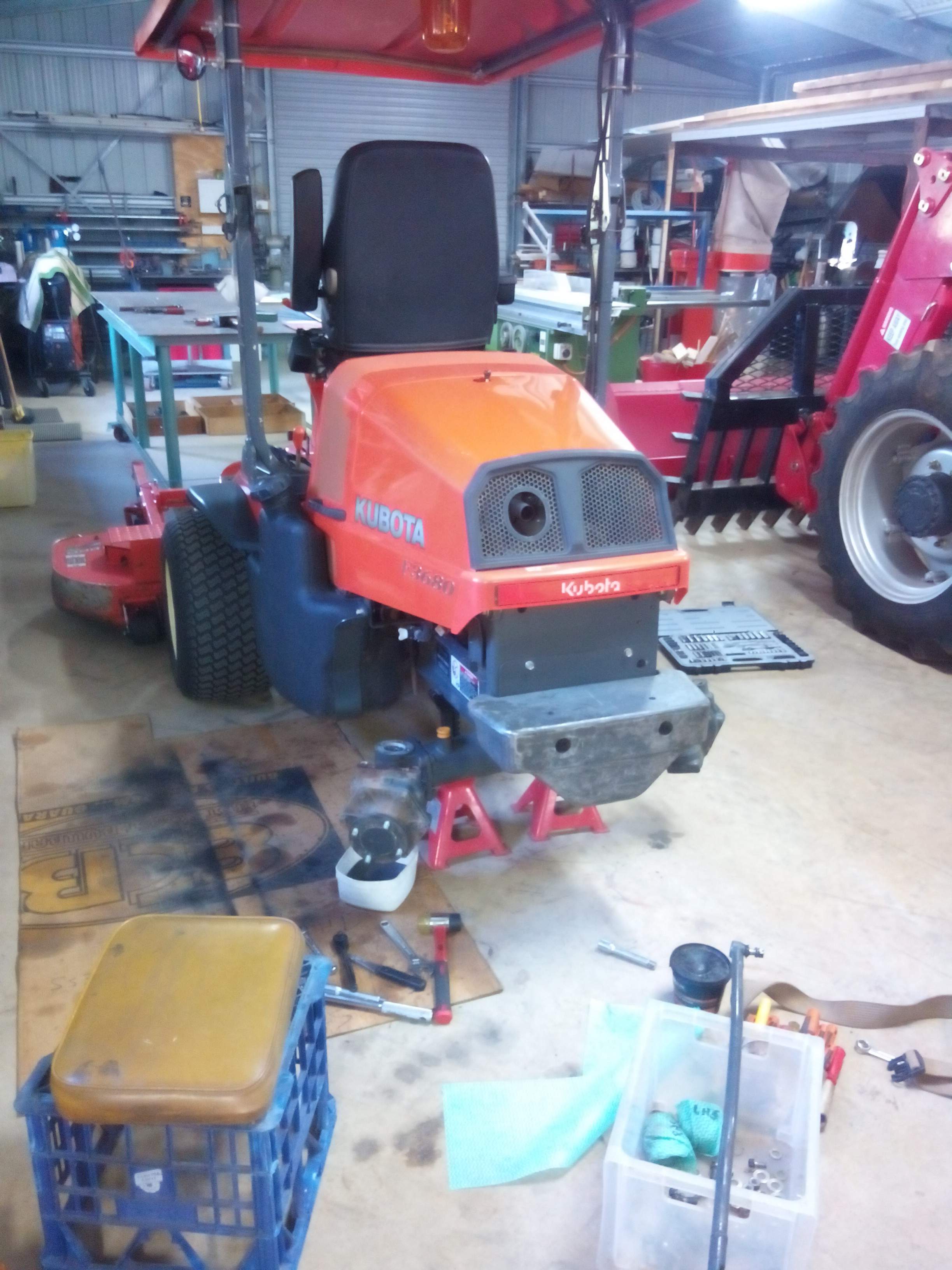

I will have a go at attaching a photo of the steering knuckle wear. I guess the amount of wear for the machines total hours would depend on how and where the mower was used and maintained. Mine is an ex local government machine which are "supposed" to be serviced properly but I have found plenty of signs of inadequate maintenance on this one so I will just go over it and fix what I can. It is in pretty good shape overall though and just hope all the internals and major components are OK. The environment it was used in may have needed lots of maneuvering as well.
If you have a copy of the Workshop Manual the rear axle steering parts I am working on are in section 5 S-12 and it is the steering knuckle bush and support. It is a plastic bush which rotates on a 20mm steel pin. The RHS support pin on mine is worn down to 19mm and the bush out to 21mm so leaving a 2mm or about 1/12" amount of slop. The other side is less at about 1.5mm or 1/16" slop, so both sides far in excess of kubotas specs max allowable limit of 0.4mm. So yeah, a little job to do. I also found my steering ram to be loose at the fixed end so no wonder the mower was wandering around a bit.
In the photos I have shown the support pin wear and secondly the old bush sitting on the worn pin.

The rear counter weight on mine is just what seems to be pretty standard around here on the mowers with 72" decks. Don't know the weight of it at this stage but I am guessing around 40-50KG or around 100lbs. I was thinking too that the cutting action of the blades spinning clockwise if you are trying to throw the clippings uphill away from the water or whatever would be encouraging the mower to slide down hill as well which wouldn't be helping the crabbing action. Anyway I had better get off and try and order some parts..

I'm surprised Kubota would use a nylon bushing in there. Okay on a Barbie Jeep, but not on a commercial mower. I wonder if you could have an oilite bronze bushing machined to fit? I'm surprised the pin would wear too, with a nylon bushing.
