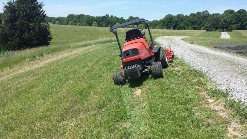

One othe thing. I have started mowing my steep hill from lower left to upper right and then next time I do across the other way and then across it and some times straight up and down . It feels more stable with the angle vs straight across it with no crabbing.I do believe your extra weights are having a gravitational pull of the back end down the hill greater than the drive wheels. Remove them and see. i

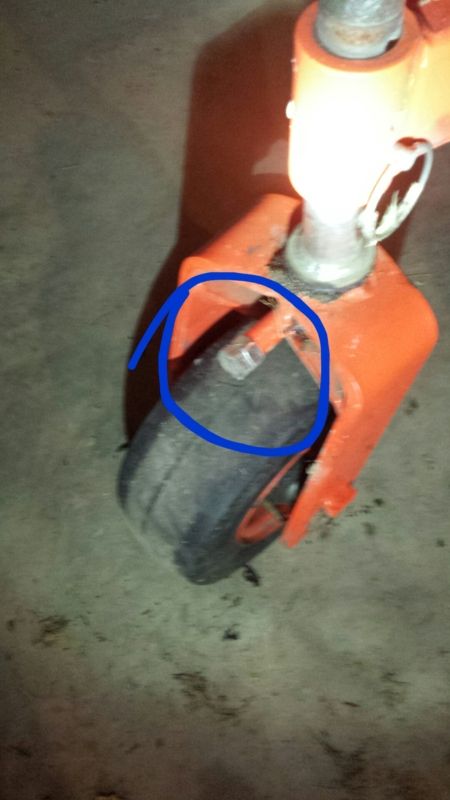

The deck is rolling on 4 wheels at the 4 corners. If your on anything but perfectly flat surface there is a probability ofat least one wheel being off the ground at all times. I have one of my front wheels doing the wiggle often and it will be the opposite wheel when I reverse direction. This will be more so with a bigger deck and one of the reasons some people want smaller decks on manacured lawns which I don't have. I have a yard, no lawn. My brother next door has a small deck Husquavarna riding mower and a manacured lawn. He lets me mow the steep rough gullied cliff in the back of his lawn.:D

As far as fine adjustments on the mower wheels are concerned, the only ones I am aware of, according to the manual, are where the rear of the deck attaches to the lift arms. Different washer thicknesses to fine tune leveling of the deck. My front guage wheels track straight, unless mowing my ditch where the front middle roller is holding the weight. I also found deck height adjustments to be a pain in the butt, but in reality I will probably just leave it alone now that I have the height set (2.5"). Anyone want to trade a 72" side discharge for a 72" rear discharge deck? I may give Messicks a call to see how much it would cost me to swap decks.

7. Not sure about that jamb nut but the wheel shafts have a notch on top that should face the same way. Do not remember front or rear.

7. Intend to open those nuts up....asked questions before I did so. Sometimes asking questions avoids me getting into something that I shouldn't, soooo I ask. You never know it all.
