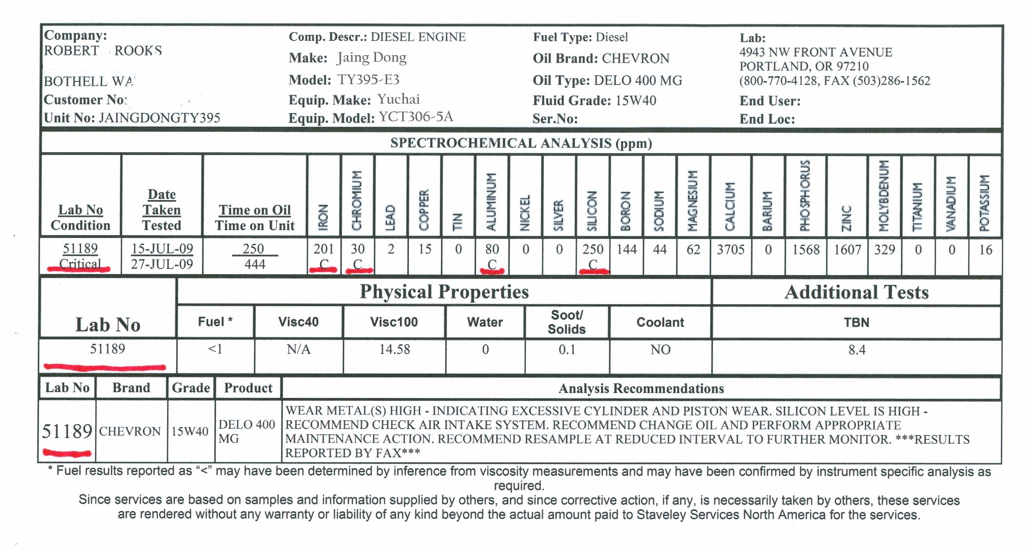

I have the NAPA squeeze bulb coolant/block tester that I use, but I just ran across this. Looks promising.
Almost any good oil analysis lab can test your oil, but be careful to use a reputable one. I use this one because they have a contract with Washington State Ferries and do all of our lube oil, fuel oil, hydraulic oil, gear oils, and coolant analysis. We run EMD, Cat, Waukesha, Detroit, and Cummins engines.
Here is my first report card during break in.
