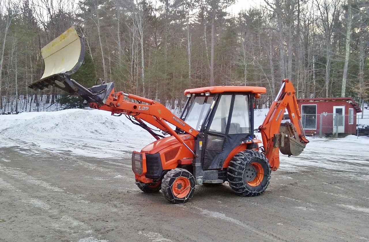

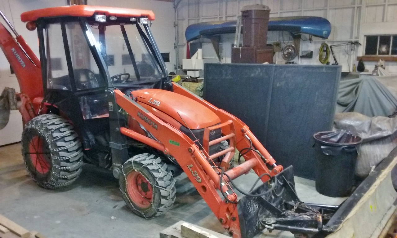

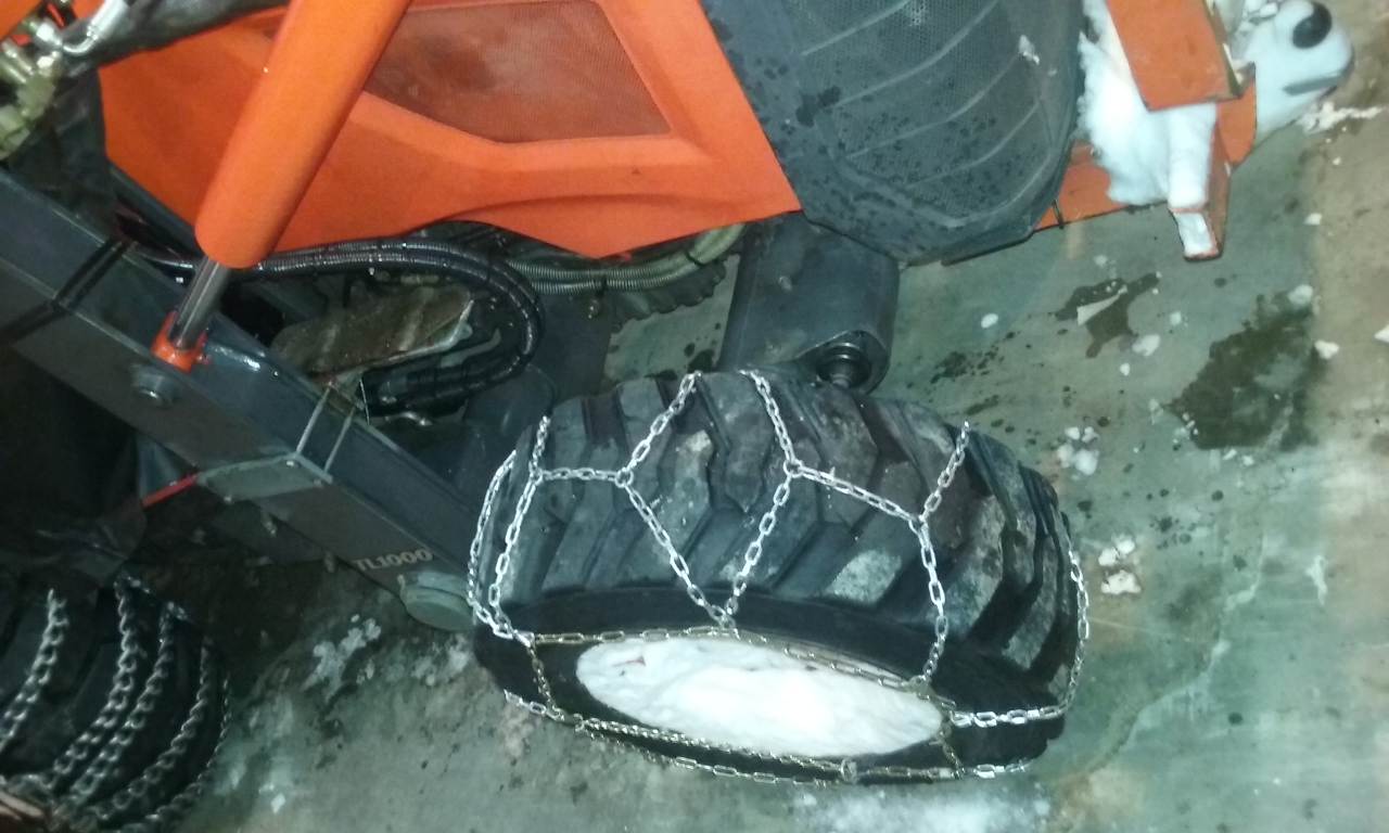

Would tire chains on front tires of M59 do harm to front end?
Big ones maybe will damage front axle over time, but I use Small Section ones on my L39 from Amazon, etc on the front.
These diamond-pattern link chain features shorter links to provide excellent all-around performance, and is made to be easy to install. It is better for on-road and off-road surfaces, steep grades, deep and packed snow, and icy roads. This chain provides Class-S clearance, and requires chain tighteners (included). I think you need Size WS-1705
http://ecx.images-amazon.com/images/I/B1AuiYOtblS.pdf
Amazon.com: Security Chain Company WS164 Whitestar Alloy Tire Traction Chain - Set of 2: Automotive

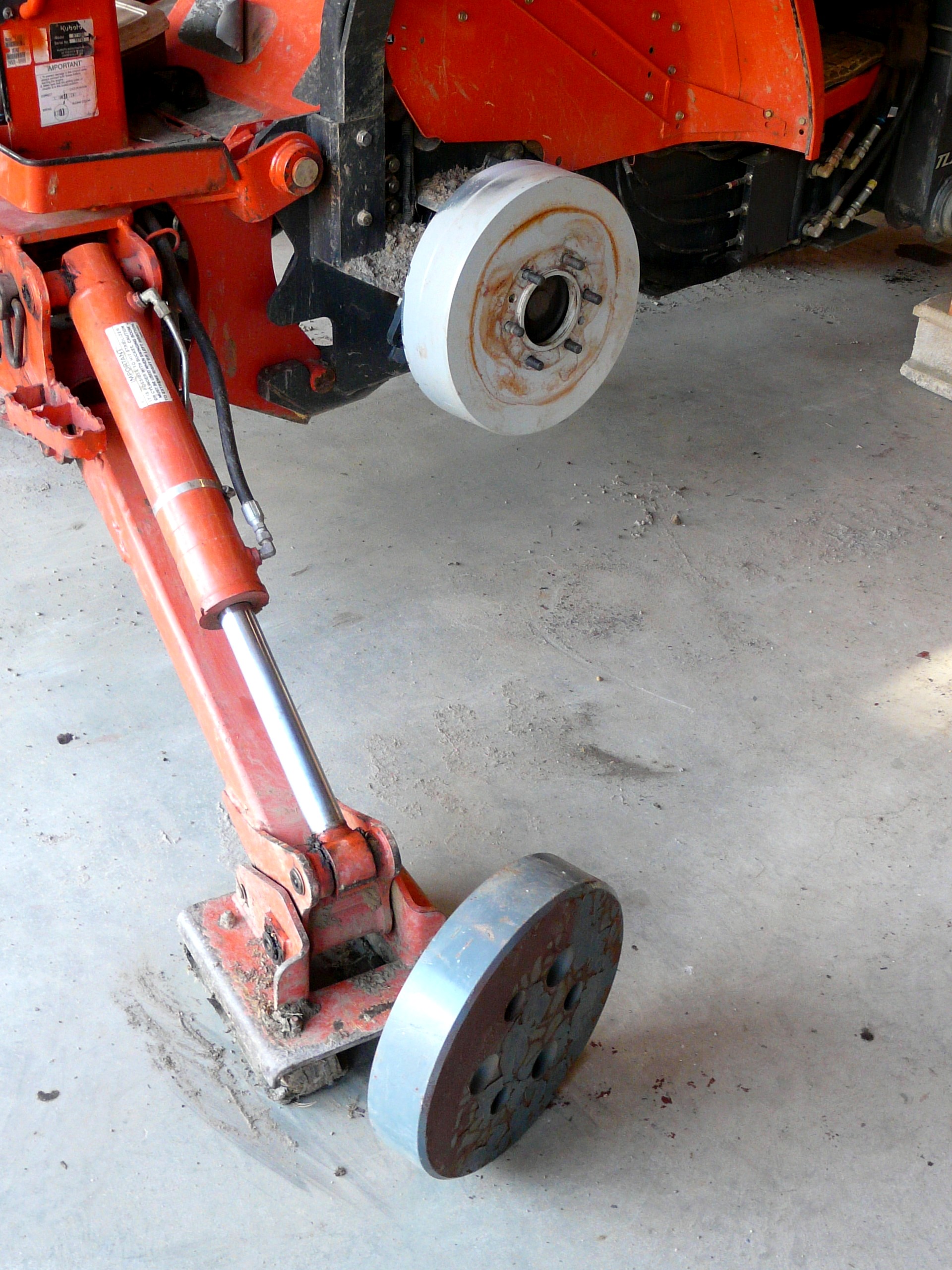

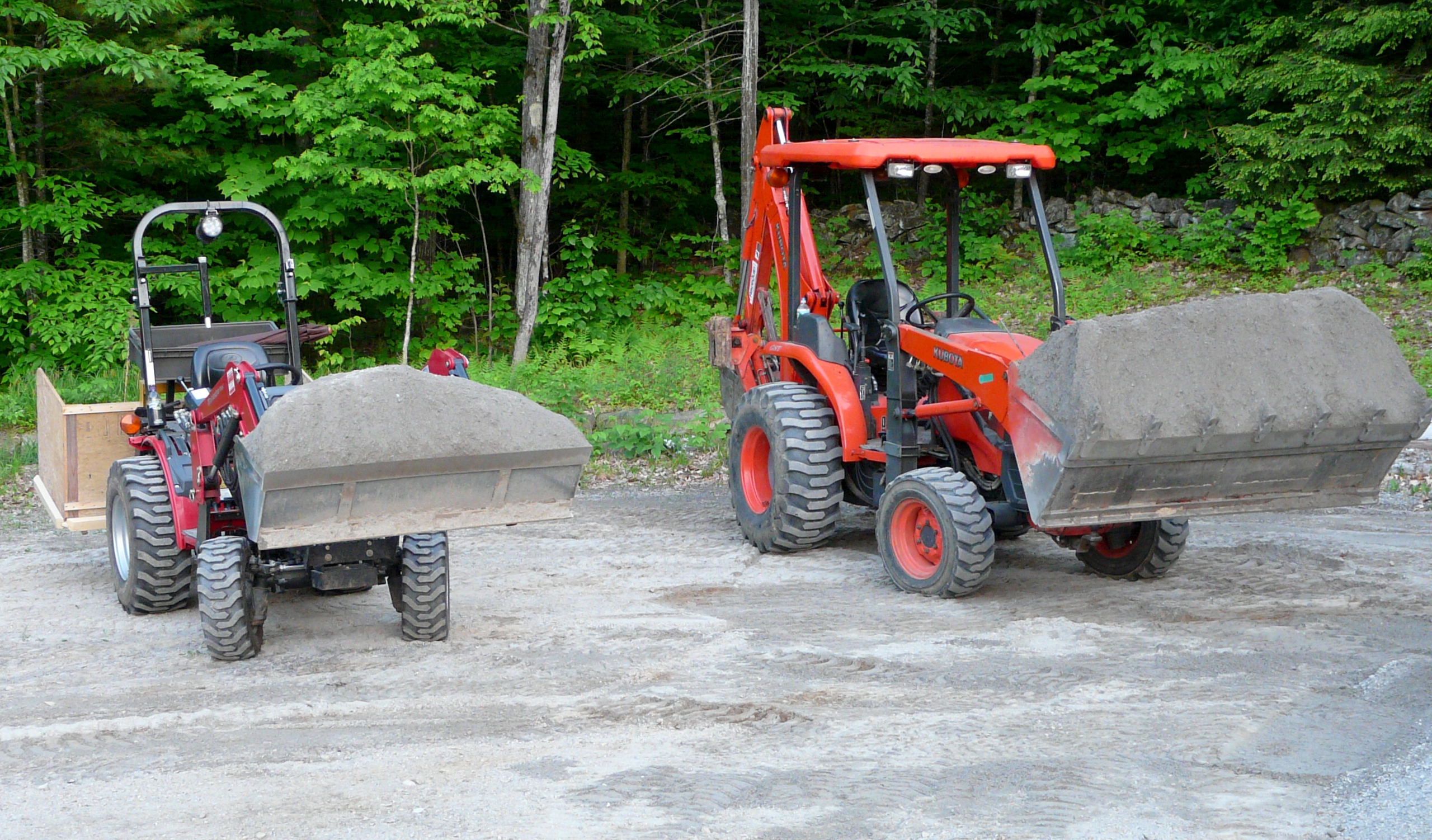

Have wheel weights so BH does not push machine around as much and the rear tires stay planted, at least on level ground. I recommend more weight.
Two problem with chains is you need special chains or double chains to give a reasonably smooth ride and they track the mud all around.
R4's stink in slop, but the BH can usually extricate itself from all but the worst situations. Only once did my wife have to keep me from sliding over a 20' embankment with our excavator.

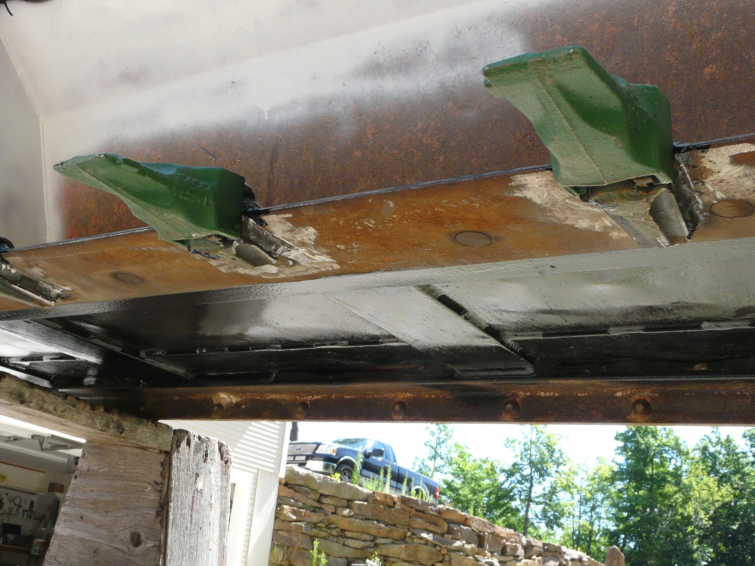

ESCO Bucket teeth are way better than any bolt on cutting edge. Weld a 2" x 2" piece of angle to back of bucket edge for back dragging.

Not in my opinion, just use your head and for sure, flip it out of fwd on firmer (traction) surfaces. If you have a hard push and the tractor is really "hooking up'' to the ground is when I might be concerned about chains on the front. Just wheeling around in the slop & mud I wouldn't worry at all.
I remove my chains after snow season. Regardless with my machine ballasted at least an extra 1,000 lbs and with the relatively weak L series front axle of my L39 on high traction surfaces, I typically push into and pull out a full load from a pile in 2WD.
M59 front axle is much stouter, I would not worry.
   / New to me Kubota M59 #23
When we bought our M59, I had a lot of experience with compact and sub-compact tractors so I knew just what kind of chains I wanted & ordered up a custom set for the front on the M59.
What I didn't realize was that traction is all about weight per square inch of tire surface. If I had more experience, I would have realized that what that means is that for a lighter tractor chains are real necessary and you can use them without much worry of hurting the tractor. But when a tractor gets to a certain size and weight, the need for chains goes way down while the danger of overloading the drive train because of the traction that chains provide goes way up. There are times when a tractor needs to spin a tire to protect the drive train.
At almost 1000 hrs now I've never had a reason to run chains on the M59. We have real snow here in the mountains at 7000 feet but no mud. With all that weight, gear selection, diff lock, and 4wd, so far the M59 has plenty of traction in the snow without chains at all. Well shucks.....OK, maybe the chains will be useful when the tires wear down to smoothies, but I could just as easily buy new tires when that happens.
After using chains on compact tractor since the 1980s, our beautiful custom-designed, cross-linked, extra-plated, & expensive! M59 front chains haven't moved from their peg in the barn. Sure look nice hanging there, though.
