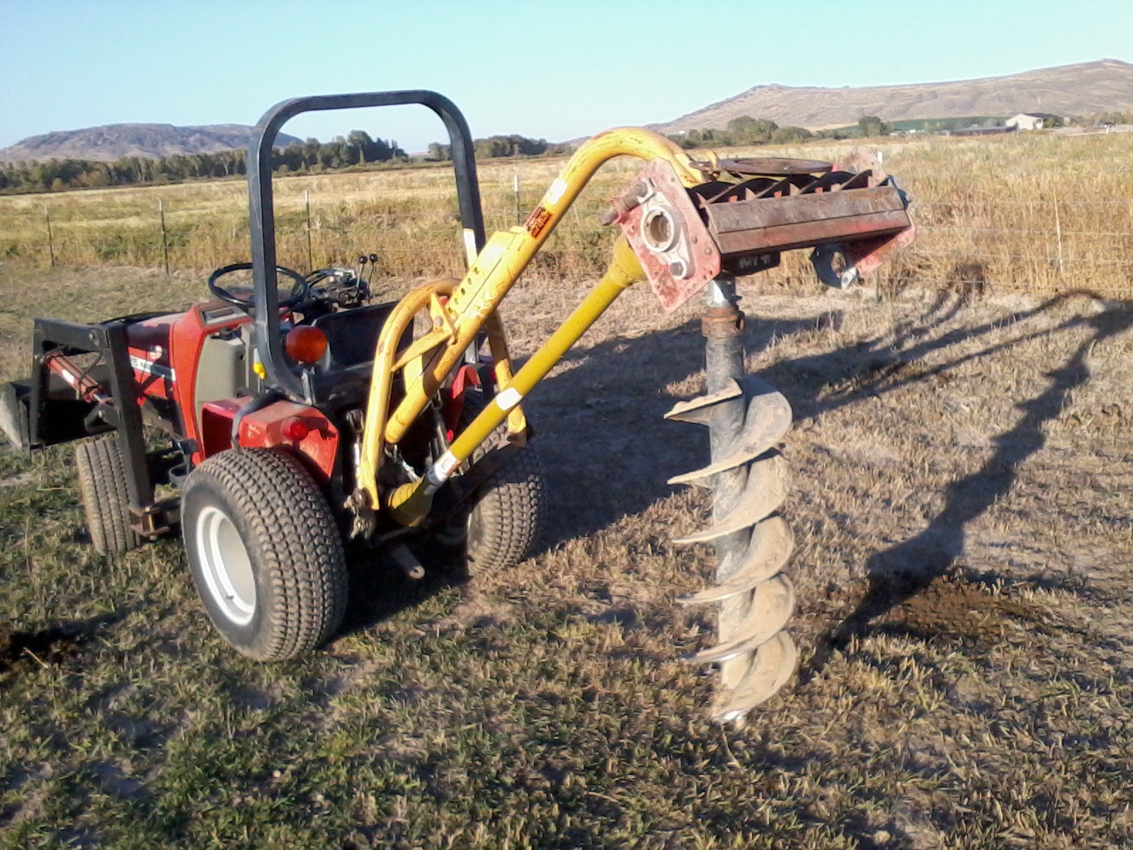

This is an update that I got the digger running. I had to replace the teeth too. I also figured out what that hook on the back is for. It's for hanging weight. I welded a horseshoe to a 75 lb. chunk of scrap and hung it off the back. That made a big difference.
My first project is helping a buddy dig some holes for a pole barn. Tonight I dug until dusk. I may have dug longer, but I busted a shear bolt. Like and idiot I forgot to bring extras. Breaking the shear bolt was actually a huge relief. I was a little worried that my bushing setup would smear the bolt rather than shear as was suggested.

I didn't get photos, but I can try tonight when I go to finish the job. It's a comical sight. I have an old brake disc and a reel section from a reel mower hanging by horseshoes off the back of my post hole digger. I'll call it proof of concept. Since the weight seems to make a big difference, I'll be on the lookout for a less redneck looking weight option.

Here's the picture of my weight. Imagine how much that weight must have cost when it was new. I also included a picture of the first hole I dug tonight. This is the hole that busted my sheer pin last night. I was impressed, though. Once I got the new sheer pin in it dug right down even with all those rocks. This was probably the worst hole for gravel, but there were still some good sized rocks in the other holes.
Another thing I learned tonight... I moved the bottom of my 3 point linkages out to the hole on the lift arms that is furthest away from the tractor. This gave me more leverage to lift the digger back up out of the hole. I got it stuck a few times last night. Not so tonight.

Sorry you can't seen the horseshoe very well in the picture. The two sides of the open end of the horseshoe are welded to the mower reel section as if to make a loop. The horseshoe loop is then hung over the hook.
It's only in the way insomuch as is causes the auger to tilt slightly more toward the tractor. I just drive forward a hair after putting the auger tip on the ground before engaging the PTO.

It's been good so far. I've dug about 50 holes with it total since I got it put together and working. The ground needs to be pretty soft before it will start to bite. Down pressure would help that.
My only concern with it is if I have to ever get parts. Getting the PTO shaft was enough of a challenge. I'm worried that a new gear box or some such would be even more difficult.
