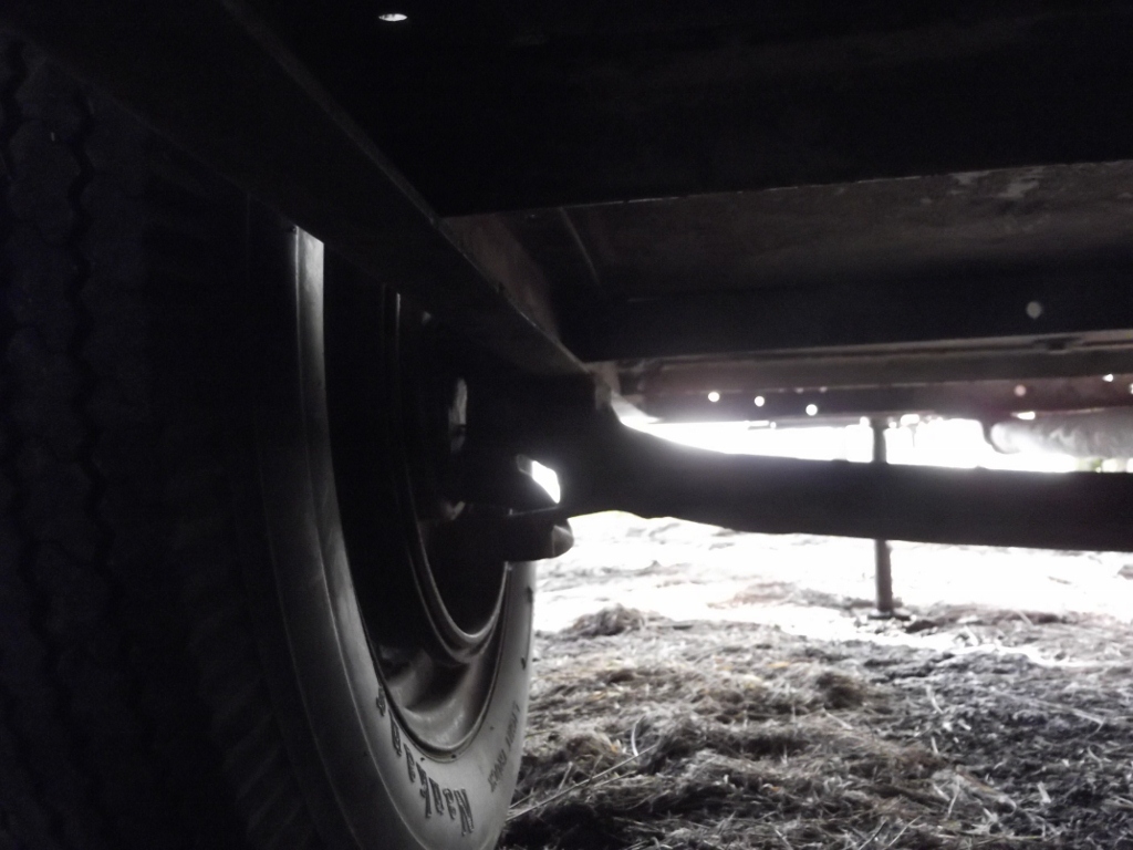

[axle] looks like its welded solid from on top?
This was a farm welded project (looks like it anyway) its not terrible bad but its crude and functional like it needs to be and not pretty. :laughing:

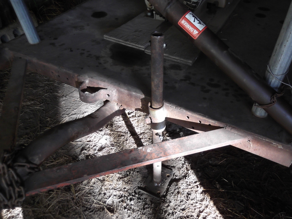

I dont know what the welded on elbow on the corner etc is anybody's guess there haha. This thing could have come out of the oil field originally for all I know that could have been for a vice stand etc but the piece of pipe on the left side of the tongue was their attempt at a tongue stand.
It had a nut welded on (1/2 broken loose now) that had (I assume) a bolt to be tightened on a shaft with a pad welded on the bottom for a foot. Its laying on the front there, just a solid shaft with a piece of a blade of some kind welded as a pad I didn't reuse it. :confused2:
I built a simple pipe with a foot and put it in there with a long bolt and nut and a couple extra holes to hold it up out of the way so I dont need any wrenches to use the tongue stand doing it my way now.

Thanks for the ideas! Here is a pic of my super simple tongue stand there is a hole down low under the cross brace that the bolt goes in once the tractor has the weight off that keeps the stand off the ground and I dont have to man handle it.
Now with that said the fact the stand is up in the arc of the drive shaft on turns as long as its attached I do need to be mindful of it being up on that one side when turning left no biggie though for now.
(there is a pic of how the axle is welded to the frame also its not going to be impossible to relocate it just have to flip the whole trailer over on its back if I decide to spend the time we will see about that...)
A swing away jack would be real nice and I will probably do it later even thought about going to town for one this time but with the amount of time I allowed myself I went the short cut route. :D
