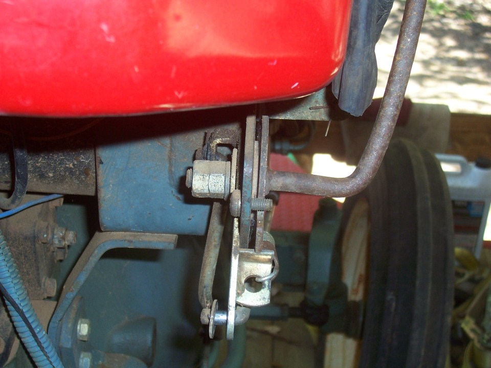

So the speed control assembly on mine looks different than what you have. Mine looks like this. If I can't find an appropriate spring then I guess I will bite the bullet and overpay for a single spring. If anyone happens to have their spring out and can take some pictures and measurements that would be awesome as well since they are apparently becoming rare and would be good to have another source when someone is looking to find it.
   / New to me YM2500 #77
I do have the hole just below the #7 Nothing to attach a Spring or a Chk. Ball to the handle side. Maybe something with a JD. 240 or a Prod. of a later model. My YM2000 was so Org. They may have removed it. Which could be true since the paper thin PD. disintegrated and The mounting stud easily Broke. That could be very true getting all they could out of it. It looked as though it just rolled off a boat!! Which was a big plus knowing it was Org intact.

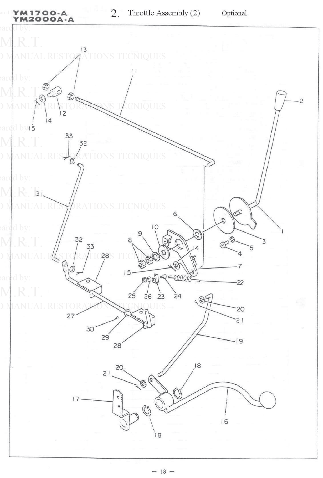

Not sure if your machine is a Tree Frog or a Red Apple.
The Tree Frog setup YM2000
The Red Apple setup YM2000
