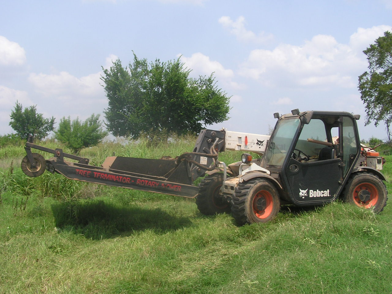

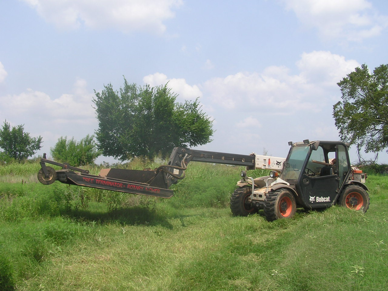

I think you hit the nail right on the head. I probably don't need a high horsepower tractor, but just a heavier framed. My only real tractor experience is from bigger tractors from the 70's. HP equals size. Lol. I also like the idea of naturally aspirated if I can get away with it. I definitely love a turbo diesel in a truck, but some are also known to be unreliable. I also don't need a lot My land is separated and the biggest parcel is about 34 acres with half being woods. I don't necessarily need a 12ft mower. I was thinking an 8ft would be fine.

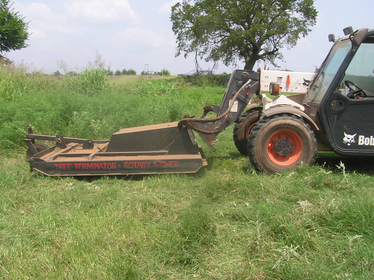

My out front 7ft mower is faster overall and more maneuverable than an 8ft on the back of a tractor:
Sold my tractor soon after I bought my first compact telehandler. Click to see what it can do: Compact telehandler
