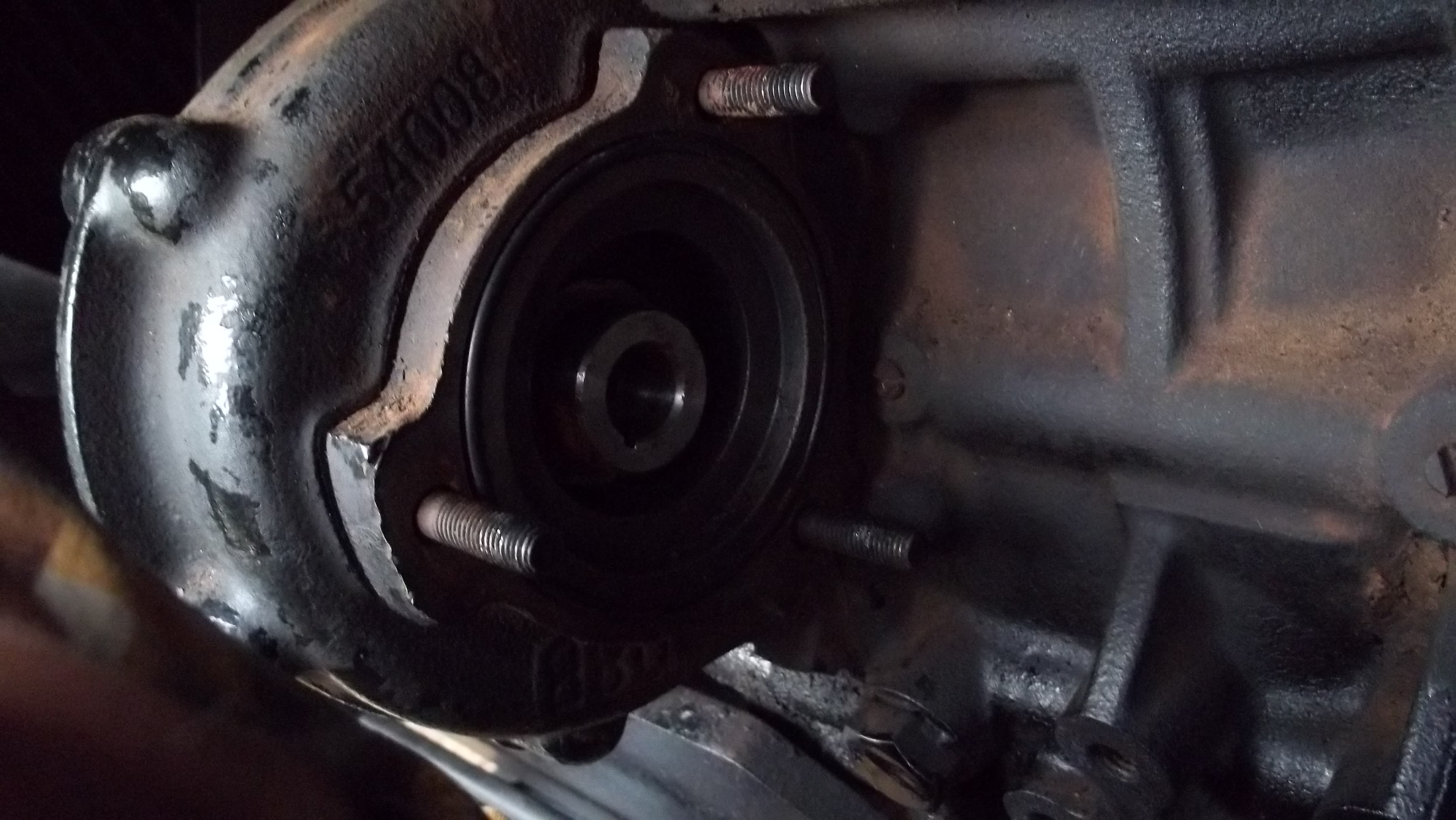

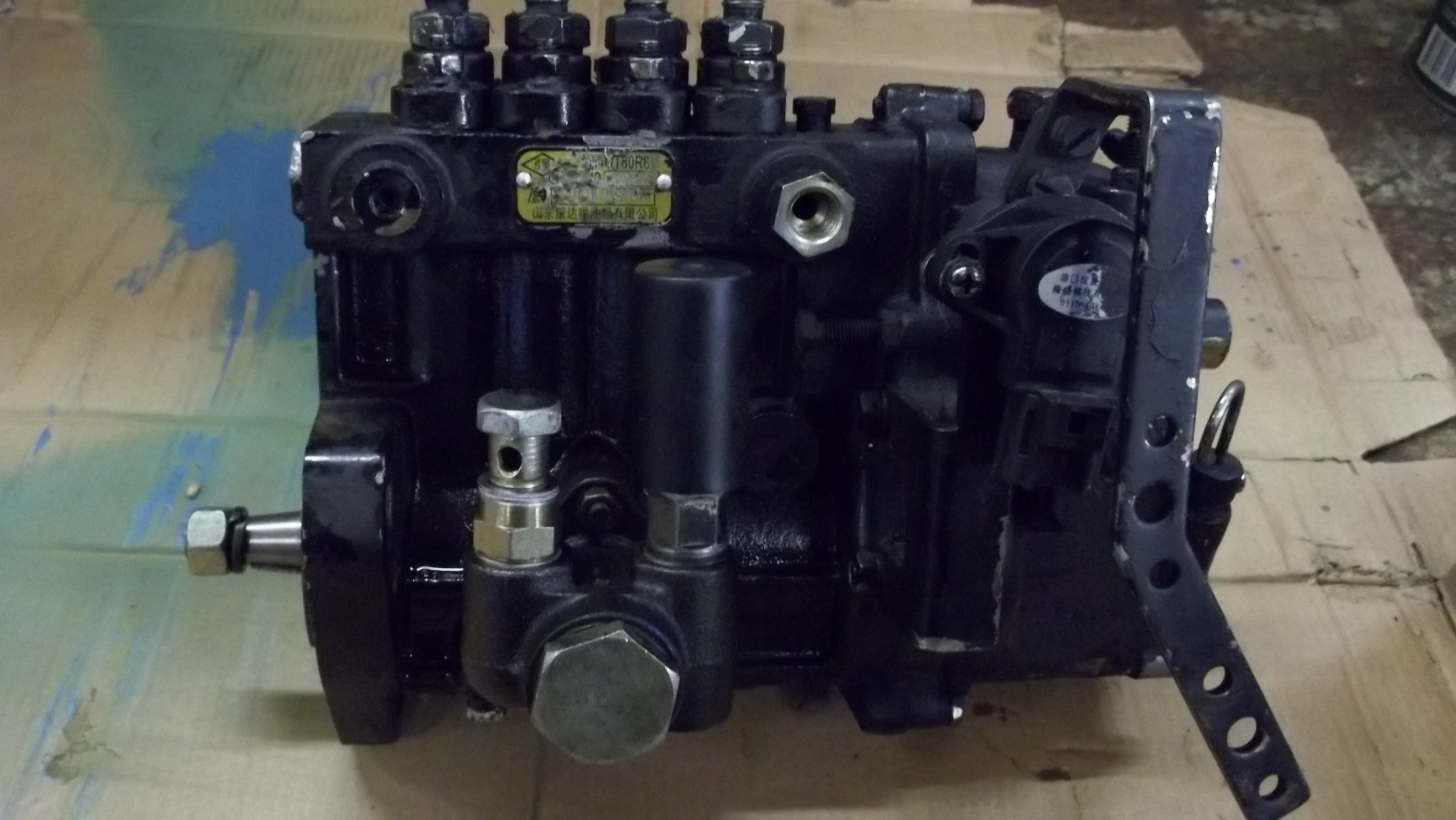

Here are some pics, black one is the old one.
