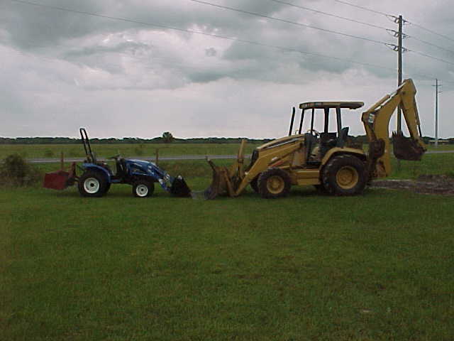

I think you're heading in the right direction. Without regard for what tractor you end up buying, I'd rather look at what you're going to do. First of all, I think your estimate of hours is off a little. Unless you get a monster loader/backhoe, any tractor that makes sense under your budget and land size is going to need a liitle longer to get the work done. Understand, it ill be 20 to 50 times faster than doing the work by hand, but you'll have to do a lot of teasing and coaxing rather than brute force working. You might spend 3 hours getting out one 12" stump if it's stubborn, and I think you picture more than 1 to 3 stumps per month. Figure 3 to 10 hours per week, and you might be closer. Also, once you have it, you'll find a lot more things it can do.
Second, wives always suggest rental, because they never think of the hassle, time lost, transportation, etc. involved vs. having the tool at hand. But the most important ting is, if you have the thing for only one 12 hour day at a time, it becomes work to maximize your rental time regardless of how you feel, what the weather is, etc. etc., instead of the fun a tractor should be in getting the job done. Wives will never understand this until they experience it once or twice with the inevitable problems that arise that waste half of the rental time.
As soon as I read "digging holes" and "12" stumps", I said to myself, "backhoe". You mentioned spreading dirt and moving trees, and I said "loader". You mentioned spreading dirt and leveling, so I said "boxblade". I also thought "landscape rake" and possibly "rear blade" (I don't have a rear blade, yet, so I'm not as sure about that). You didn't mention fencing, so I didn't thnk "auger" until I saw you mentioned it. You mentioned small brush, and I thought "brush hog".
So, lets back into the tractor. The most expensive attachment will be the backhoe, next will be the loader. Others can (and will) jump in with different or more accurate numbers, but figure $5K to $6K for the backhoe, $2K to $3K for the loader, and maybe $2K total for the other attachments. Using the maximums, that leaves you about $13K for the tractor. Will you need something to carry it, or are you going to be able to leave it at one property and get it back and forth to the other? If you're thinking about side jobs, getting to service, etc. do you need or do you already have a trailer and suitable tow vehicle? If so, that's going to have to come into your budget and cut into your tractor.
But, assuming you already have a trailer, that $13K is probably more than enough to get into the New Holland TC33D. If you need the trailer, or just want to pocket the difference, or put it into other tools, look at the TC30 with hydro. Both are bigger than my TC18, but I'm not sure I'd want a backhoe on my little machine. I'm not stuck on New Holland; it's just that I don't know anything about the others.
Your alternative, which is what I did, is to forgoe the backhoe, get a smaller machine, and use the difference to hire in a serious machine to quickly do the hardest work. In fact, if your estimate of 3 to 10 hours per month is anywhere close, and if there is any doubt about how useful the tractor will be when your specific tasks are complete, then I'm going to commit heresy on TBN and recommend your hire it all done, man and machine, and get it done in a week, for about $4,000. This based on your maximum estimate of renting one 10 times and using it 10 hours, or 100 hours total. A serious machine can do all that in 5, 8 hour days at probably $65 to $85 an hour. My $4K estimate allows a little slack. I paid $65/hour for a Cat 416C loader/backhoe and operator than can dig up a 12" stump in probably 30 seconds; even with a backhoe, a compact tractor might fool around for much longer. Attached is a picture of the "buddies" while they took a break to show the difference.
Like I said above, I think the best combo is to hire the serious work done and still get a smaller tractor to do the rest and continue with all the chores you will discover once you have it. I paid about $15K for my tractor, loader and implements, and about $3K for the work by the "big guy" comparable to yours.
Oh, as for what brand? Buy the dealer first, and if he sells two, buy the one he isn't pushing just to spite him. I don't trust it when they push something.
{Edit} As if this isn't long enough, I thought of something I want to add. If you're going to rent, rent a serious machine like the Cat. NationRents quoted me $425/day plus delivery and pickup for a similar size machine. Of course, my figure of $650/10 hour day for operator and machine, with no delivery/pickup charges, was better than that considering how much faster the operator is than us, but manned machines might be more expensive in Houston.
