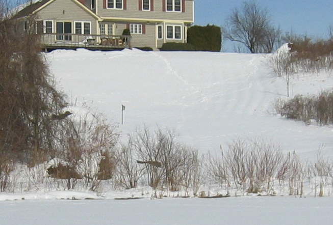

Jim, the pics of the property helped alot with picturing what the various slopes might look like.
Iwish I could post larger pics. It is really hard to show the actual grade. I am attaching a cropped pick of the grass behind the house, unfortunately taken in the winter.
I'll try and measure the slope, but its changes over the course of the hill due to the terrain.

I am also a bit worried about the lack of brakes. What do you do when you need to stop quickly? Do you hit the reverse pedal and spin'em backwards for a second?

You raised two issues:
Pressurized oil systems: So far as I know the engines PT uses have pressurized oil systems. The issue is that if the engine is operated on a sufficient slope then the intake for the oil system may be uncovered and there will be no oil available. The Deutz diesel engines have oil sumps that are designed to operate at a greater angle than the Robin gas engines. The potential of tilting a tractor sufficiently that the oil suction is uncovered applies to all tractors including the brand you cited.
Brakes: So long as the engine is running and the hydraulic system is intact all of the PT tractors have effective "brakes" i.e. the hydrostat system very effectively functions both as a drive system and a brake system. The issue arises to a small degree if the engine is not running but even with the engine not running the hydrostat is pretty effective because the wheel motors are "locked". However, if there is an opening in the hydrostat system --a burst hose, a torn hose, or a broken fitting then the wheel motors provide almost no resistance and the operator has no way to control the tractor. The larger units have braking systems which function even when there is no hydrostat pressure.

<font color="blue">What do you do when you need to stop quickly? </font>
As soon as you take your foot off either the forward or reverse pedal, the tractor stops by itself almost instantly. It has enough force to be make you fly forward in the seat, so use your seatbelt. Brakes are not needed.
