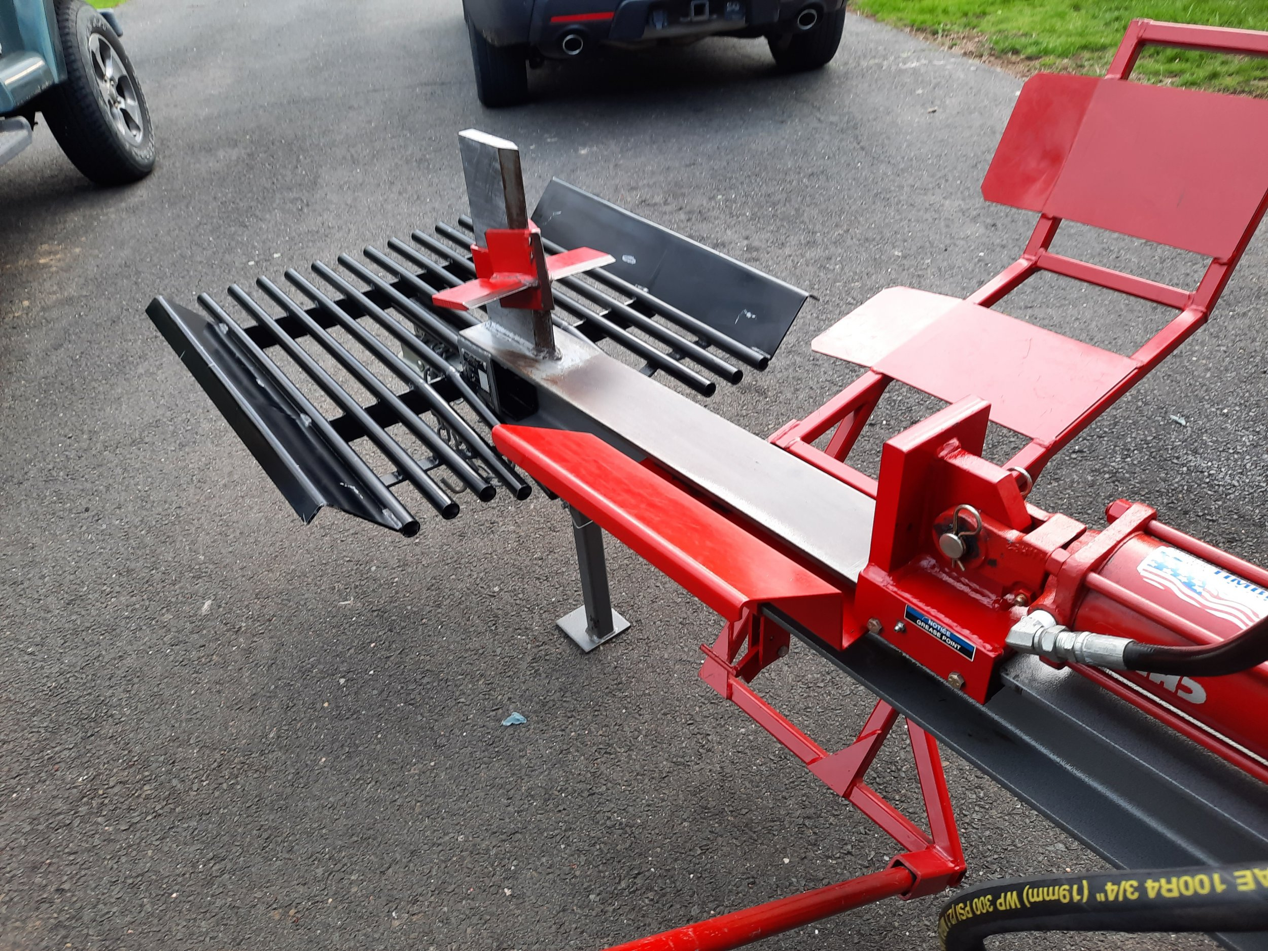

@Oaktree - Cycle time refers to the time it takes for the splitter to complete a full cycle, all the way out & then all the way back. As @ericm979 mentioned it is determined by cylinder & bore size & the pump output. The Timber Wolf has a more than expectable cycle time for our use (3-4 cords a yr), but if I was purchasing something new I would have looked for a little faster.... The splitter we purchased is close to $ 3900 new & we purchased this one for under 2K... so I think we did ok... (& it's Timer Wolf quality)
The 4-way wedge was a definite want for us... & the Timber Wolf's slip-on 4-way is reversible, each way gives you a different split size. It slips on & off in seconds to allow you to spilt using the single wedge for larger pieces or the 4-way.

@Oaktree - If you look at the attached pic you will see what I mean... The 4-way just slips on to the regular single wedge. If you look closer you will see both sides are different heights, so you flip it one way for one size... flip it & it is a different size... It really is a great feature...
That is one fancy splitter!! (y)
Don't think I've ever seen that wedge arrangement before.

I think it is a Timber Wolf thing... but it is a nice feature...
I grabbed some parts to start mocking up the receiver hitch for the rear... Not sure I'm sold on the layout that is in my head.... hopefully will have time this weekend to do a mock-up...
Still working on the height issue...
