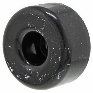

Oh, oh, oh, I bet the seat rides hard. In the image the seat jounce bumpers are missing. It makes for a really hard ride.
They look sort of like this. They are held down by those threads and large nuts under the seat. See the parts manual. ;)

Thanks a bunch! Yes the seat bumpers are missing so we'll order some and check into some fenders too. Much appreciated!!

You could order some or pick them up at ACE hardware or in the hardware section of Home Depot. Hillman brand makes several of our sizes.
McMaster has them too. Make sure they are Metric, Neoprene and Shore-70 hardness.

PVC. Freese plugs. been on 14Yrs.. Soften the ride no doubt and Cheap!!! Head and neck injury's.

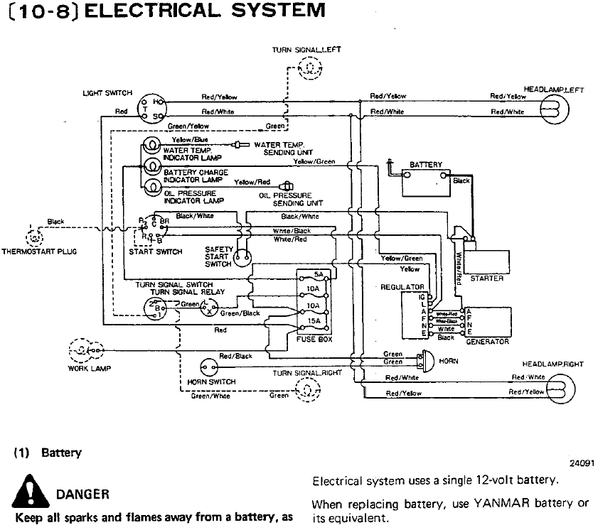

For a tractor that rough I wouldn't worry about the electrics. There's really not much there. A charging circuit and the starter. A diesel doesn't run on electricity after the starter gets it going.
yam240elec-gif.59885
